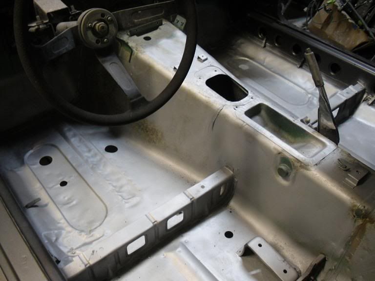

piston Posted November 22, 2009 Share Posted November 22, 2009 ey, whats up, im from sacramento also and you can find dry ice at savemart on fulton and marconi. lol. but yea, i would not use it if i was you. i tried it 4 weeks ago and it takes longer than you would think. you would have to leave it on there and work sections at a time only because it will only cover so much 1x1 square. i used a nice machanix glove with cushion to protect my palm and chisel/hammer/screwdriver away. way faster than waiting for the ice to kick in. i used a pudding knife to scrap/knock extra tiny pieces off because it covers more ground with one sweep. as crappy as it looks, it same out alright with just one coat of rustbullet spray. Quote Link to comment Share on other sites More sharing options...
datsun723 Posted November 22, 2009 Share Posted November 22, 2009 ^looks good. Mine is actually just coming off by hand in some places. Woot! I'll post some pictures when I'm done. Quote Link to comment Share on other sites More sharing options...
shika805 Posted November 22, 2009 Share Posted November 22, 2009 mine what all brittle and came off by hand... i have linex as a new sealent, sound deadening and coat on the floor of my car. Quote Link to comment Share on other sites More sharing options...
cd1105 Posted November 22, 2009 Share Posted November 22, 2009 ^looks good. Mine is actually just coming off by hand in some places. Woot! I'll post some pictures when I'm done. same for me with the hatch. I used dry ice on the floor pans, but the hatch deadening came up in huge chunks. Quote Link to comment Share on other sites More sharing options...
