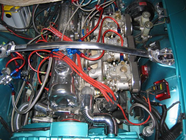

PalmettoZ Posted December 18, 2009 Share Posted December 18, 2009 I have searched and searched but I can't find any "successful" swaps with a northstar engine. The only problem (other than cost) that I can find is the transverse mounting. Since 04 the lh2(325h.p.vvt) and in 06 the lc3 (469h.p. supercharged) have been longetudinal with 6 speed trans. Are they too wide? Hard to mount? I really want one of these in my 240. This is my first post but I have been building my Z since the 80's. I am finally going v8. Your second photo has a Z motor with triples and a really nice nitrous set-up. Is that yours? Has it been on a dyno and if so what did it put out? Looks like a serious engine setup. Quote Link to comment Share on other sites More sharing options...
MAG58 Posted December 18, 2009 Share Posted December 18, 2009 The Northstar wasn't exactly designed to be an easily rebuldable motor, like blackice said, the block (in many cases) requires time-certs for the head bolts and the block is a die-cast open block design. Good for temperature control and cost effectiveness (uses less material than sand cast) but not so great for big power numbers. Who knows though? Quote Link to comment Share on other sites More sharing options...
snell1884 Posted December 18, 2009 Author Share Posted December 18, 2009 Your second photo has a Z motor with triples and a really nice nitrous set-up. Is that yours? Has it been on a dyno and if so what did it put out? Looks like a serious engine setup. PalmettoZ, It is mine...L24,290/490 Isky cam, Weber 40DCOE Triples, 110 shot sportsman fogger(direct port wet system). T5 with 4:11 diff. I don't know what the numbers would be but it's not enough. The Northstar wasn't exactly designed to be an easily rebuldable motor, like blackice said, the block (in many cases) requires time-certs for the head bolts and the block is a die-cast open block design. Good for temperature control and cost effectiveness (uses less material than sand cast) but not so great for big power numbers. Who knows though? MAG58, 469 h.p.@6400rpm 439lb.ft.@4400 in stock form. How much power can you REALLY use with these light cars? I did see an upgrade that nets over 600 h.p.http://http://www.d3cadillac.com/vehicles-XLR-and-XLRV.php Quote Link to comment Share on other sites More sharing options...
