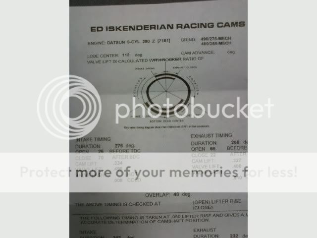

That is only ONE 'turbo' Isky grind. It is not the 'only' one. You need to call, talk to Ron, tell him what you want, and you will get a cam ground to YOUR specifications and intended usage.
I suggested long ago that JeffP call and talk to Ron, and NOT tell Ron what he thought about overlap, duration, lift, etc....but to just tell him what he wanted performance-wise, and see what Ron came up with. Jeff was a bit upset when Ron mentioned given his specs on the engine that he 'was down a bit on power' (which was around 500 crankshaft HP at the time...)
Jeff P thought that a bit arrogant. Until he ran it on the dyno and made 650+RWHP with the same components, save the cam change...
What one person gets from Isky will not necessarily be what someone else gets. For the same price as the others, you can get a specifically engineered camshaft solution for YOUR particular application with a specific lift, duration, split duration, and lobe center. To me it's a no-brainer...
Edited by Tony D
Talking to Ron is by far the best thing to do. I told him what I was looking for, and it turned out the one they have a master for just so happened to be good enough for me. But I will deffinately post befor and after dyno results of just the cam change. I just got the cam in today, BTW.
