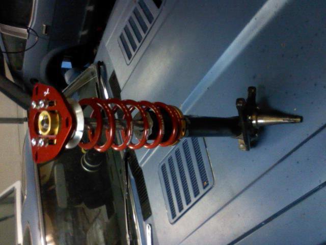

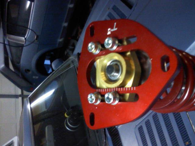

bluezx Posted March 24, 2010 Share Posted March 24, 2010 These are T-3 camber plates and ground control coil-over sleeves from Techno Toy Tuning I'm fitting to 84 Z31 spindle assemblies. Got some Z32 calipers to go with them too! Anyone got any pics of camber plates installed on S130's? I'm waiting on a Cusco strut bar before cutting out the top of the strut towers and would like to see what others have done. Lots of S30 pics, not much S130 stuff posted yet. Quote Link to comment Share on other sites More sharing options...

bluezx Posted March 24, 2010 Author Share Posted March 24, 2010 Yeah, my control arms are gonna need some surgery. I was looking at doing hemi joints any way so that should fix that. I really wanted 4-piston calipers up front and this seemed like the best way to get them. The camber plates are for fine tunning to get it dialed in. Frank, did you have to "stretch" the tierods also to acomplish this mod? I've been considering rod end conversions and bumpsteer spacers to complete this set up. I'ts definitly a domino effect once you start changing one thing... Pure Pontiackid, I think both my cars are the same blue originaly just in different sunfaded conditions now.lol Quote Link to comment Share on other sites More sharing options...

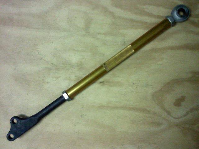

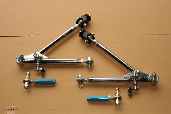

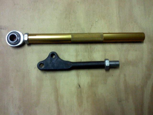

bluezx Posted March 26, 2010 Author Share Posted March 26, 2010 Frank, thanks for the info about the tie rods. Looks like I've got all the parts I need to put this together now except bump steer correction. I saw this on the rare and interersting parts thread and thought this would be a great way to lengthen the control arms. I wonder what ball joints they used to make those. Seems like a pretty striaght forward control arm design. I could copy that in mild steel and have them powdercoated. I would still be able to use the t.c. rods I already made too; Quote Link to comment Share on other sites More sharing options...

frank280zx Posted March 26, 2010 Share Posted March 26, 2010 Frank, thanks for the info about the tie rods. Looks like I've got all the parts I need to put this together now except bump steer correction. I saw this on the rare and interersting parts thread and thought this would be a great way to lengthen the control arms. I wonder what ball joints they used to make those. Seems like a pretty striaght forward control arm design. I could copy that in mild steel and have them powdercoated. I would still be able to use the t.c. rods I already made too; they look like a uneversal type ball joints.. Join up in the supensiontech post a couple of post down. it might help concentrate de s130 options Quote Link to comment Share on other sites More sharing options...
