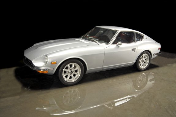

Well, I owe you all an update. I'm toward the end of break-in. Lot's of time was spent getting the inside fender/firewall welded up correctly and I also had some problems with the cam (not my fault or cost), so another had to be reground, along with lash pads. I end up with 10.3:1 compression (no detonation detected on 93 octane) with stock EFI so far, Stage 2 cam w/triple ground valves and Isky springs, 6-3-2 header, 2.5" exhaust. Man does she run now!
It was already lowered with Eibach progressive springs and KYB struts, and has Brembo rotors/Toyota calipers w/ceramic pads. Interior is done stock except steering wheel and stereo.
I did replace the headlight long ago, but now the other has a rock ding. Next will be some sheet metal work done on the floorpans, though it's been fiberglassed and is dry for the time being. Front airdam and rear spoiler needed. And I've got to get rid of those bumpers!
