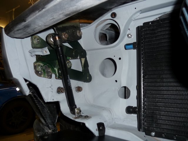

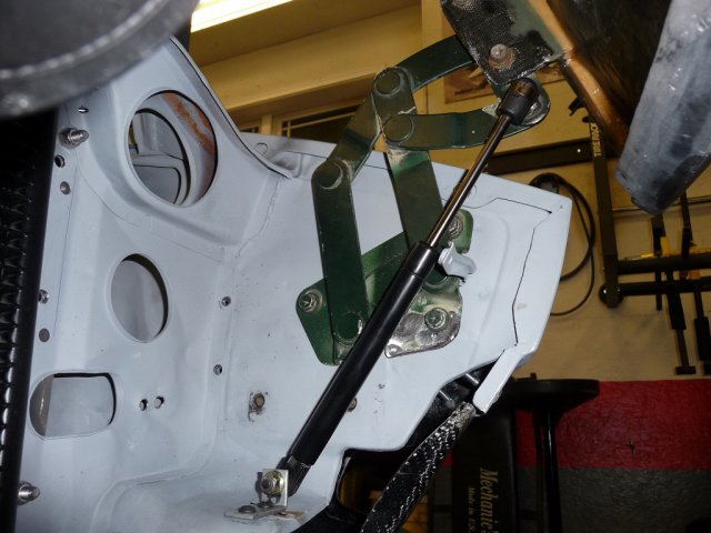

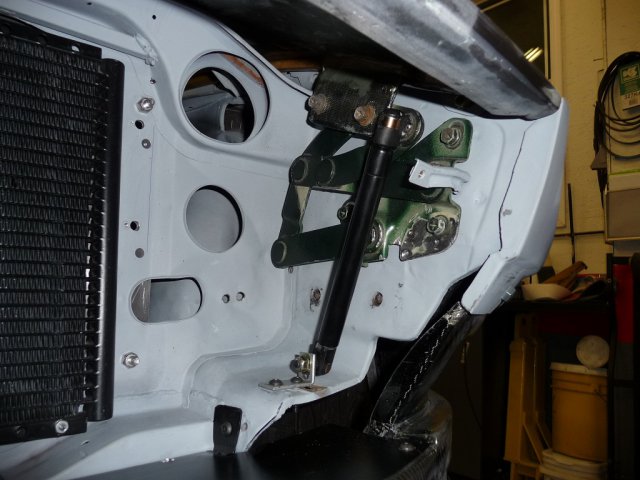

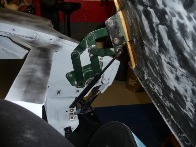

Litman Posted April 1, 2014 Share Posted April 1, 2014 Josey, I had no idea a kit like this existed. I made my own that is shockingly similar, simply because I had the shocks left over from my G35. They are lightweight because I have a fiberglass hood but I could at least give you the compressed and extended lengths and you could experiment with load rating. To make these I pilfered four connection balls from VWs, cut two flush and welded them to the hinge and made L-brackets for the other two. I had to play around a lot with mounting location to get the distances correct for full compression and full extension. Works extrememly well with my hood. Model I used: Suspa C16-13313 Extended length: 13" Compressed length: 9" Quote Link to comment Share on other sites More sharing options...
