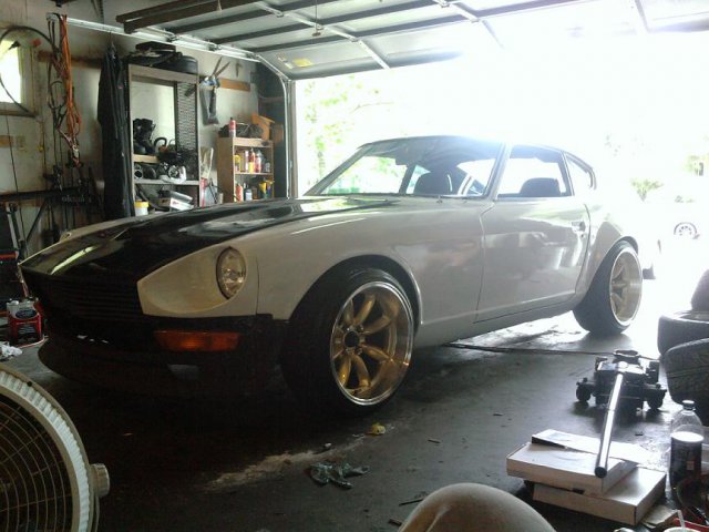

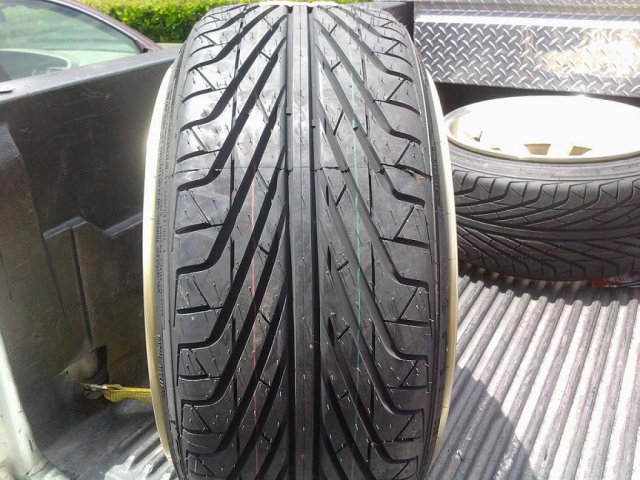

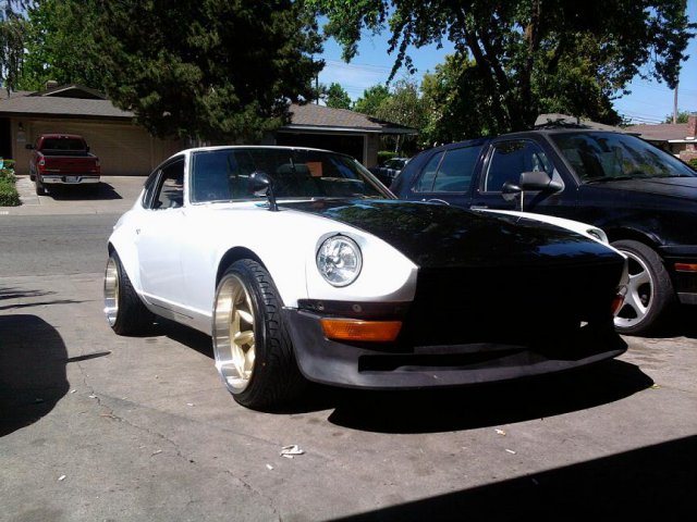

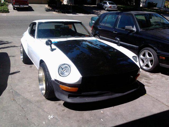

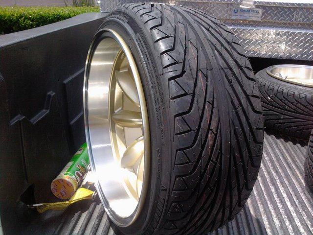

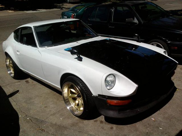

jrb1449 Posted June 5, 2010 Author Share Posted June 5, 2010 (edited) I have been to lazy to finish my paintjob. I did test fit the new wheels and tires as well as the mirrors. I need bigger spacers for the rear. Right now I have 25-30mm bolt on H&R's in the rear and could probably go another 25mm or so. The fronts have a 5-10mm (1/4") spacer. The rims are all four 17x9.5 -19's. The tires are 205/40 r17's. As for the gearing issue. I was thinking the 17's would be overall bigger that the 15's I had. I was wrong. They are only like maybe 1" bigger in diameter. It still screams down the freeway. I will just have to wait for a T-5 I gues cause it looks like the gears in the automatic 73 240 are the lowest available for the r180. I may also try to pick up an r200 if I can find one with long gears. like a 3.20 or something. I did also weld on a new Jones racing muffler with a straght through design yesterday and it is probably too loud now but sounds good. Edited June 5, 2010 by jrb1449 Quote Link to comment Share on other sites More sharing options...
mutt2jeff Posted June 6, 2010 Share Posted June 6, 2010 Would look pretty good without the ridiculous stretch. Quote Link to comment Share on other sites More sharing options...
jrb1449 Posted June 6, 2010 Author Share Posted June 6, 2010 Thanks for your input Jeff. I like the way stretched tires look. I also just got a set of street slicks for the track and ordered some Azenis for the front. Quote Link to comment Share on other sites More sharing options...
Leon Posted June 6, 2010 Share Posted June 6, 2010 (edited) Would look pretty good without the ridiculous stretch. Agreed. Looks ready to ride on some railways! I like the wheels but they really need wider tires. Edited June 6, 2010 by Leon Quote Link to comment Share on other sites More sharing options...
piston Posted June 6, 2010 Share Posted June 6, 2010 Wow, that is super stretched. Quote Link to comment Share on other sites More sharing options...
Cheesecakepiebar Posted June 6, 2010 Share Posted June 6, 2010 I'd be worried about those tires peeling off as you corner. It would be a shame to ruin the new wheels if the bead unseated. I'm sure that some 235's or 245's would fit much better. Quote Link to comment Share on other sites More sharing options...
palauoriginal Posted June 6, 2010 Share Posted June 6, 2010 yea. the 205 isn't a good look especially with those cool flares you have. Quote Link to comment Share on other sites More sharing options...
xxxpatsabxxx Posted June 7, 2010 Share Posted June 7, 2010 (edited) awesome car and rims... but the tires .... =| all that matters is that you like them ... we all have our desired look. btw where did u say u got those mirrors? Edited June 7, 2010 by xxxpatsabxxx Quote Link to comment Share on other sites More sharing options...
jrb1449 Posted June 7, 2010 Author Share Posted June 7, 2010 I got the mirrrors off ebay. They came from the Philipines. Quote Link to comment Share on other sites More sharing options...
xxxpatsabxxx Posted June 9, 2010 Share Posted June 9, 2010 I got the mirrrors off ebay. They came from the Philipines. u have a link to the seller or were they the only set? Quote Link to comment Share on other sites More sharing options...
ModernS30 Posted June 10, 2010 Share Posted June 10, 2010 I'd be worried about those tires peeling off as you corner. It would be a shame to ruin the new wheels if the bead unseated. I'm sure that some 235's or 245's would fit much better. Bead unseated? That bead has never been seated. Who put the tires on? I can't image a tire store would touch that. Quote Link to comment Share on other sites More sharing options...

gtted Posted June 15, 2010 Share Posted June 15, 2010 I have been to lazy to finish my paintjob. I did test fit the new wheels and tires as well as the mirrors. I need bigger spacers for the rear. Right now I have 25-30mm bolt on H&R's in the rear and could probably go another 25mm or so. The fronts have a 5-10mm (1/4") spacer. The rims are all four 17x9.5 -19's. The tires are 205/40 r17's. As for the gearing issue. I was thinking the 17's would be overall bigger that the 15's I had. I was wrong. They are only like maybe 1" bigger in diameter. It still screams down the freeway. I will just have to wait for a T-5 I gues cause it looks like the gears in the automatic 73 240 are the lowest available for the r180. I may also try to pick up an r200 if I can find one with long gears. like a 3.20 or something. I did also weld on a new Jones racing muffler with a straght through design yesterday and it is probably too loud now but sounds good. How is that tire holding air???? Quote Link to comment Share on other sites More sharing options...
jrb1449 Posted June 15, 2010 Author Share Posted June 15, 2010 How is that tire holding air???? HAHA... The bead is seated. The tire is stretched on. Its the same as the old 13x6.5 reverse wires lowriders have been rolling for years except with less fatty sidewalls. Its funny that everyone is amazed and is sooooo sure they will blowout! LOL. This isn't my first rodeo folks. Quote Link to comment Share on other sites More sharing options...
