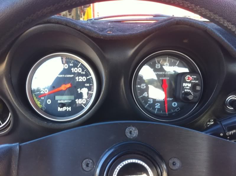

jakeoster Posted April 28, 2011 Author Share Posted April 28, 2011 (edited) Got my radiator mounted in today and got my Autometer speedo and tach in. It was a HUGE pain in the ass to get those wing nuts off that hold the stock gauges in! I'm sure this is a problem a lot of people run into and what I used was a 19mm 12pt socket and I cut a socket wrench in half to get them off. Hope that helps someone in the future. Edited April 28, 2011 by jakeoster Link to comment Share on other sites More sharing options...

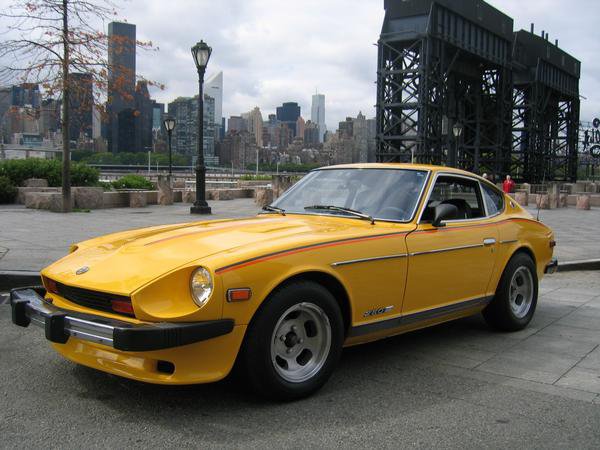

ZT-R Posted April 28, 2011 Share Posted April 28, 2011 do you have any pics of it on the 280z? Link to comment Share on other sites More sharing options...
jakeoster Posted April 29, 2011 Author Share Posted April 29, 2011 Bumper was removed but here's what it looked like; Link to comment Share on other sites More sharing options...
ZT-R Posted April 29, 2011 Share Posted April 29, 2011 damn thats huge Link to comment Share on other sites More sharing options...
