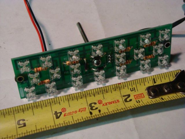

the basic led pc board front view

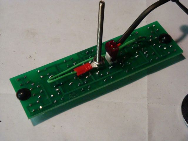

same board, other side, ground and lead wires attached. notice also how i kinked the green ground and the knot in the power lead

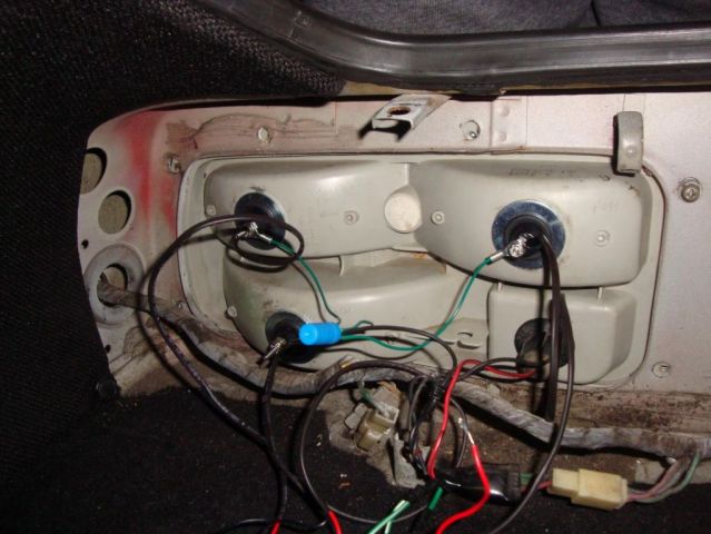

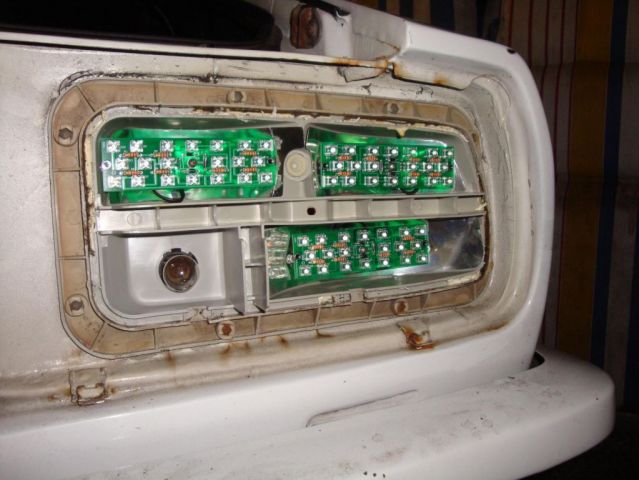

led boards mounted in housing, back side view
led boards mounted in housing, front view, no lens

LED wiring:
Red: high intensity (brake/turn light)
Black: low intensity (running/tail light)
Green: ground

• Remove license plate light, taillight exterior metal surround panels, interior plastic trim panel and tailights.
• Suggest you take a pic of where the plugs go and or create a wiring diagram to remember what goes where.

• Remove 3 nuts and rubber grommet from each LED circuit board, attach read plug to the lead to LED cb, install terminated geen ground wire [i kinked each one so they didn’t get pinched when installing the LED cb into the housing] to stud, secure with non-locking nut. I also “knotted†the LED lead [knot approximately same length as stud] so the lead would not pull away from the LED cb.
• Install the LED cb into the housing, slide the rubber grommet in place then nut, ground wire and nyloc. Rotate the grommet to achieve optimal position of the LED cb in the housing. Finger tighten the nut holding the grommet and tighten the nyloc to secure the ground. I found that by over tightening the nut it can render some of the led’s temporarily inoperative, if you find this, simply back off the nut
• Remember, LED cb wires; red is for brake, turns and hazards, black for parking/taillights, green is ground. You can use the provided cool wire nuts, your own or solder and heat shrink if desired. Initially suggest you just use what is provided until you determine how you’ll ‘arrange’ the lighting pattern
• You can arrange or design your tails the way you desire. Example-stock layout, all 3 brake or turn or whatever. Some think more is better, others want stock layout. It’s your z so whatever you want.
• Test, install lenses either by softening the old adhesive [heat gun or such] or remove completely and use silicone or other suitable.
• Install completed lights and trim panels
