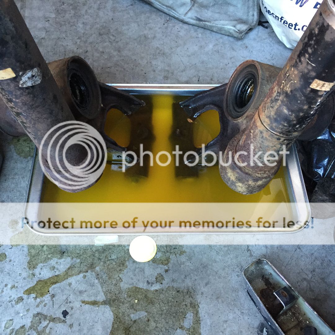

seattlejester Posted July 27, 2015 Author Share Posted July 27, 2015 Ugh, Spindle pins won't come out. Had them sit in evaporust to help loosen them up a bit/get rid of rust. Took it to a friends house, hooked up his compressor to my air hammer and went to town, no luck. He had some steel bar so I welded that to the pin and it just broke off several times. Kind of getting to the end of my game here. Where can I get these pressed out? Like what shop has access to presses? I have a few places I can call I don't recall many presses though. Not many machine shops in my area either, some precision fabricating shops, but no real big heavy duty shops. I have a muffler shop I visit I think I'll call to see if they know anyone, there are some performance car shops/garages that might know of a place. Input appreciated, local input would be fantastic. On other news, bearings ordered, seals are NLA from amazon, so I'll hit up the auto parts store for those. Ordering tubing and such hopefully this week. Coilovers will be ordered as well. Quote Link to comment Share on other sites More sharing options...
Pac_Man Posted July 28, 2015 Share Posted July 28, 2015 Asking around definitely can't hurt. I get flywheels resurfaced at Jay's Machine Shop in Everett and I needed my transmission mount modified. Talked to a guy there and he pointed me to some old hot rod guy who works out of his garage in the middle of the forest of northwest Marysville. Unfortunately I can't really make any recommendations myself. Only thing I can think of trying is to call Z Sport in Everett, ask for Chuck or Mike if he's not available- both have been working there for a long time and know Z cars pretty well. If they don't think they could do it for you then they could probably recommend what has worked in the past. Quote Link to comment Share on other sites More sharing options...
Jay Gadsby Posted July 28, 2015 Share Posted July 28, 2015 Are you trying to save the original pin? If I remember, you are wanting to do bolts and custom lca's. What I did was drill into end of the pin, big enough to put in either a large punch or another bolt and break out the 5 lbs sledge. It took some work, but she came out. Helped to hit from both ends to free it up. Quote Link to comment Share on other sites More sharing options...
88dangerdan Posted July 28, 2015 Share Posted July 28, 2015 I have this set That I started prepping for powder coat. If you would like to go this route maybe we could work something out. I did a quick guesstimate and it would cost about $30 to ship them. Just offering an option. Daniel Quote Link to comment Share on other sites More sharing options...
Eon Posted July 28, 2015 Share Posted July 28, 2015 (edited) I JUST finished going through this tiny slice of hell, after 2 days of soaking, air hammering, drilling, heating and cooling i had no luck NOTHING at all. what ended up working was a 20 ton HF press, a couple 1/2" grade 8 bolts and a mapp torch. Edited July 28, 2015 by Eon Quote Link to comment Share on other sites More sharing options...
seattlejester Posted July 28, 2015 Author Share Posted July 28, 2015 I'll give Z sport a ring if nothing local pans out. I have boog asking a race shop in monroe if they could handle it and I have a couple more local leads to chase down. I am not saving the original pin, the PO cut off the threaded portions so they could not be saved and as mentioned I will be going with a bolt so no need to save. That is a point, right now I don't have much purchase, if I drilled into it a bit I might get a bit better purchase to retry the air hammer or just use a big ass sledge to get the thing to start moving. Dan, PM'd Hmm I used my HF 12 ton press to no avail. Depending on the quotes I get/other random justification to upgrade, I may look into purchasing the 20 ton. Thanks guys, nice to know I'm not alone! Quote Link to comment Share on other sites More sharing options...

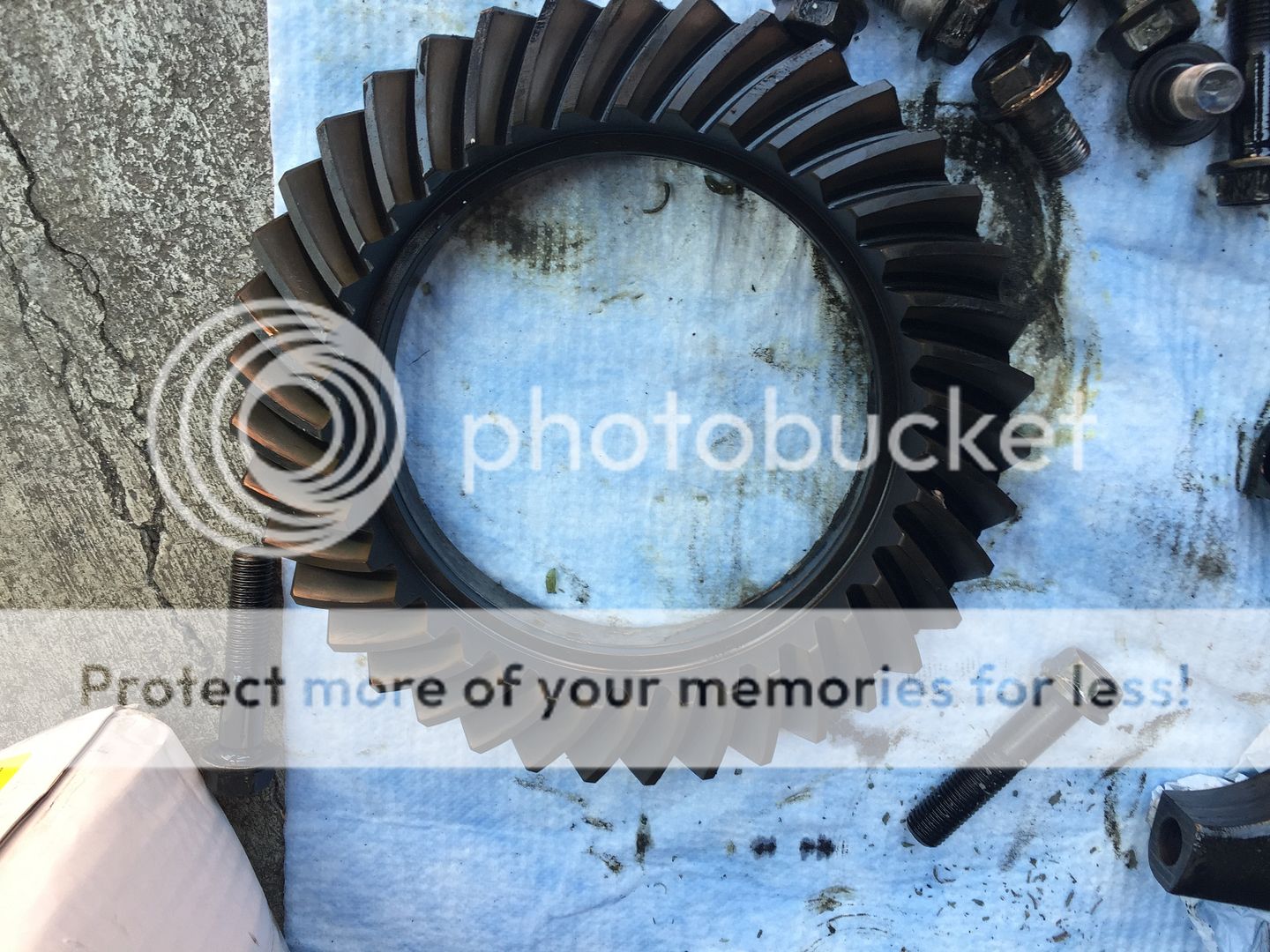

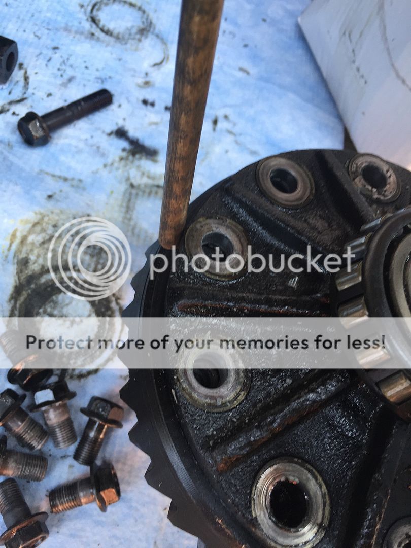

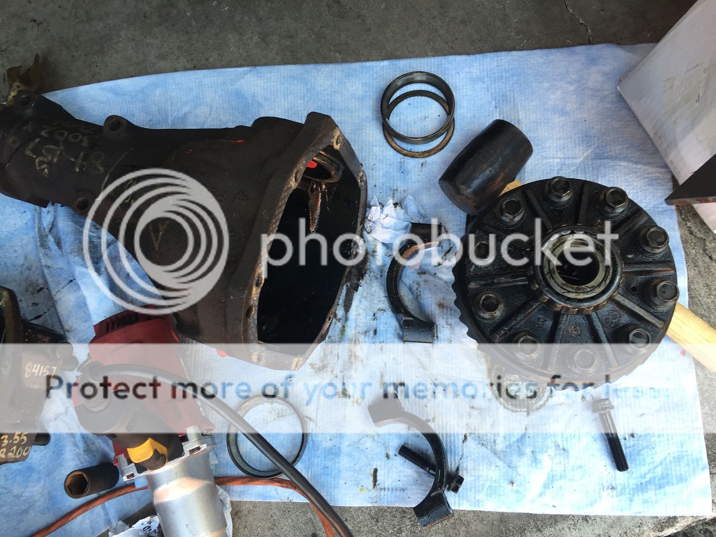

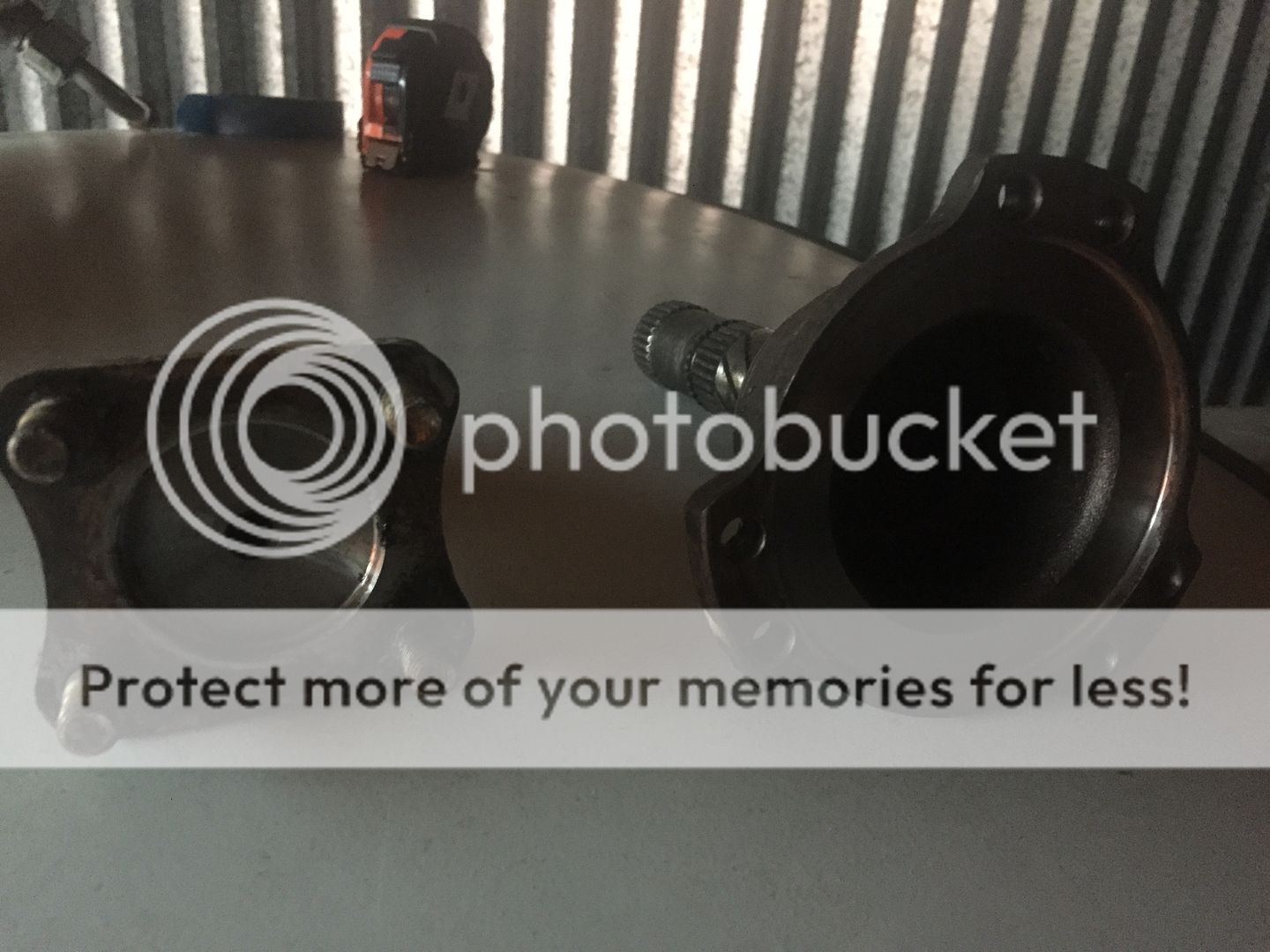

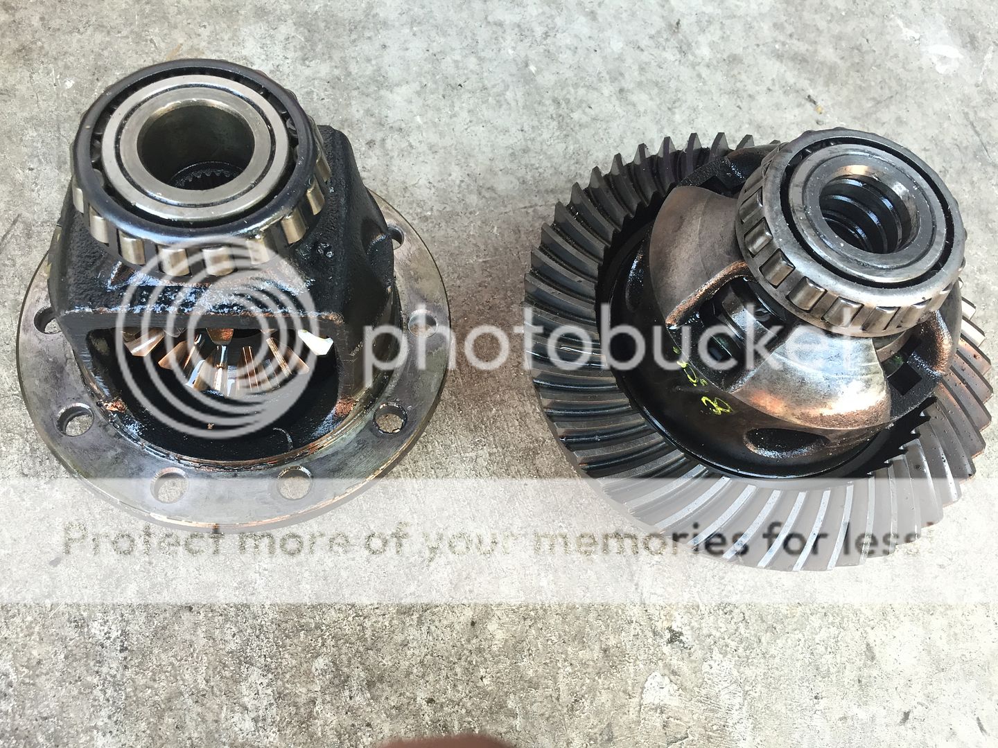

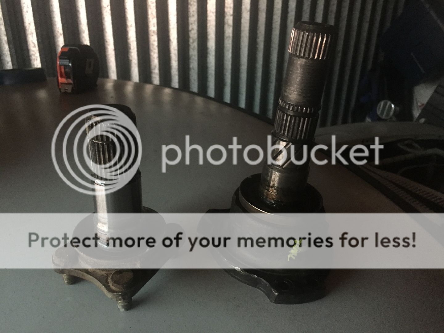

seattlejester Posted November 1, 2015 Author Share Posted November 1, 2015 So my thoughts, concerns, questions, on the J30 VLSD swap so far. Some are going to be pretty specific, but I want it out there. I still need to take out the C-clips install the center into the pumpkin and really take some measurements, but my condensed thought process so far. Quick overview, the idea came from a post on here. Unfortunately not much more information exists. This keeps the car with a long nose R200, so the appeal is no new mounts or drive shafts have to be made. http://forums.hybridz.org/topic/42612-talkin-the-talk-q45-r230-r200-z30-so-on-so-on/page-3?do=findComment&comment=832456 I found a 300zx turbo differential from an early Z31: 130$ Took the input shafts and the center from a 93 J30: 100$ Got the long nose R200 from a friend: Free Thicker shim: 20$ Total for parts: 250$ You can see from the financial perspective why this might seem like a great idea. The VLSD comes from a J30 which was only ever sold as an automatic over here. Usually the ones in the junkyard seem to have trouble in the engine bay area the rear end seems to be unscathed in the ones I have seen. Z31 differentials used to be quite cheap especially the non VLSD ones, I think misinformation has been driving their prices up quite a bit. Both cars I have seen in the junk yard multiple times. Pulling the differential from the J30 required a sawzall for the rusted exhasut and the drive shaft. The nut and bolts holding the axles were easy enough to pull apart. I didn't want to take a whole differential so it required opening the diff and prying out the center. I would advise taking the whole diff, I got dinged a good deal for just wanting the parts, I got charged for axles for the input shafts. Rather then just a differential. Input shaft short side (driver I think): I have verified that they are the same spline as the short nose. Going off the post linked above, it says you can just insert the stub axle from the long nose R200 and call it a day. Looking at the measurements there seems to be two possible problems. The Long nose shaft is longer then the short nose by a couple mm (has more material internally past the c-clip groove towards the center), and the sealing surface is deeper on the short nose. So compared to where the C-clip groove is, the long nose input would sit further in then the short nose input while potentially bottoming out a bit sooner. The inboard length I'm sure can be ground down a bit if it interferes, but the sealing flange length may be problematic, is the difference caused by the different physical size in the differentials short nose being a bit wider? I suspect so. I think this can still be readily solved. At most I imagine a little grinding of the input, I think the outside will clear. Inputshaft long side (passenger side I think): Now comes the dilemma hoping maybe someone knows more info. Four main options here. 1. Run the 6 bolt input, hope that it doesn't bottom out before it engages C-clip groove. Use a 6 bolt J30 CV to adapt it to custom axle 2. Run the 6 bolt input, adapt it it to another pattern 4 bolt or 6 bolt equally spaced (Porsche 930 CV) use custom axle. 3. Cut the whole shaft off of the 6 bolt input, and find a machine shop to weld back to however much of the 4 bolt input is needed to fit nicely into the differential (pretty much as indicated in the post). 4. Cut just the longer portion of the 6 bolt input, and find a machine shop to weld the longer potion onto just the tip of the 4 bolt input. Option 1 and 2 would push me towards a CV axle much sooner. Option 2 may make a very silly looking axle given the first CV would be 4 or 5 inches or so from the differential depending on the adapter. Option 3 and 4 would allow me to stay with half shafts. Option 3 would require a lathe and I'm guessing a hole saw, hole saw to cut the 4 bolt flange and a lathe to turn the flange off of the 6 bolt and fit and weld. Option 4 would require a service that welds shafts, I'm not sure something like that exists. Hoping to get some more measurements and narrow down some options. I'd like to stay half shafts and then just go CV by using 4 bolt to CV adapters at a later point in time just so I don't have to drop another 500-900 on axles to get the VLSD in. As for the rest of the car, BC coilovers arrived, the rear strut housings have been cut and are ready to be welded. All the new bearings and studs are in for the rear stub axle, just have to clean and install it. The grease seal for the stub axle looks a bit strange though, it is a steel plate with a rubber ring on the outside. Looks nothing like the stock piece. Still have to cut the front strut housings to size and clean them, still have to get some slag off the control arms and finish grinding the remnants of the old arms as well as clean it for powder coat. Picked up some killer valve covers for the 7mgte, unfortunately it interferes with the factory hood latch so that has to go. I bought some quick latches I may try, I don't want to try and install an aerocatch as that was surprisingly a fairly arduous ordeal and I imagine with the multiple skins on the hood won't be easy either. Going to the parts store to pick up new u-joints to rebuild a set of half shafts. Any recommendations? Quote Link to comment Share on other sites More sharing options...
seattlejester Posted November 5, 2015 Author Share Posted November 5, 2015 So will know more today, but a set of 280zxt turbo adapters came up for sale so I may pick those up and try to stay nissan throughout the rear end and save on headaches. Found some information that the J30 input shafts will fit into a long nose 300zx differential without any modification needed. Ordering a bunch of test parts so pretty excited about the whole deal. May have a full rear end swap to just throw up there and be able to pull my other setup out completely. Thinking I will pick up the Techno toy tuning tension rods for sure, not sure if I'll grab the FLCA's quite yet. Quote Link to comment Share on other sites More sharing options...
