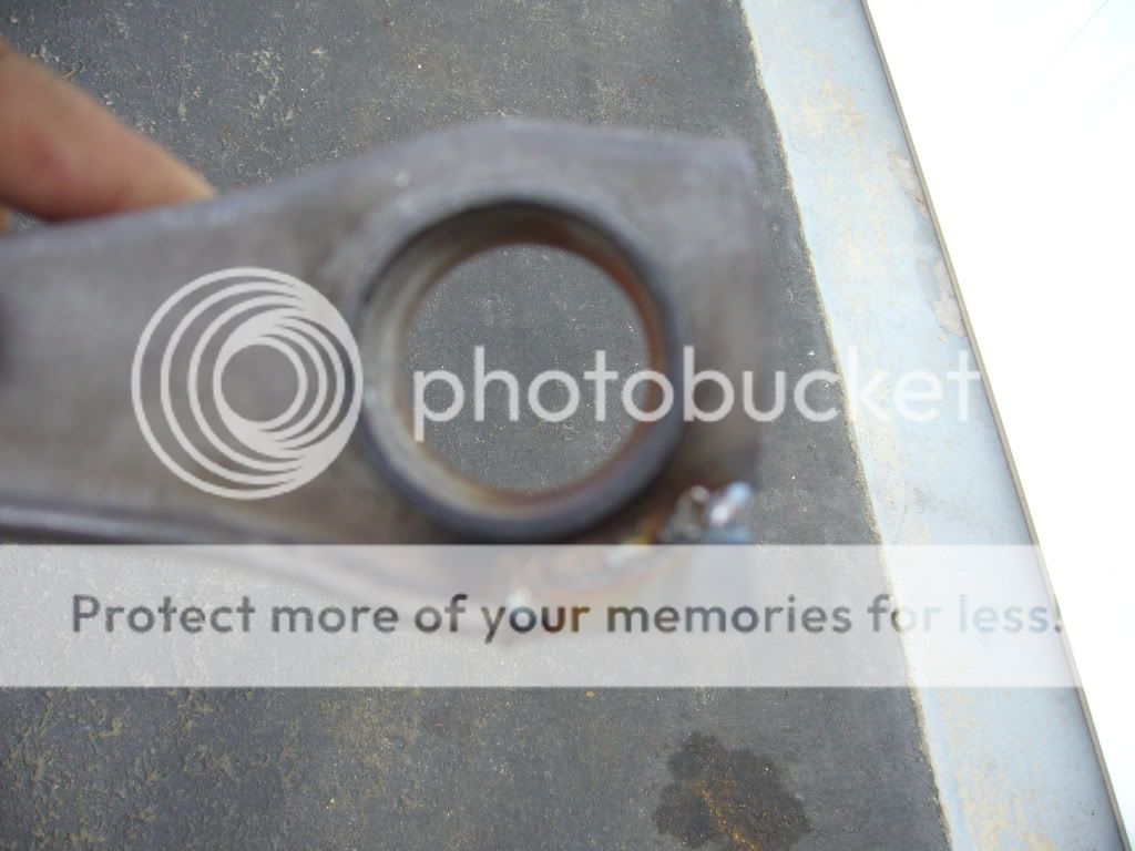

seattlejester Posted September 28, 2011 Author Share Posted September 28, 2011 (edited) For 40$ you can't go wrong , in all honesty it's kept me out of a few harry situations, it has balls of melted steel inbedded in the face shield and I melted through the mouth portion when I leaned against my roll bar mount, still works like a champ. Problems for the day: Can't find a way to drill a 2 inch hole for the strut tower plates, the hole saw is just skipping along the surface, and grinding it out with a dremel bit just sounds awful, any suggestions? Not sure about the curvature of the dog leg-rear fender area. Can someone take a picture with a ruler in the rear fender to show how much the dogleg sticks out? I've been eyeing a few local 240's and am tempted to just walk up and ask some strangers. Plans for the week (whoever keeps these ) : Weather is suppose to be decent for the next 3 days, so I'll spend tonight sifting sand for the blaster, cosmetic grinding, paint prep, and draw up my fuel cell box. Tomorrow I'll double check all the welds to make sure they are complete, and cut out the rear spare tire, attach box, sand blast, and put down primer and sealant on the new bare metal. Friday I'll finish the fuel cell box and spray the interior with color. Let everything dry over the weekend, undisturbed, than start the installs! Future to do list: Install all lines for fuel. Install all lines for brakes. Install new suspension. Install new brakes. Figure out how to undo the tie rods from the steering rack. Install steering rack. Weld differential. Change gear oil in diff and tranny. Install rear diff. Paint prep and fit doors and hatch. Install weather kit and rest of body. Make new fuse box and wiring for essentials and accessories. Rebuild engine. Replace clutch and resurface or replace flywheel. Mount transmission on engine. Install driveline. Trouble shoot what goes wrong. Need to finish in 3 months, wish me luck! Edited September 28, 2011 by seattlejester Quote Link to comment Share on other sites More sharing options...
Pharaohabq Posted September 28, 2011 Share Posted September 28, 2011 Hey Seattle... Oh that 2" hole saw, is it skipping around because there's no center point to hold it in place? If that's the case you can screw a piece of wood behind the plate to give the saw something to center on. Aside from that you can use your angle grinder to cut a notch for the edge of the saw to seat into. then maybe it'll bite and you can cut. What kind of hole saw do you have? The carbide ones are pretty good for metal. Looks like you've done a lot of work, but that you still have a lot to do. Gotta give props to you for being brave enough to paint it yourself. Quote Link to comment Share on other sites More sharing options...
seattlejester Posted September 28, 2011 Author Share Posted September 28, 2011 Oh, cutting an edge for it isn't a bad idea at all. It's a bi-metal hole saw with a center pilot bit. Maybe I should be looking into a carbide one, it worked great on he 2 inch steel tubing, but on something flat it's giving me a bit of trouble, but I have ideas now, thanks! Quote Link to comment Share on other sites More sharing options...

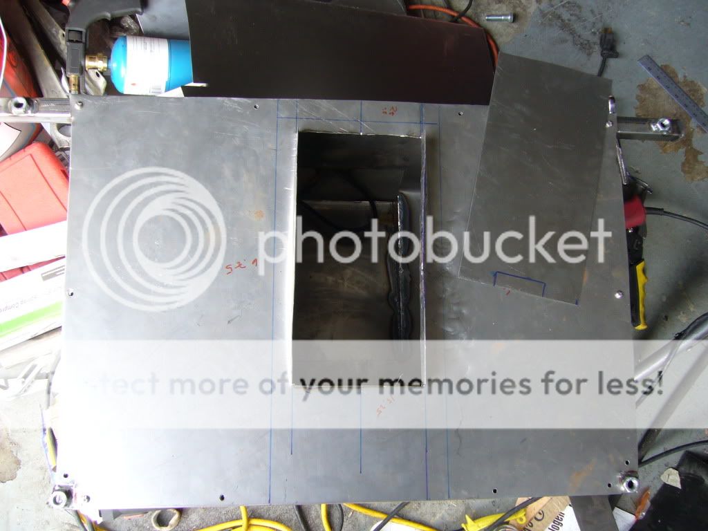

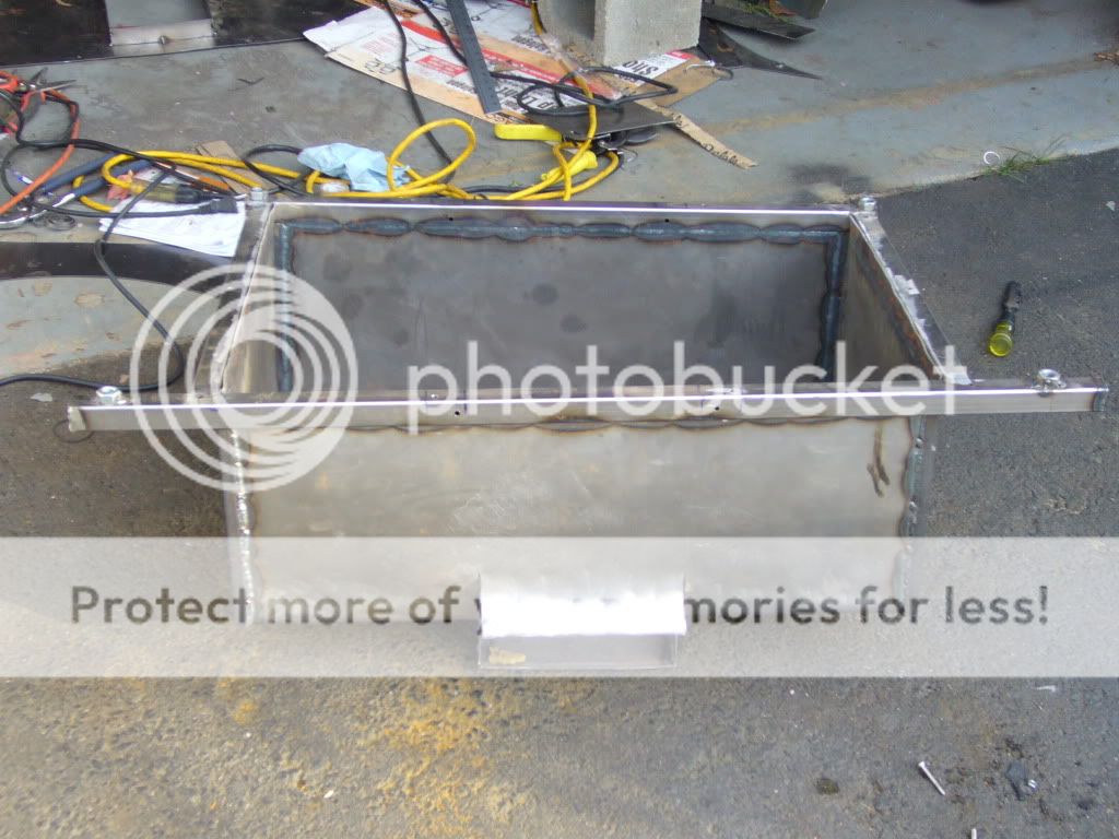

seattlejester Posted October 2, 2011 Author Share Posted October 2, 2011 So I'm stuck and I need some advice. Terminology I will be using: Cross bar: the bars that go across the rear frame that will support the box and fuel cell. Box: the steel box that houses the fuel cell. Fuel cell: the fuel cell itself. The fuel cell arrived, and I'm almost done making the box for it. I welded the cross bars to the box, the reasoning was since my box only comes up to the very top, I thought I could use the cross bars as a flange to mount the top of the box. The box is big enough that the cell slides in and out pretty easily, but after the top goes on, and the cross bars are welded to the rear frame, my only access to the actual cell is the hole where the spare tire well was, and the fuel cell will sit off center. Picture below to illustrate the problem, but unlike this wise gentleman, I welded the cross bars to the box. borrowed from gmac708 Looks like I have few choices, at this time, I'm not quite sure which route to take: 1. Don't worry about it and just move on, weld slowly to dissipate heat. If I need to service it in the future, drain the tank than cut the cross bars <-doesn't seem like a great idea if fuel cells need service often, and will put a bit of heat into the fuel cell. 2. Cut the rear floor into a square so I can pull out or put the cell in after all the welding is done (this would take care of the concern of melting the cell), then make an additional square panel <-since the rear floor isn't flat, this may prove to be very difficult/time consuming. 3. Cut the bars off, find a way to finish the box in it's own entirety, then make straps that will bolt the box onto the subframe <-the bars are almost completely welded on, will be very time consuming. 4. Weld mounts onto the rear sub frame, and bolt the cross bars into the mount <-this would work, but the mounts would have to be very thick and fairly wide, and since the tubing is small, I would have to find a sweet spot for a bolt that is wide enough to support the weight of a fully loaded cell, while being skinny enough not to compromise the cross bar walls. Quote Link to comment Share on other sites More sharing options...
seattlejester Posted October 8, 2011 Author Share Posted October 8, 2011 I found out yesterday, for the amount I spent, I could have just purchased a baffled aluminum cell and had a very very easy install, but I suppose I wouldn't have had the experiences I had. Just like I could have gone and borrowed a friend's bead roller (saved myself time and money), but instead I hammered the box into shape. Anyways, I decided to go with the 4th option. 4 L-shaped mounts with bolts running through the mount to a welded nut on top of the fuel cell box. I measured everything out at least 3 times, then started mounting them but somehow I was ridiculously off on some fronts, rechecked to make sure my box was relatively square and all my measurements remain the same still was off by a good inch or so in one direction and another 1/2 inch in another. I suspect that the rear subframe may not be equivalent on both sides, or I have some strange dyslexia when it comes to reading my tape measure . I'll have to tackle that issue tomorrow, full 5-6 hour day planned tomorrow: *Complete a pass over the car, grind down abnormally high welds, fill in any pin holes, sand away rubber/glue residue, chip off burnt under coat, etc. *Clean the ridiculously messy garage, and setup tarps. *Tac'ing and finishing the other two mounts. *Making the spare tire cover and the pass through for fuel filler access. *Figuring out a method to cap the sump area. *Wiping clean the mount areas, then spraying them with undercoat. Bought a bearing puller and strut spring compressor so I'll start tackling the struts if time permits. Everything to mount my brakes have arrived, so I'm just left with having to decide if I will rebuild the parking cable or if I will attempt the cable less life. Quote Link to comment Share on other sites More sharing options...

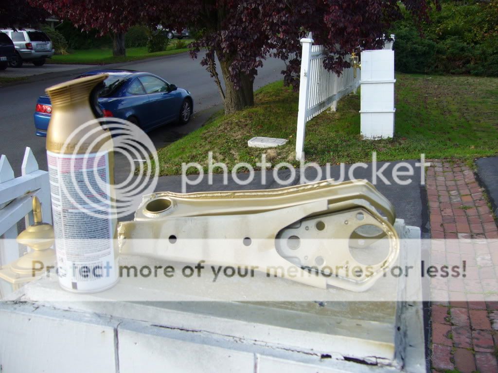

seattlejester Posted October 24, 2011 Author Share Posted October 24, 2011 (edited) Update time . If anyone was curious, a little info about sheen from what I've found and seen: Flat > Matte > Satin > Gloss Flat---------------------------Shiny Flat has that cool effect of emptyness, where it doesn't reflect light very well and gives a type of void like feeling, unfortunately it is really rough and a touch with a dirty glove will leave a dark smudge that's really hard to get rid of (guess how I know ). So I decided the color of the car will be satin white, I was expecting quite a reflective shine, but it turned out pretty much exactly how I wanted. Flat white for comparison. Body work: Since this is out here... Then it means it's no longer here! Friend came over and popped out this neat little cover. Made the fuel cell shield, not bad for just a hammer, but there is a definite presence of warpage. I tried to be smart and save my self some welding by folding up the sides of the box... Unfortunately that was a foolish attempt, especially without a bead roller, I really should learn to be patient, so here's the reattempt. With the appropriate lid. Still working out how I'm going to attach it and make it vapor proof (there will be an external vent line so no worries about implosions). Had a really hard time mounting the box back up since the holes no longer lined up (about 4 hours of work), the way I made it the first time was bolting the mounts up to the box then welding it in. Seems like warpage is not a myth >.<. Suspension work: Decided I would start finishing up some suspension pieces. Sandblasted a few pieces. Then applied some hammered paint. Bought this little beauty for 90$. So decided I would have at trying to press the LCA bushings out. Uunfortunately the way the LCA is shaped it makes it really really difficult to push the bushing out. I ended up pushing it out part way, then heating it up, then using the sawzall to cut the bushing and hammering it out, unfortunately, one side did not make it out intact. ^I ended up cutting out the crushed bits, then welding in some replacements. Then finished the hole thing off by boxing the LCA, the metal had been hammered to the point hwere I wanted some additional reinforcement. Finally finished it off with a coat of gold. Edited October 24, 2011 by seattlejester Quote Link to comment Share on other sites More sharing options...

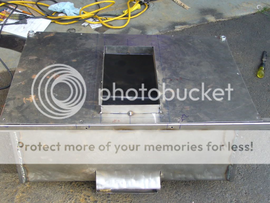

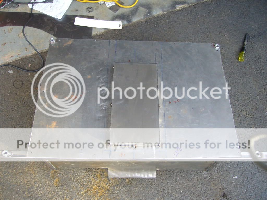

seattlejester Posted November 3, 2011 Author Share Posted November 3, 2011 Everything fits, still need to find a way to seal the gap between the box and cover. Duct tape? Hvac tape? It hangs a bit low and a bit more far back than I had hoped. Hoping that some paint will help hide the obviousness. Quote Link to comment Share on other sites More sharing options...
seattlejester Posted November 4, 2011 Author Share Posted November 4, 2011 So.... Yesterday I was planning on finishing up the box and fit everything for the first time, including the actual cell. Turned out my friend had made the perfect template...1 inch off (making it ever so small to encompass the vent line). After a good laugh I told him to fix his error, and as a good sport he did . Have a little more grinding and welding to do, pictures soon! Quote Link to comment Share on other sites More sharing options...
