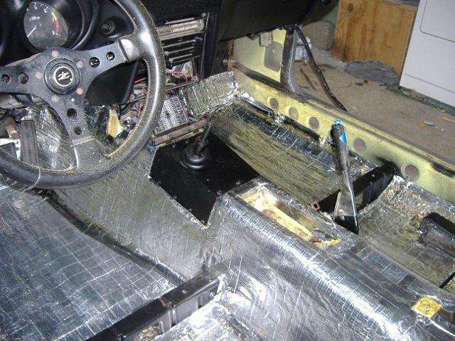

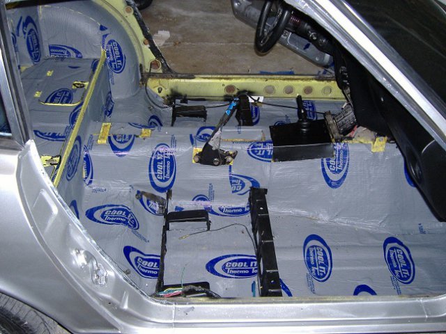

Miles Posted February 11, 2011 Share Posted February 11, 2011 (edited) I used the MSA Delux kit which covers the floor, trans tunnel,side rails, riser, rear deck and rear strut towers. Looks excellent. No fitment problems. I glued all of the carpet except for the rear deck. I installed sound and heat insulation before installing the carpet. It was easy to do as long as you don't rush it and plan ahead what pieces to install first.. By the way, does any company make an actual molded carpet kit for the 240Z, 260Z or 280Z? The so called "molded carpet" kits I found were actually sewn sections. Edited February 12, 2011 by Miles Quote Link to comment Share on other sites More sharing options...

Miles Posted February 12, 2011 Share Posted February 12, 2011 (edited) I wasted about three months researching carpet and followed many false leads. The MSA Delux kit is fine. Note that the strut covers fit best if you fill in the holes in the strut frame with some thin wood sheet material. I just cut the wood sheet to follow the angles of the strut frames and glued them on. This will hold the shape of the carpet over strut tower better. See attached picture for area to be filled in. Also, there is no hole cut in the strut cover carpet for access to the strut attachment bolts. I carefully cut a small hole in the carpet just big enough to access the bolts. I was able to install the new plastic strut caps to cover the holes so it looks stock. Edited February 12, 2011 by Miles Quote Link to comment Share on other sites More sharing options...

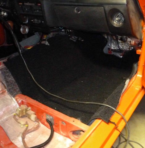

darom Posted February 16, 2011 Share Posted February 16, 2011 I bought Chester and Herod 280z carpet kit 1.5 year ago and just this week started installing it. Overall, I am quite disappointed with its quality: 1. The back rear deck carpet is too big to fit, the edges are sewn which I don't feel like cutting unless I take care of these edges later myself. The luggage strap areas didn't align correctly. 2. The front section of the carpet should have had the back side 'skirts' included to cover the whole door sill area nicely, instead of having 2 separate pieces which overlap each other. 3. The same applies to the middle tunnel section. I will have to overlap the front with the middle section to get even look. It came with jute padding which wasn't glued on, I am in the process of gluing the jute padding to the back of the carpet (overkill, probably). The side skirts were included, but cut in such a rushed fashion, I am still scratching my head how to make it look clean. I also asked them to cut me rectangular pieces to put under the seats. For additional $22, I got two pieces, with one side which had edge sewn, the rest weren't. I am wondering why they couldn't get the other 3 sides to finish. Lazy? The cost was $325 shipped. I should have done better research. Sorry about venting here, but I also had a carpet installed years ago in my 67 Camaro, and that was a piece of modern marvel: it was molded, all edges were sewn creating a nice edge, thick with padding jute glued. It fit like a glove. It was one piece for the front and middle tunnel sections which hid the back seat carpet area overlap. It does make it more difficult to install, but it allows to create a smooth 'complete' look to it. This Datsun carpet seems to be too thin, I am afraid it will start disintegrating in a year or so. I think after I am done test fitting/cutting it, I will take it to the local upholstery shop to add the missing sewn edges to better reinforce it. Regards! Quote Link to comment Share on other sites More sharing options...

darom Posted February 21, 2011 Share Posted February 21, 2011 (edited) CamH, see attached. Hopefully this helps to pick the right carpet kit for your car (sorry guys, I am a newbie in Photoshop to make the pictures look smaller when you click on them). Edited February 21, 2011 by darom Quote Link to comment Share on other sites More sharing options...
CamH Posted February 21, 2011 Author Share Posted February 21, 2011 On 2/21/2011 at 12:20 AM, darom said: CamH, see attached. Hopefully this helps to pick the right carpet kit for your car (sorry guys, I am a newbie in Photoshop to make the pictures look smaller when you click on them). Wow, that is definitely a sloppily made kit. Thanks for the pictures. Quote Link to comment Share on other sites More sharing options...
