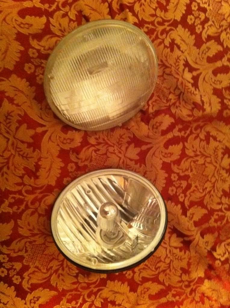

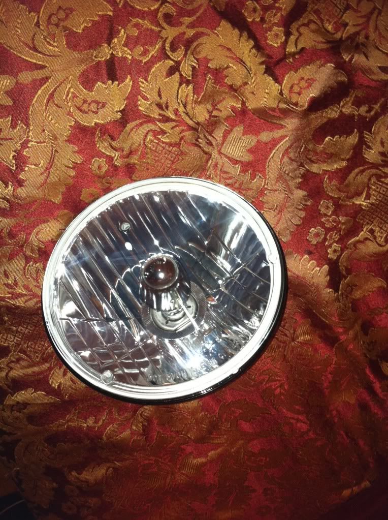

tecreatta Posted March 8, 2011 Share Posted March 8, 2011 (edited) I've glanced through the forums and didn't find a post related to sealed beams. I personally hate the buggers because replacing a whole housing seems like a pain plus they generally look ugly. I recently acquired a sealed beam conversion kit for my 280zx. The website I bought them from called them Euro-Headlights, so I thought I'd post pictures and see what others thought. Edited March 8, 2011 by tecreatta Quote Link to comment Share on other sites More sharing options...

Tony D Posted March 10, 2011 Share Posted March 10, 2011 (edited) You didn't find anything because most people refer to it as an "H4 Lights Conversion" A 'sealed-beam conversion' is what you did to the Model T with the acetylene lamps! It appears you got some DOT MSR lights, they don't look E4 Compatible (from the photos)... You might like the E-Code variants even more! It's curious they didn't come with a heavy rubber debris cap for the back of the bulb connection, most Euro H4 Reflectors come with that. Edited March 10, 2011 by Tony D Quote Link to comment Share on other sites More sharing options...

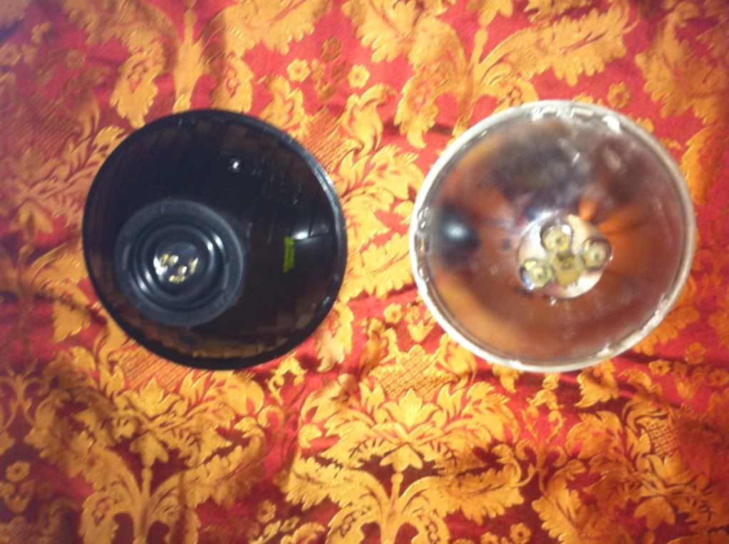

bens1088 Posted March 12, 2011 Share Posted March 12, 2011 I've glanced through the forums and didn't find a post related to sealed beams. I personally hate the buggers because replacing a whole housing seems like a pain plus they generally look ugly. I recently acquired a sealed beam conversion kit for my 280zx. The website I bought them from called them Euro-Headlights, so I thought I'd post pictures and see what others thought. What kind of projector is that in the last picture? Quote Link to comment Share on other sites More sharing options...
tecreatta Posted March 12, 2011 Author Share Posted March 12, 2011 It's just a normal h4 halogen bulb. Quote Link to comment Share on other sites More sharing options...
Tony D Posted March 12, 2011 Share Posted March 12, 2011 What you think is a 'projector' is merely the shade cap on the H4 capsule in the reflector. Personally, I pull them out as it interferes with light transfer by about 30%. You do get the 'dazzle' bright spot in the center of the lens afterwards, but on E-Codes with their defined cutoff it's only really an issue on high-beam. And then there shouldn't be oncoming traffic to bother! Quote Link to comment Share on other sites More sharing options...
bens1088 Posted March 12, 2011 Share Posted March 12, 2011 What you think is a 'projector' is merely the shade cap on the H4 capsule in the reflector. Personally, I pull them out as it interferes with light transfer by about 30%. You do get the 'dazzle' bright spot in the center of the lens afterwards, but on E-Codes with their defined cutoff it's only really an issue on high-beam. And then there shouldn't be oncoming traffic to bother! I'm talking about the black headlight in the last picture. Quote Link to comment Share on other sites More sharing options...

padam07 Posted March 12, 2011 Share Posted March 12, 2011 I'm talking about the black headlight in the last picture. That isn't a projector. That is the back of the headlight. Quote Link to comment Share on other sites More sharing options...

Tony D Posted March 13, 2011 Share Posted March 13, 2011 That isn't a projector. That is the back of the headlight. Ditto, it's a standard plastic MSR reflector. Projectors don't have an H4 Bulb Spade pattern and bail on the back. Quote Link to comment Share on other sites More sharing options...
