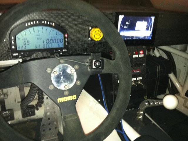

cobramatt Posted November 13, 2012 Author Share Posted November 13, 2012 I have not checked in a while but have added an item that I think a few of you will like. A rear view color HD monitor. In my race this past weekend I found it to be very helpful..... The pro's and con's. 1. I have been checking my mirrors for 28 years on track and its a very hard thing to change. I actually forgot I had installed it for a long time as it was just natural to check my mirrors. I covered the rear view mirror with black tape and it forced me to check the new monitor. That was not my idea BTW. I was going to take the mirror out and a fellow racer said why didnt I just cover it, because maybe I would not like it and I could just take the tape off. (Giving credit where credit is due) 2. I think you really need to get used to more than just where you look to see where someone is behind you. There is the fact that if someone has a bright painted car and they are on your bumper it can distract you. Once again, something I need to get used to. 3. I was a little more comfortable in my race on Sunday with the setup and found its location to very helpful in keeping my situational awareness and not having to actually take my eyes off the track in front of me. 4. It cost a little over $200 in parts. A rear back up camera (mounted in the rear fascia) and a 7" monitor (made for a head rest). The wiring took around 5 hrs. We had to install a few more switches to our dash panel to accomodate the on/off of the camera. Now we will have a few extra lines when they are needed. 5. I think the cost is justified and in time will be an advantage over my competition. If all else fails its really easy to back in to my pit stall now. Matt Quote Link to comment Share on other sites More sharing options...
Mikelly Posted November 13, 2012 Share Posted November 13, 2012 (edited) Dude that's genius! I hate my mirrors and would think something like that would be a lot more beneficial. By the way, Nice video. Congrats on the win! Mike Edited November 13, 2012 by Mikelly Quote Link to comment Share on other sites More sharing options...
mark Posted November 13, 2012 Share Posted November 13, 2012 Why do you need to see behind you? That thing is quick as hell! Nice idea. I like it. Very cool. Quote Link to comment Share on other sites More sharing options...
cobramatt Posted November 13, 2012 Author Share Posted November 13, 2012 Why do you need to see behind you? That thing is quick as hell! Nice idea. I like it. Very cool. Its quick..but there is always someone quicker. With the roll bars, smarty cam mount and camera, the halo racetech seat, in a helmet with a Hans device its not exactly that easy to see out the back. This gives me 170 degrees of vision and I dont have to even move my head. I appreciate the witty humor but the thing really does work. I need all the help I can get. It also doubles as a Blu Ray player so I can watch my favorite new releases going down the back straight. Matt 1 Quote Link to comment Share on other sites More sharing options...
