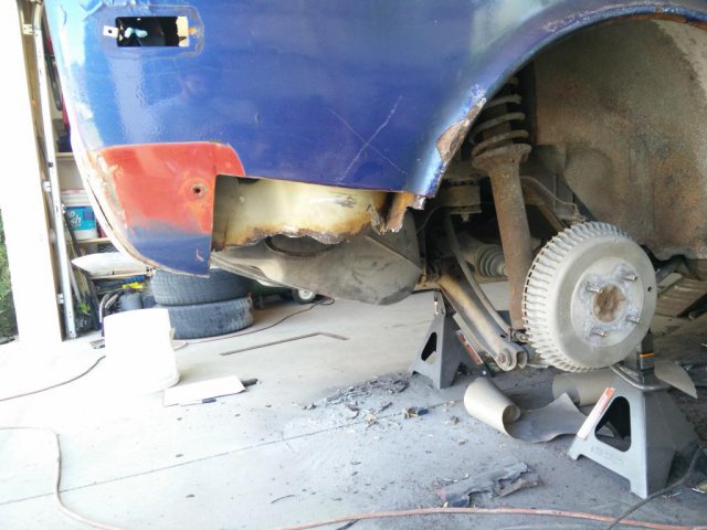

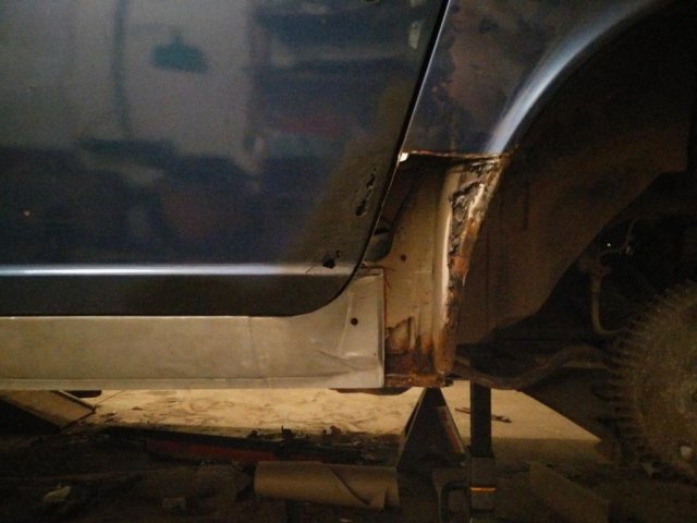

Posted 23 July 2015 - 02:35 PM
Rocker panels and other bits have been done for almost two weeks now, just haven't had a chance to upload pictures. I'll have them uploaded sometime tonight once I've sorted through them for before/after deals.
Still have some more bits to weld including some floor patching and the frame rails, plus the holes from the old bumpers in the back but for now it's really coming along and starting to take shape. It's far from any sort of ground up restoration but a lot of major issues will be taken care of.
The passenger door aligns quite well and closes, but the driver side door (unfortunately) closes just as poorly as before and I haven't quite figured out why. It's no different from before swapping the rockers, so I know it's not that, but it's still bugging me that it's harder to close and almost needs to be slammed to shut completely.

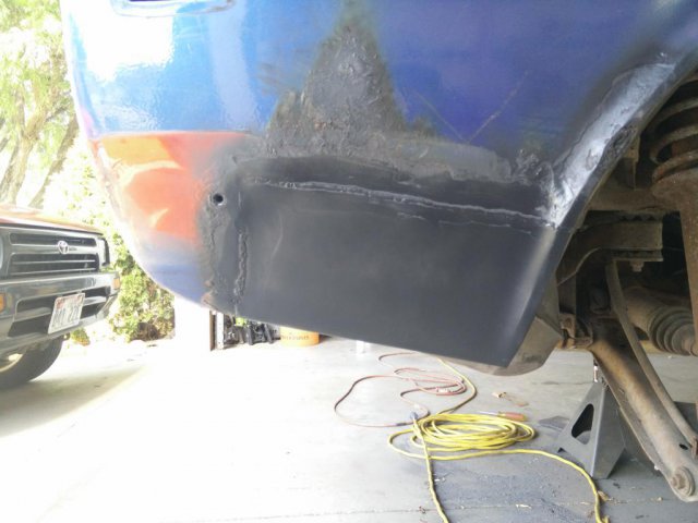

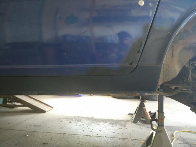

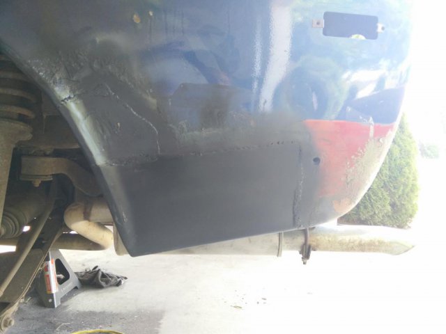

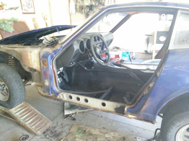

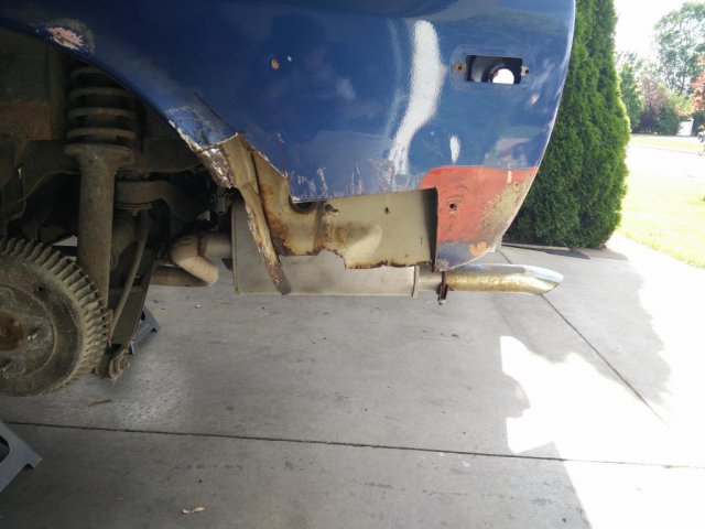

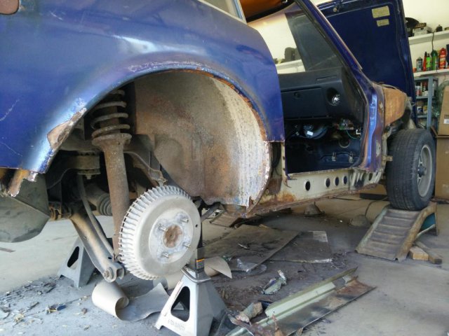

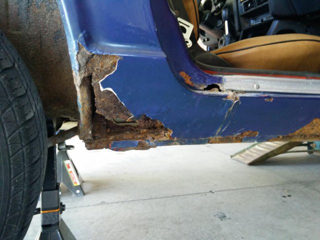

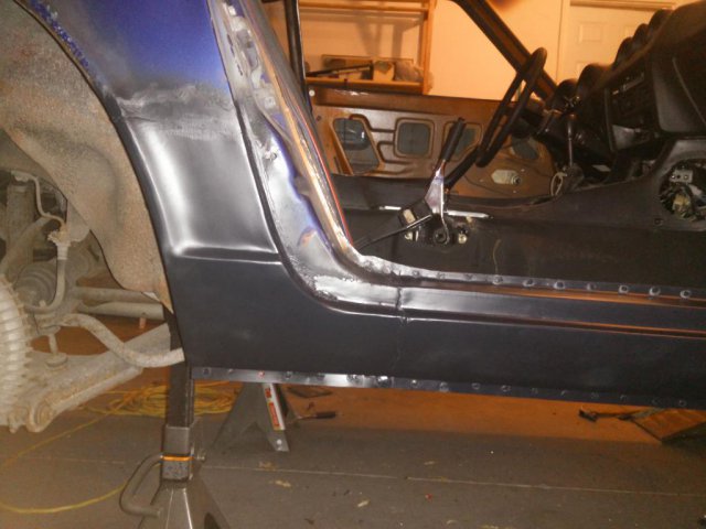

Pictures as promised. Wasn't done with a regular mig, no gas, so the welds still need some more grinding down and cleaning up, but I sprayed it with a thin coat of black primer for now while I get a chance to clean them up more down the road when I'm actually prepping for paint. Note I have way more pictures of rust but for the sake of comparisons and seeing a few in between shots this is all I'll upload. :)
Cut up
Attached File  IMG_20150618_121830.jpg   87.7KB   0 downloadsAttached File  IMG_20150626_150543.jpg   107.7KB   0 downloads
Passenger side
Attached File  IMG_20150615_133451.jpg   94.18KB   0 downloadsAttached File  IMG_20150713_213047.jpg   82.66KB   0 downloads
Attached File  IMG_20150626_150540.jpg   98.93KB   0 downloadsAttached File  IMG_20150723_163112.jpg   77.61KB   0 downloads
Driver side
Attached File  IMG_20150624_222019.jpg   74.28KB   0 downloadsAttached File  IMG_20150723_163030.jpg   66.54KB   0 downloads
Attached File  IMG_20150710_172326.jpg   88.18KB   0 downloadsAttached File  IMG_20150723_163057.jpg   55.77KB   0 downloads
