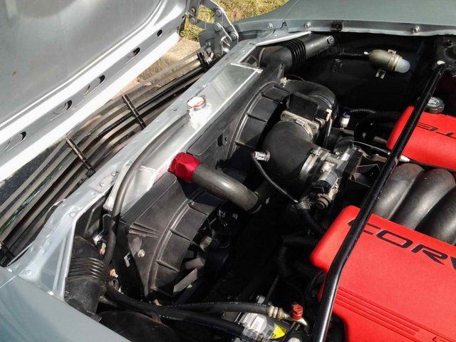

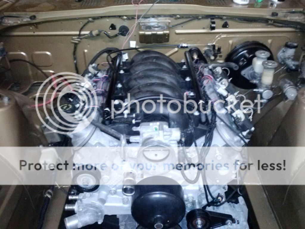

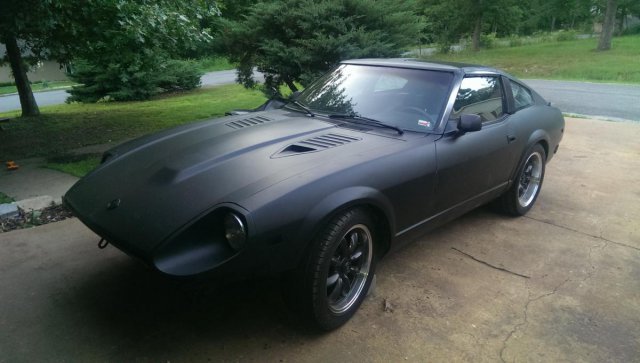

1976 280Z Coupe
  1. 2002 5.3 bone stock (for now) from a Chevrolet Avalanche with 80k miles. LS1 pan, LS1 alt bracket with 5.3 alternator, LS1 intake/injectors/rails, Taurus fan.
  2. TR6060 from a 2011 Camaro SS with 2k miles.  Monster Clutch Stage 2 with lightweight flywheel.  GTOPL-2 driveshaft adapter and slip driveshaft.  TR6060 pilot bearing not a T56 one.
  3. JCI Engine Mounts and Custom Trans Mount while utilizing the factory TR6060 rubber mount.
  4. AN6 Push Lock Hose, LS1 Factory Returnless Rails (for now), Walbro 255, Corvette FPR, 15 gallon fuel cell.  Chevythunder.com wiring harness worked flawlessly truly plug n play, best $500 spent (including emissions flashed computer with 5.3 and LS1 parts on engine).  Electronics were my weak point of doing this swap.
  5. Compiled data to build for a year, took 1.5 years to find the right deal on a car $2k on 3/19/12 and drove it 300 miles home at 80mph with 169k miles on it and dry rotted tires, pulled straight 6 out on 12/15/12, fired up V8 on 9/14/13.
  6. It took 9 months to fire up because of: new 16x8 XXR 531 wheels/tires, full master poly bushing kit, undercoating, tokico 5 way struts/springs, fuel cell, brakes, rotors, bearings, full suspension removal, cleaned calipers, brake lines, RT diff mount, 280ZXT CV’s and adapters, minor rust removal, etc… and around fishing, golf, car shows, truck pulls, girlfriend, new job, you know “lifeâ€
Now it’s going to be a rush to get the rest fixed up and redo interior, dash, paint/body work competed but at least it’s alive!!
Pictures are on my flickr account in my signature (hope to have a build thread soon to show it off with part numbers and future plans).  Couldn’t have done it without the help of all the guys on this site (Thanks) and the loads of info I pulled out of here!  Time slips soon to follow…

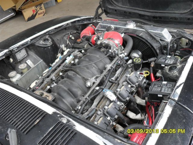

1982 280zx started as a stock ls1 swap, now it has a brand new lq4 with forged flat top pistons, 233/236 cam dual springs and hardened pushrods, ls1 241 ported heads. t56 6 speed trans with monster stage 3 clutch. r200 limited slip with 373 gears. Rota 17in wheels with 275 nt05r drag radials. post-42451-0-67929100-1402191057_thumb.jpgpost-42451-0-06852600-1402191078_thumb.jpg
Share this post

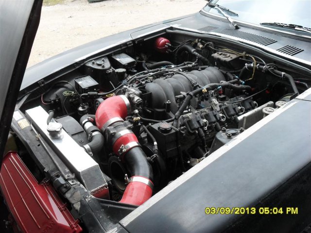

LS3 based 403 stroker using Callies Compstar crank and rods, along with SRP pistons. The heads are L92 and the injectors are 48#. Intake is a stock Ls3 and the Tbody is a nick williams. Oil system on this one is a DRYSUMP from Nutter Racing Engines. The lines are Parker Pushlok and the tank is a butlerbuilt square 4 gallon. We plumb it with a Moroso -16 vent tank and also vent the PCV system with twin tanks plumbed to both chambers of the top of the motor. Everything is managed by the FAST XFI and XIM systems and all data is monitored with the integrated FAST DASH with data logging.
The Drivetrain consists if a custom T56 I hand built, and a Ford 8.8 rear IRS, that I also completely rebuilt. The car is NOT a street car and is going to start the 2015 season as a Time Trial car in NASA and move over to wheel to wheel in VINTAGE Outlaw.

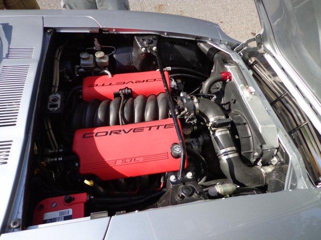

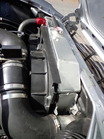

LS1
t56
Long tube extractors (headers)
GM, IRS, LSD differential
Wilwoods
Adjustable LCAs
Dayton wire knock-offs
PWR radiator - relocated forward of engine bay
Aluminium fuel tank
GM in-tank fuel pump
Puckett, 250 GTO, body
RHD

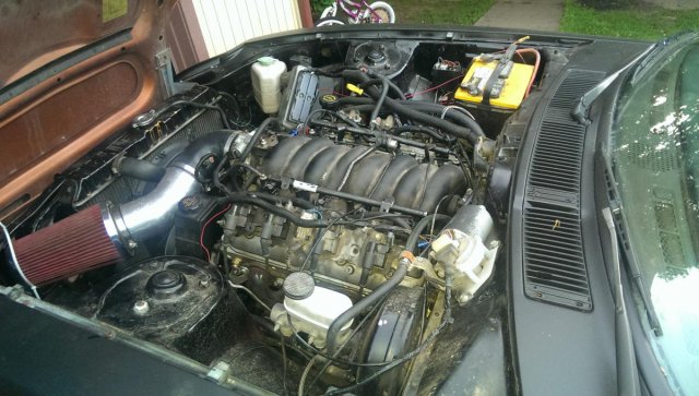

Pardon the dust, its been a slow moving project.
The LS1
  • Holley XP 750 Carb + Holley Intake
  • 211/230 .558/.552 122.5 Cam
  • 1.7 ratio rockers,
  • mild ported
  • MSD 6LS Ignition Controller
  • LS2/3 Coils
  • Meziere electric water pump,
  • CX racing long tube headers (not pictured)
  • Hoke Performance (beta test) motor and trans mounts.
Edited by spitsnaugle
Share this post
Spitz-how do you power the alternator with the electric water pump?
Uh, say what. lol. Its a bit vise versa :)
Unless you're talking belt wise... then its pretty simple:
But.... that alternator is too big for my liking. So I want to fab up a mini alternator on the low passenger side.

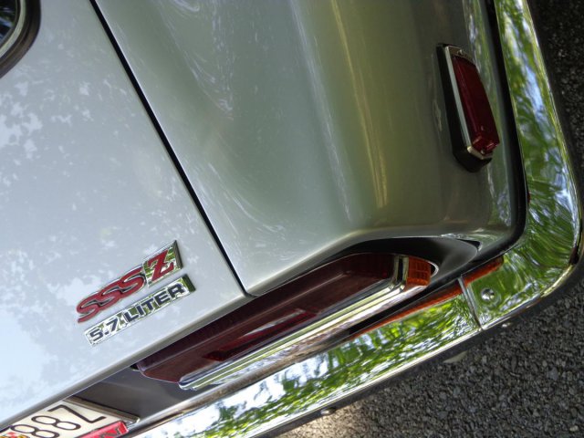

:1983 280zx
:L33 5.3 aluminum block bored to 5.7, ls2 dart heads, forged piston/rods,ls6 intake 406whp
:RPM t56 trans rated for 750hp
:R200 w/ 3:54 gears and quaife internals
:modified JTR mounts for SBC to work with the Ls motor
:special Canton oil pan to get the motor low enuff
:headers are the biggest problem, I modified Billy boat c5 shorty headers
:made my own dual 2 1/2 to single 3 1/2, all stainless, had to use oval pipe to get over sub frame
:my grandfather purchased the car in 1984, then my dad had it and I bought it from him in 2004
started with a SBC swap in 2008 but it made the car nose heavy and I still felt it was out dated.
in 2010 the Ls swap was done.im jealous of all the stuff the older Z's have for Ls swaps, zx's have nothing
: A friend and I fully restored the body and painted the car from blue to black
:Arizona z car brakes
:techno toys front shortened coilovers
:custom made 420lb rear springs (very needed to reduce squat)
:whitehead performance 300m 39 spline stub axles
:300zxt cv-joints
:Boze custom made rims 17x7 and 17x8
:shaved side markers, antenna, side trim, rear wiper, custom taillights
:aeromotive fuel system, modified gas tank to be gravity feed.
: on and on and on, ill just stop there
everything done by myself and help from friends and family. many,many long nights and dedicated hours. And a wife that supports me taking the time to do it.
BUILT NOT BOUGHT!!!
Edited by G-Tech
Share this post
I really hope this post can inspire some 280zx owners to do the swap. there isn't many that have completed this swap. the car is very dependable. 2918lbs. 50/50 weight. runs 11.9 @116mph in the 1/4 mile. and I beat on her all the time. awesome swap to do. im very willing to help with any questions.

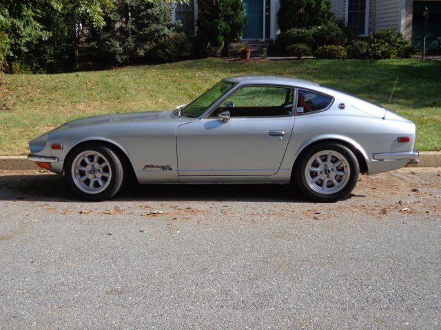

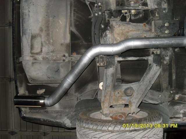

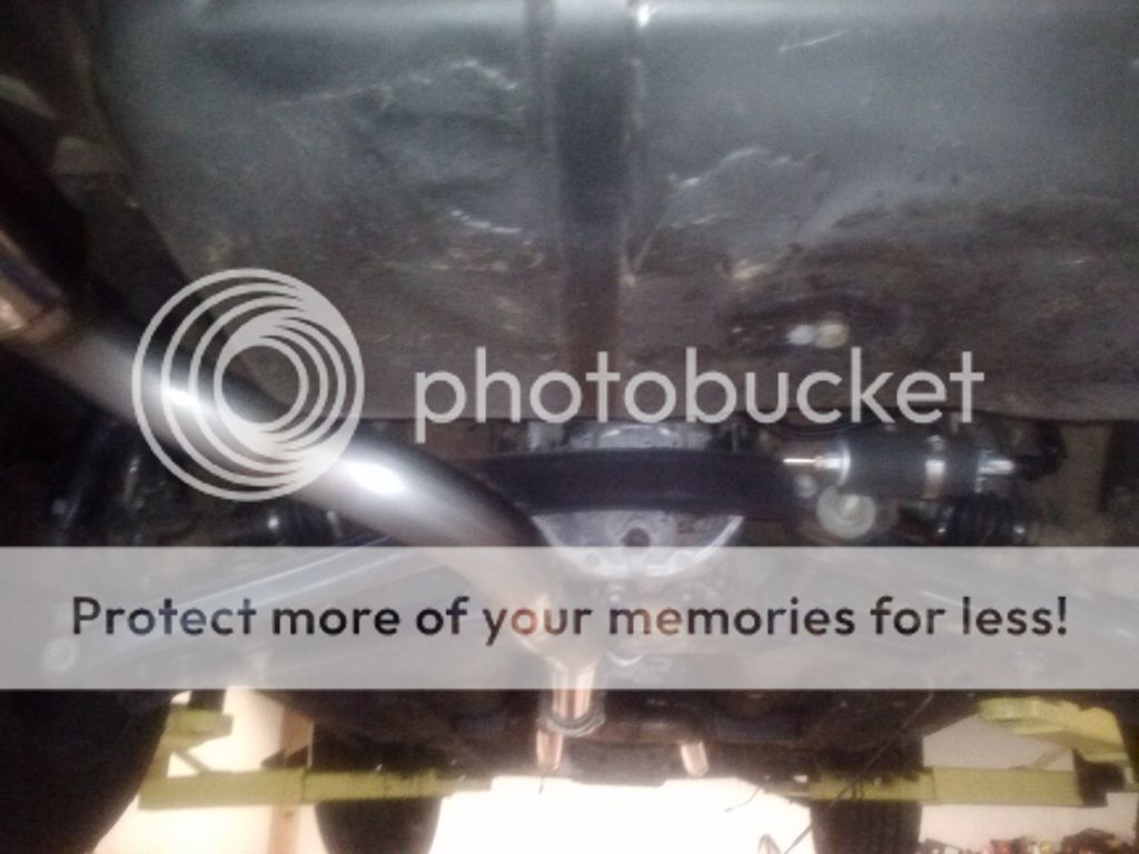

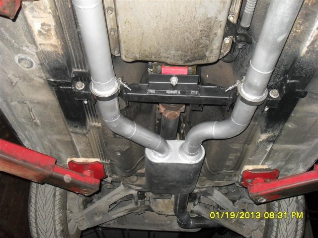

Hi guys,
New to the Z world, I just bought this car from a gentleman in Illinois.  Seemed like he really cared about the car but had to let it go.  I'm not sure if he was a poster on this forum but he did mention it.
It's a 1975 280z.
Most of this is quoted from the seller's listing.  There's a lot more to say but here's the meat and potatoes.
1. 1999 GM LS1 from Trans Am with 118,000 miles, GM unlocked computer, PSI Conversions harness
New water pump, oil pump, timing chain, starter, rebuilt injectors (Oside Tiger), fuel pump (MSD), fuel regulator,
(Corvette regulator and filter) Sanderson ceramic coated headers, MSD plug wire with heat boots, braided AN fuel line, PSI harness,new valve cover gaskets, intake gasket, silicone intake hoses, K&N filter, LS6 converted valley cover, new starter
3” into 2.5” all stainless, tig welded exhaust with Vibrant resonator and Magna Flow muffler, all connections are V-bands.
2. Professionally rebuilt 4L60E transmission and torque convertor (less than 500 miles), OEM Camaro shifter with custom weldedand smoothed shifter box housed in trans tunnel, custom solid brass shift knob (looks like a manual),
shortened shifter, JCI drive shaft, OEM rear end. The rear suspension is stock for the most part with exception of
T3 coilovers and all poly bushings.
6. CUSTOM one-off American Racing forged wheels, model VN477, satin black 17x9 and 17x9.5
Brand new Continental Extreme DWS tires 245/45-17 front, 275/40-17 rear
Custom yellow “continental” tire letters
Technotoy Tuning coil overs (front and rear), front lower control arms, TC rods, triangulated front strut bar (not installed)
SilverMine Motors Wilwood brake conversion, front and rear, powdercoated red
Wilwood master cylinder and proportioning valve
Technotoy front camber plates

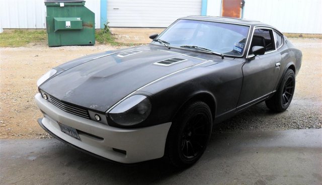

1977 280z
Donor Car 1999 Camaro LS1 T56
Hawks Weld-in Engine and Trans Mounts
Stock Block and Heads
CX Racing Longtubes with a lot of time beating , banging, cutting, welding to make fit
3" Header collectors to Y Pipe to single 3" out the back
Hawks Sinister Cam Kit (cam, springs, retainers, pushrods)
Fitech LS Ultimate Kit Including:
Aluminum Intake, Fuel Rails, Injectors, Throttle Body, Sensors, and obviously the computer and wiring
Champion 2 Core Radiator w/ Spal Fans
Shortened Camaro Aluminum Driveshaft, JTR Pinion Flange adapter for 3130 U joint on the rear
Stock R180 Diff, welded (yeah I know...its gonna blow someday)
Puny 215 tires, mostly to save the diff.  The tires in the pick have been replaced, Im not drag racing on dry rotted carcasses of a tire lol
Best 8th so far is 8.2 at 91mph with a soft launch to save the rear ~2.0 60ft.
8th Mile
