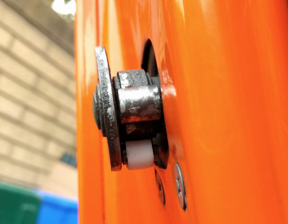

The door has a little round cylinder with two 'bumps' on it, about 90* apart. The lower one (pointing towards the ground) hits first on the body latch, causing the cylinder to rotate and pushing the second 'bump' around/into the latch on the body. Seams to me that the past 30 years of closing the door had worn down the metal so much that the second 'bump' wasn't rolling into it's proper spot, as it was hitting the 'point' where the cutout starts. I simply ground back the little radius with a dremel and WOW! The doors close like a new car! I don't know if this is any help to anyone, but I thought it was worth posting anyway.. I'll try to get a pic to describe what I've done..
Hi datsunlover:
Just an interesting side note:
That first "bump" on the "latch" when new (at least on the 72 240-Z) - had a nylon sleeve on it (kind of a horse shoe shape). Over time, they either wear out or get brittle with age - crack and fall off.
At one point I attempted to find a plastics shop - that could reproduce the nylon sleeve ... but the cost of the molds needed for injection molding were just too high. In the process of attempting to remove that nylon sleeve from the one good latch I had, we managed to break the original sleeve.
After that nylon bumper falls off - then the metal to metal contact between the latch and the catch start to take effect. At any rate, your solution should work fine...

Ok, so if you know what the door piece looks like (rotating cylinder with two bumps on it) you can figure out the first one hits the area marked in blue. This causes the cylinder to rotate, 'rolling' the second bump into the small radius, and latching the door closed.
The yellow line points to the spot where mine was hitting, and causing that 'clunk' sound. This point was actually smashed really bad from years of abuse, and took a small amount of grinding to fix the peand/mushroomed metal.
I then realized the root of the problem; The area marked in blue had been worn over the years and was not in the correct position anymore to allow full rotation of the door cylinder. (well, I guess the door piece could be slightly worn too.. seames to be stronger metal though..) So I used the dremel tool with a small grinding stone to grind back the area in red.. about 1/16" in the end. I just took a bit off at a time, blended it in to the original rad, and closed the door till I didn't hear/feel it hitting.
Posted Image
I assume that the 3 or more body jobs this car had over the years didn't help, and a lot of folks probly tried to adjust the latch mechanism but did a poor job, or gave up and just slammed them. At one point I peared into the door while trying to close it and saw that even though it was hitting, you could still get the door to close.. it just took a lot of force, and would actually move the whole door UP as it scraped in to place, before finally latching. I feel like a fool for not realizing this sooner, but oh well.. live and learn. Hope this helps. :)
This writeup is right on the mark. I have a 240Z with NEW striker plates and had to slam the drivers door many times to get it to fully latch. Used this article to trim the area in Red which is absolutely right. Took striker completely off and hand mated it to the door cylinder. Found that absolutely the area in Red needs to be cut back to clear the second button on the door cylinder. Also discovered that the first tab on the striker plate is TOO TALL and must be trimmed down. NOW after trimming the area in Red and the first tab, check final fit to door cylinder with striker plate against the two button door cylinder. When it bottoms properly and fit is proper then reassemble to door jam and carefully adjust. Then the door should shut much more positively. Did all of this and drivers door shuts much much better. Will do some fine tuning today. Then will rework the passengers door striker plate.

Seems to me that extending the area in Blue OUT will do the same thing the missing nylon piece was suppose to do: Trip the latch mechanisim before the back hits the area in red.

I know this sounds ghetto but you can also use some duck tape, just cut a very skinny piece about 5" long and rap it very tightly around the area the nylon piece went. worked great for me, shuts and opens like new.

Or, you can but a new latch plate!... I bought one from MSA for ~$18... solved the problem and the part was an original nissan part.

I followed this griding advice on my z, it made it worse. Luckily, I had a spare latch to put on. I haven't seen the nylon insert, does anyone have a photo of the latch with the insert?

Yea you can only grind so much..The best thing to do is probably find something to replace the nylon or just buy a new latch all together.
