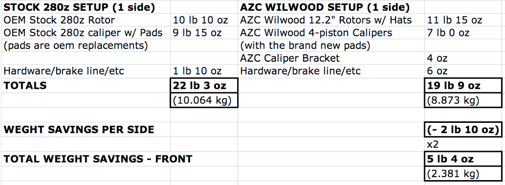

And, for you drag racers and autocrossers, the stock Z brakes are lighter then anything else you can put on the car!
Sorry John, gonna have to disagree with you on this 1...
I just recently bought the front Wilwood 4-piston setup from Arizona Z Car.
I weighed all parts on a digital scale: stock vs Wilwood setup.
I know it's not much of a difference in weight, but the Wilwood setup actually comes in weighing 2 lb 10 oz lighter per side! or 5 lb 4 oz total savings! And this was using used stock rotors that I'm sure have been turned down plenty of times as well that have been used for 30 years and with new OEM replacement pads.
Here's the breakdown of what was weighed - FRONT BRAKES ONLY:
Posted Image
280z hubs were not weighed in factor, due to the fact that you use them for both setups. so no weight differences there.
