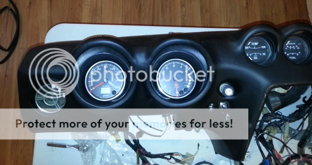

Re-installing the SpeedHut Speedo and Tach. I did have them wedged in the original pods and "bonded" with RTV. One of them fell out when I took the dash out so I decided to change plans. This time I'm installing them in the original metal housings with spacers made from 4" PVC pipe hold them in place. Here are a few pictures showing the process.  I realized I trashed the odd-shaped filler piece from the original gauge.  I'm not yet sure what, if anything I'm going to put in it's place.  I'm going to paint all the non-black parts, flat black so they shouldn't be too noticable set way down in the dash....although it sure would suck to put all this back together and have it bug me.
You can see the 4" PVC pipe section in this picture.  The way I did this mod, the length only needs to be long enough to cover the little housing screws that hold the plastic shroud onto the metal housing.  I believe I cut the length to 1.25".  Just long enough to engage the side housing screws plus a little edge distance and short enough to avoid interference with the plastic shroud internal lip.  This picture doesn't show the pipe positioned correctly.
Here is the 1.25" long 4" PVC pipe.  It was too tight in the housing (that's what she said :P) so I split the ring with my table saw. The blade kerf was just enough so that it fits nice and snug inside the housing and around the Speedhut gauge diameter.
Here you can see where I ground down the side screw hole edges so the PVC can slide in easily.
Once everything is was cut I pre-assembled the parts, positioned the gauge and marked the side screw hole locations on the PVC pipe section.  Then remove the pipe and drilled out the match marked holes to to the same diameter as the side screws.  Once the screws are installed the PVC pipe is held in position and gauge captured between the plastic shroud and PVC ring.  I'll apply RTV to the back to keep the gauge from spinning and rattling in the hole.

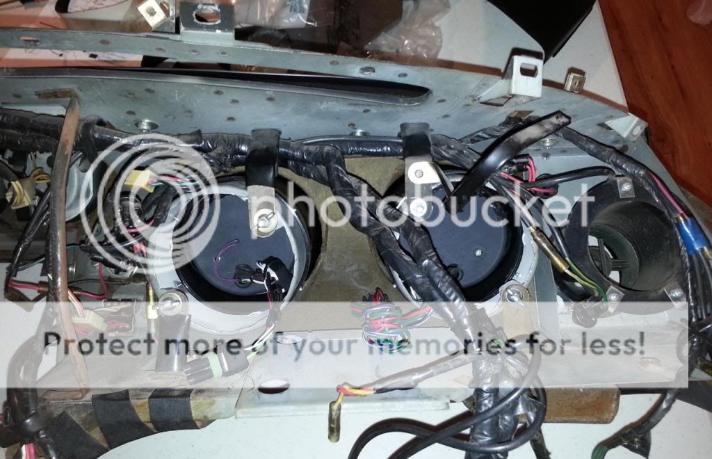

Did I mention that I'm installing 2-5/8" Speedhut gauges in the stock gauge locations? Yep!  Here is a picture from the backside.  I'm using 3 clock gauge housing for each location.  The other gauge housings won't (easily) work for this mod. In the picture you can see how I cut out the backside to allow the Speedhut wires to pass thru.
To mount the gauges in the housings, I cut the stock thin sheet metal faceplate to 2-5/8" and clamped the gauge in place with the Speedhut provided lockring and spacer.  The pictures are pretty self-explanatory. I had tossed out the faceplate from the gauge that came with my car so I had to mod the one from another gauge.  The other gauge faceplates are raised so I cut part of the raised section off (had to figure out the correct length so it would lay flat at the correct diameter), split remaining part with my dremel cut-off blade then hammered the plate flat.  The hole in the faceplate doesn't have to be precise, just small enough to clamp onto.  It was a pain in the ass but it worked.
