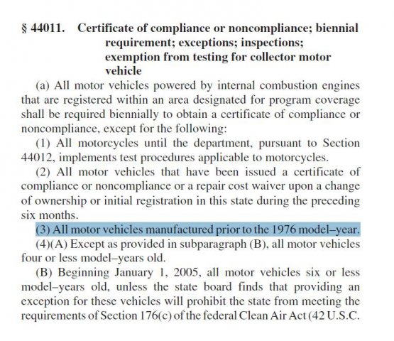

Not to muddy the waters too much on such a good thread, but this discussion also applies to 1975 and older cars imported into California from overseas. Ask me, I know from personal experiance. The DMV will not flag the car for smog inspection if it is 1975 or older. So you can register your 1972 Hakosuka, but if the CHP flag it for emissions compliance, or someone rats you out, you will have to take the car to the REF to get the registration and ticket cleared. Once the REF sees the triple carbs and non-US engine block, you are sunk. Only way out is to swap in a US engine and emissions equipment and have the car get a BAR engine swap sticker.
