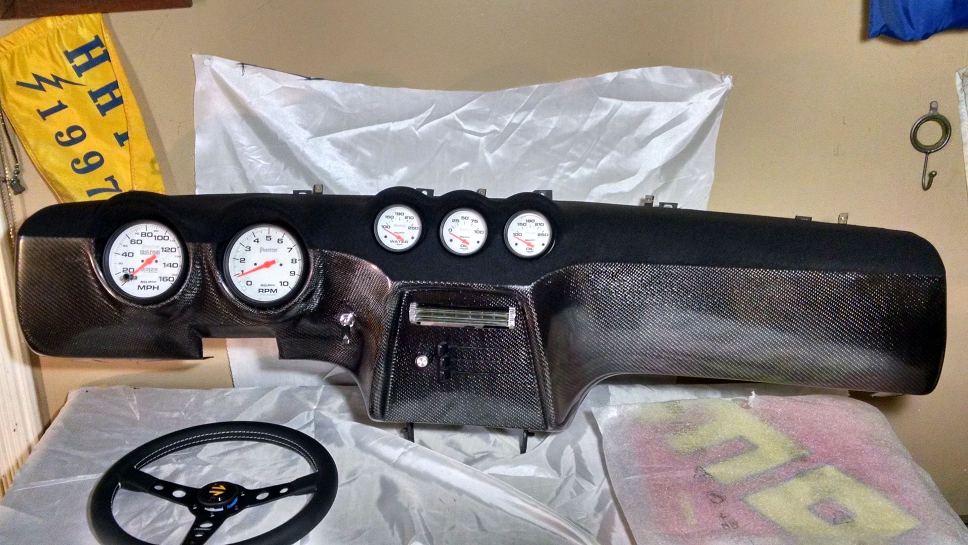

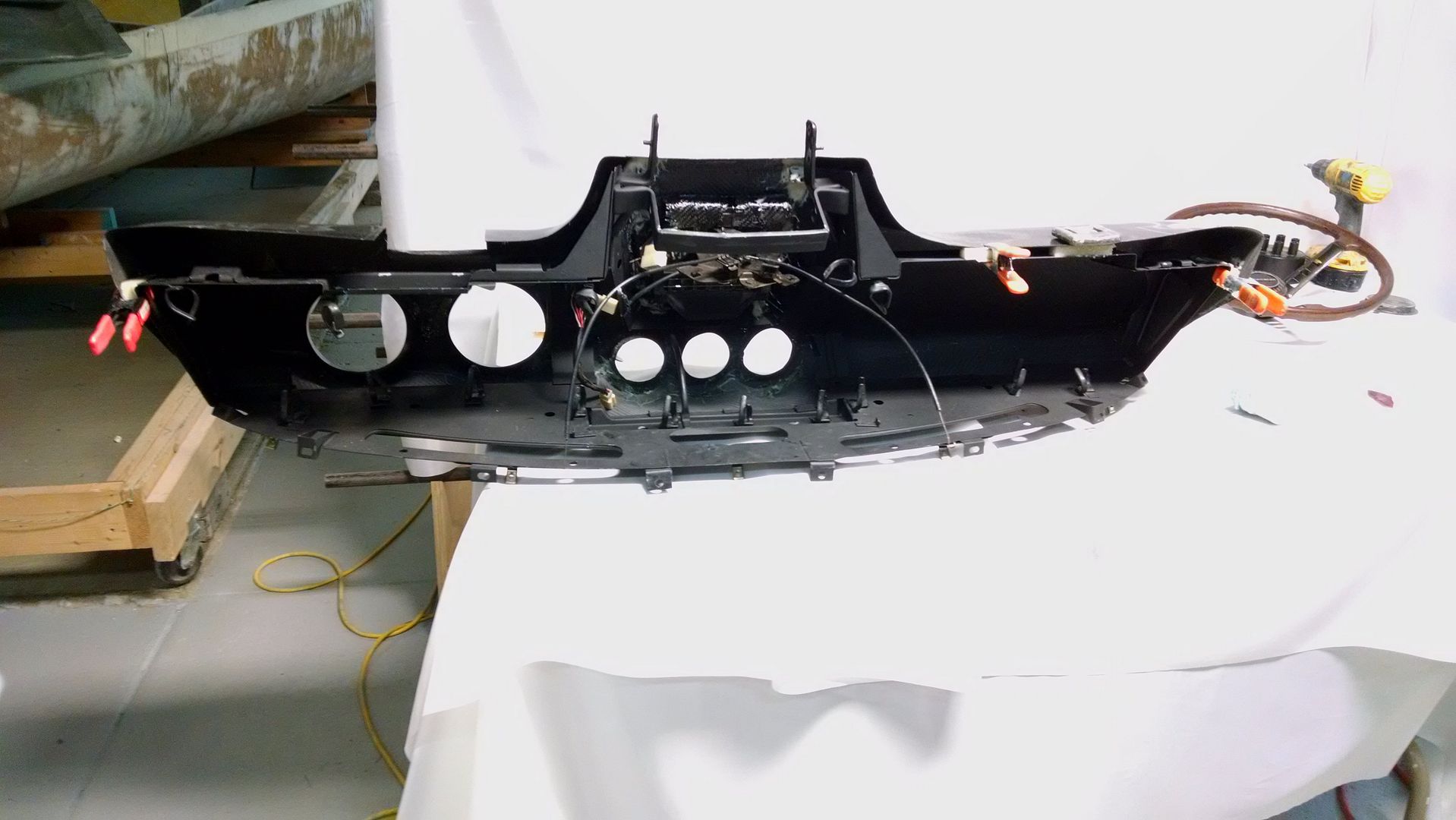

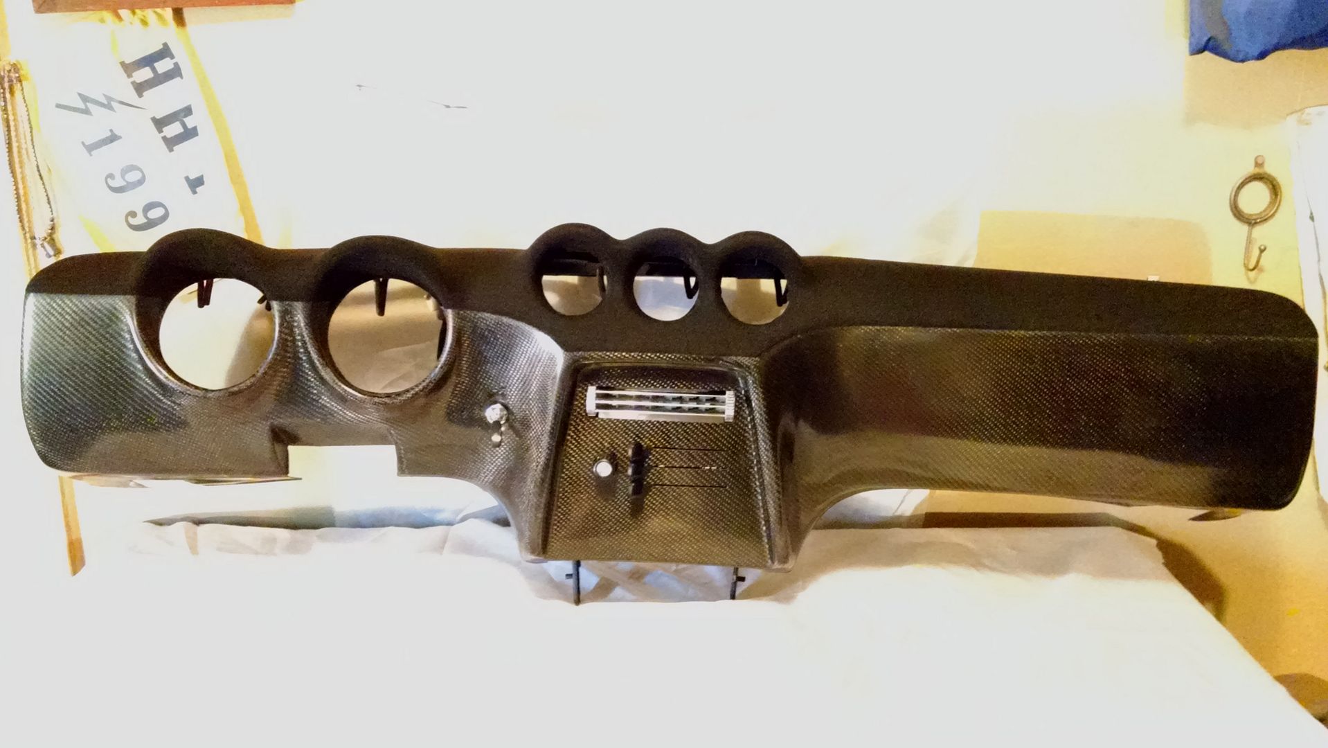

So in between plow sessions I've made some serious progress on the 240.

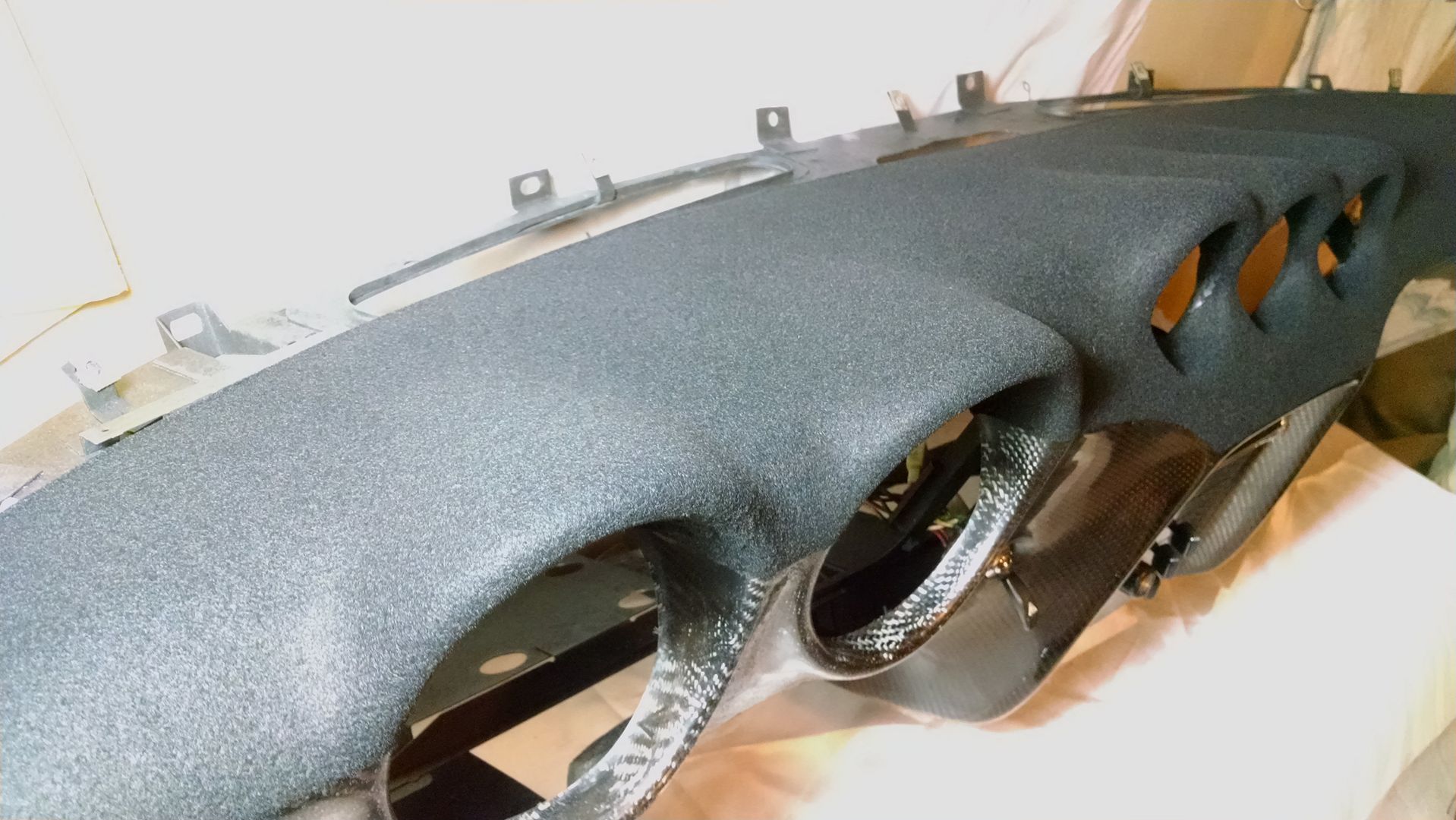

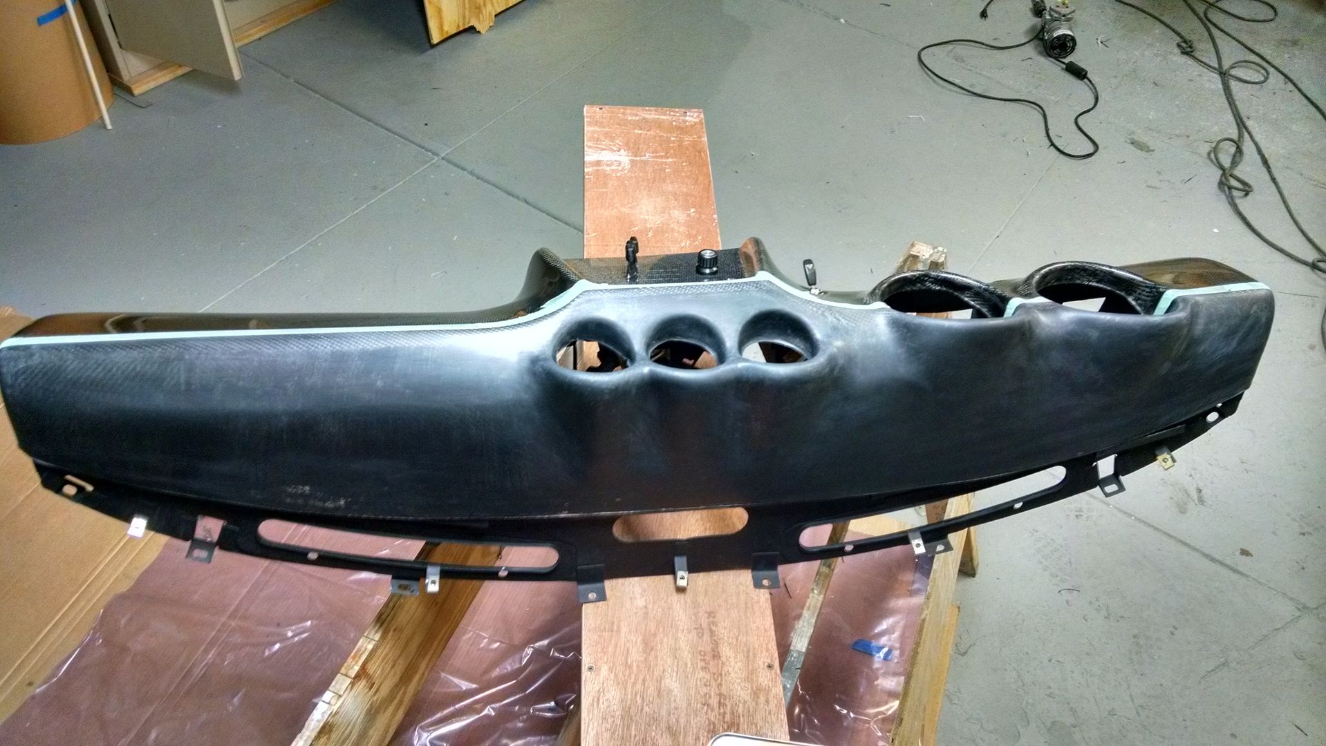

Today is D-Day. The day the dash goes in.
Rewrapped, and "tidied" up. :D   Ready for the dash.
But not before I, once again, make my mark. It will hopefully be some time before I sign this again.
A shit ton of expletives, and about 4 hours, later.....
a little teaser.
Gauges are functioning, the heater blower works, as do the cables controlling the air flow and temperature. I think it's safe to call the project a success.
Lots more to do, but I'm feeling good.
More tomorrow fo sho.

Dash looks great!
Barring anything unforeseen, it's really looking like you will have the car on the road this summer!  Are there any tracks for drag racing or club nights for autox or something down around there?  Might be fun to get a mini meet going with the Rochester guys.

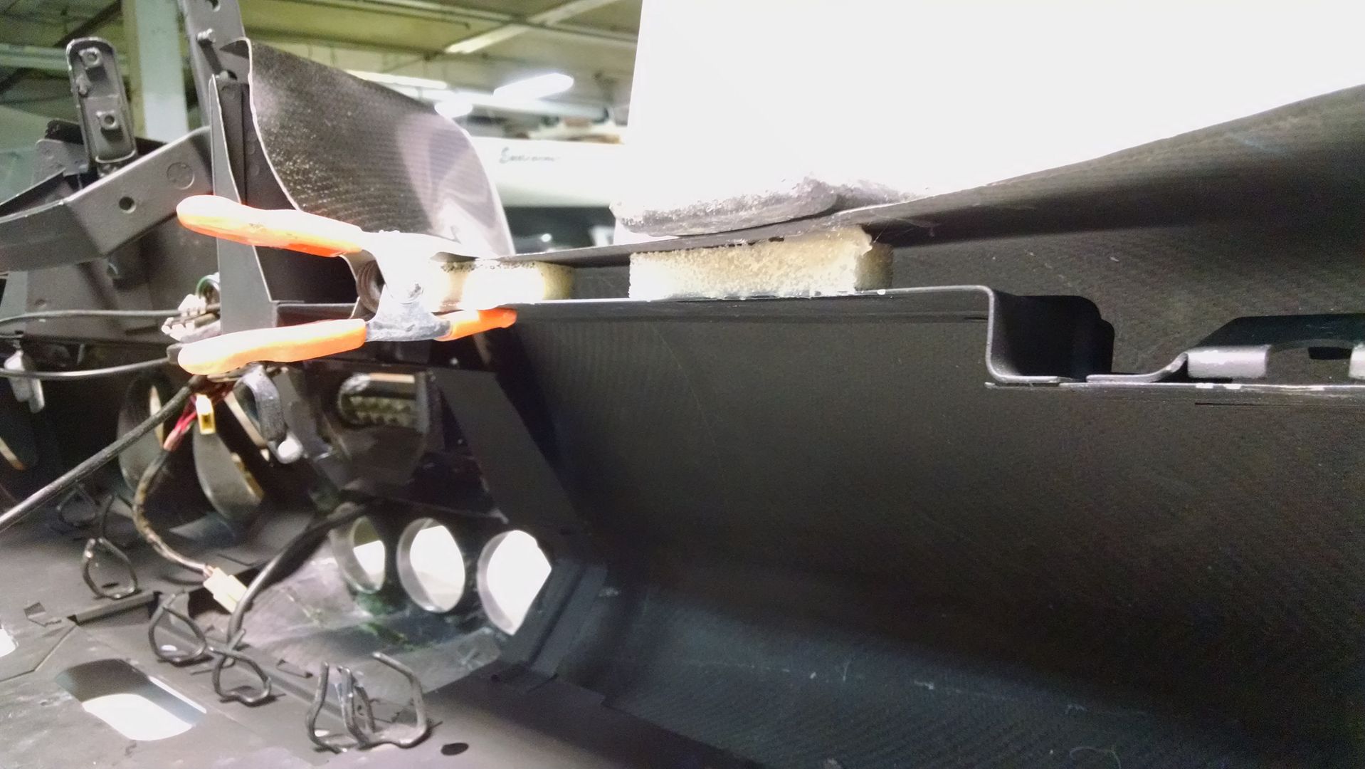

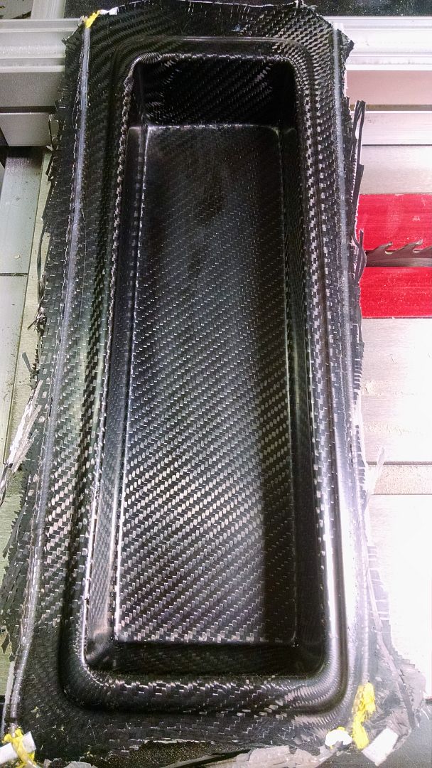

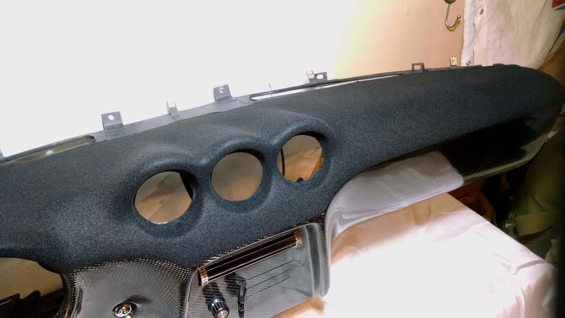

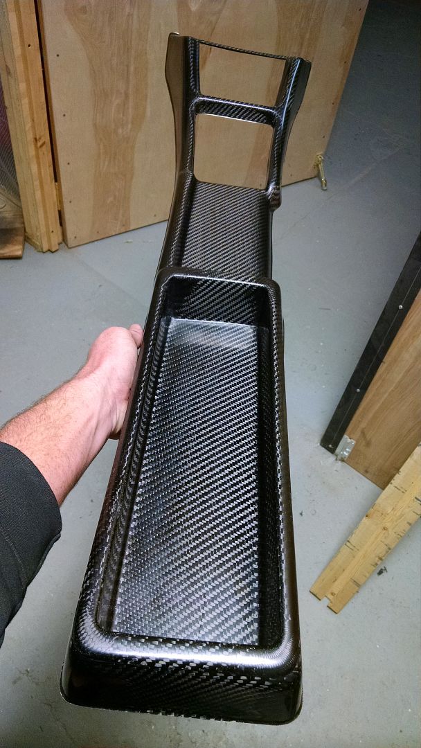

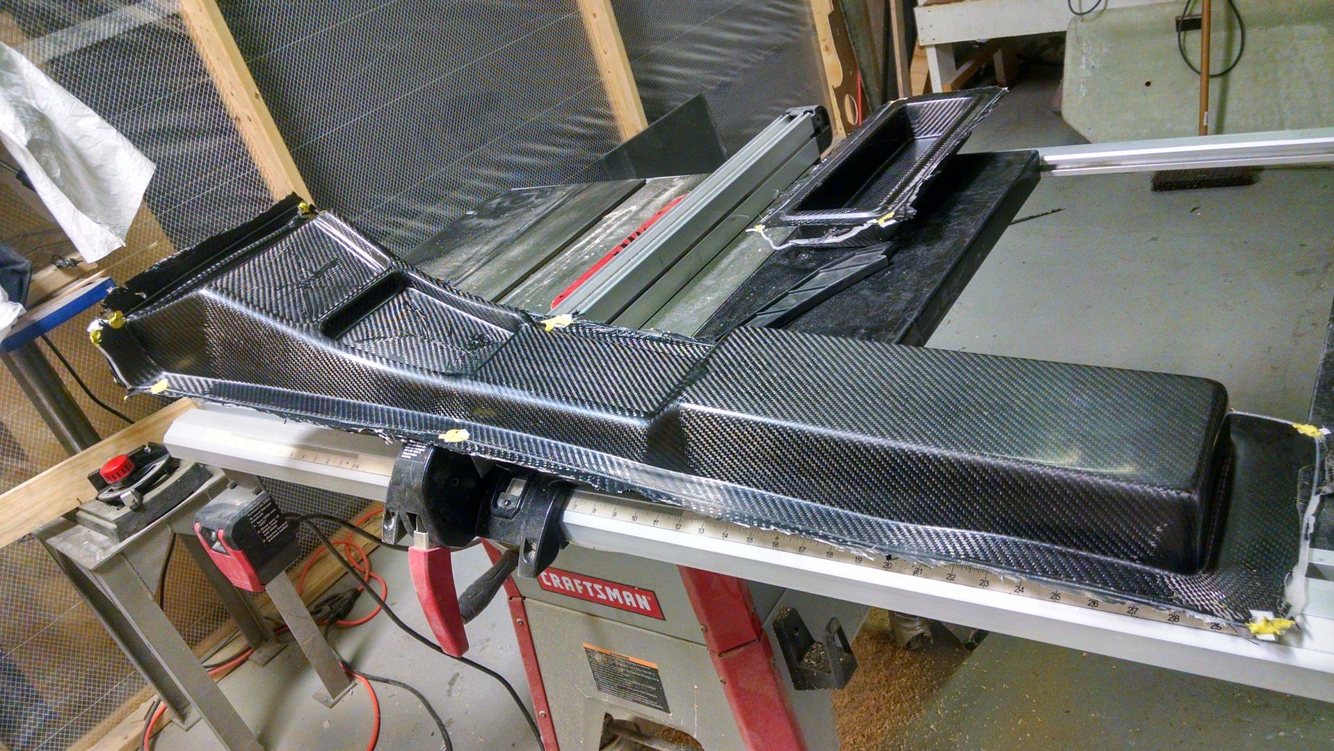

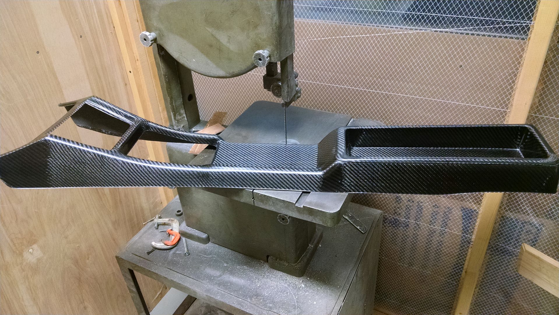

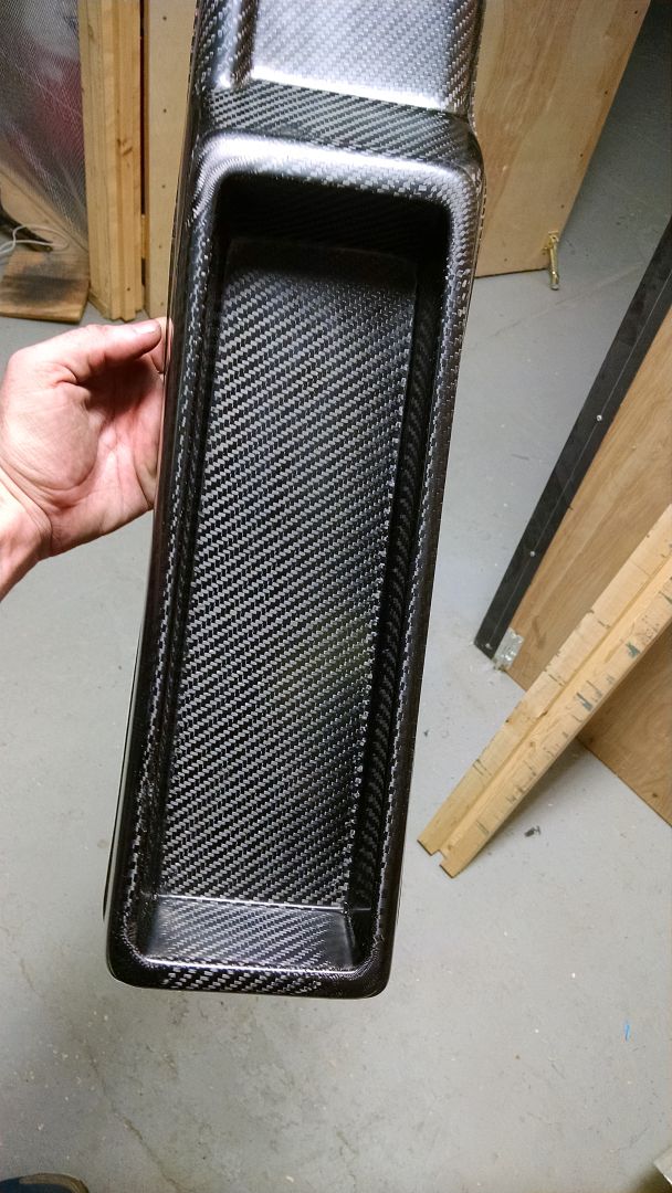

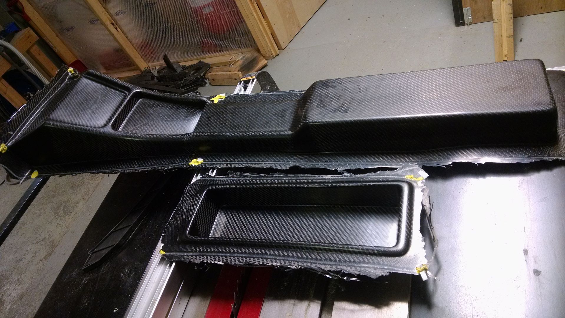

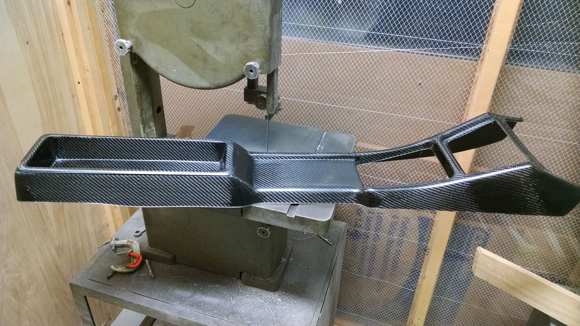

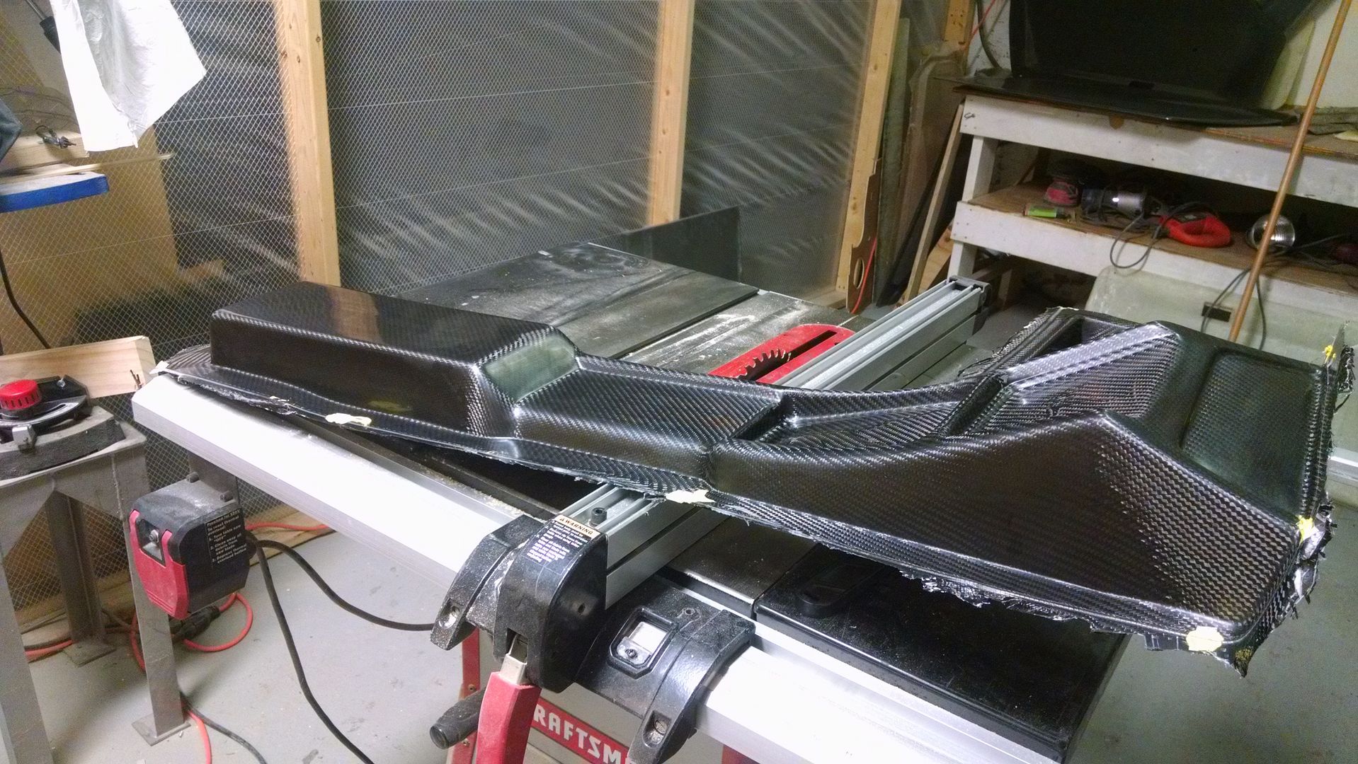

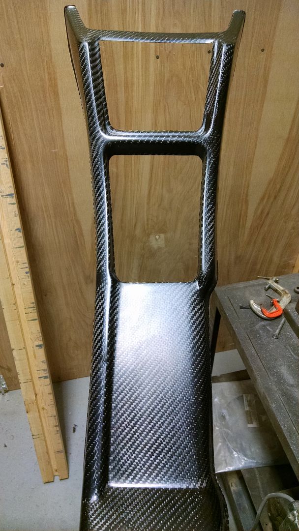

Quick batch of updated pictures, while I'm taking a short break from working. Slowly finalizing things. Tucking remaining wires, and lots of time consuming tedious things...
I'll be chopping the center console and fitting the fuse box cover with its components soon. Probably next step...

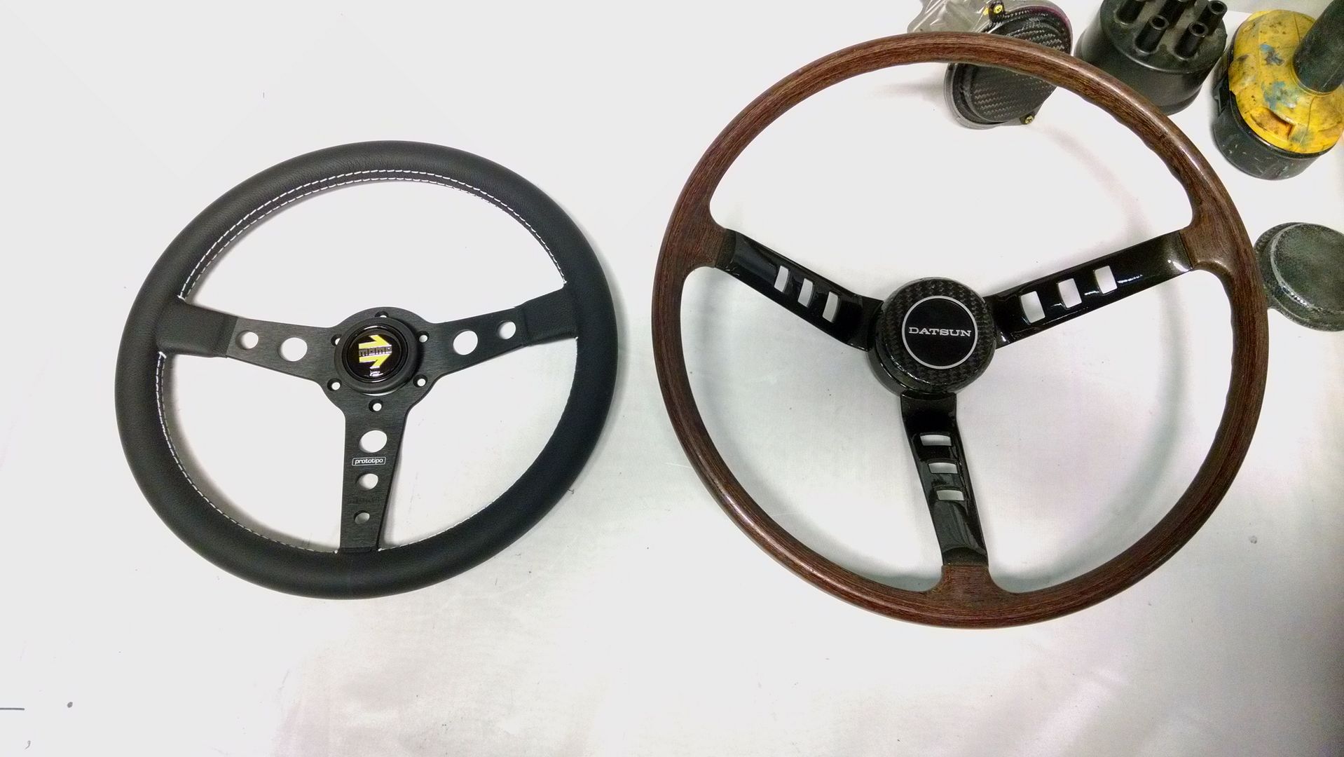

Once you wire your horn in, the steering wheel won't be removable, correct? If you're interested in keeping it removable I have some pictures and CAD files you might be interested in. We have the NRG 2.0 release in our racecar, and I 3D printed a piece to go in the wheel hub that allows us to use the horn wiring as a PTT circuit while keeping the wheel removable. It would be simple to make that work for your horn.
Share this post
Wow! that sounds incredible! I'd love to take a look at the files. Anything you're willing to provide would be thoroughly appreciated. Thanks!

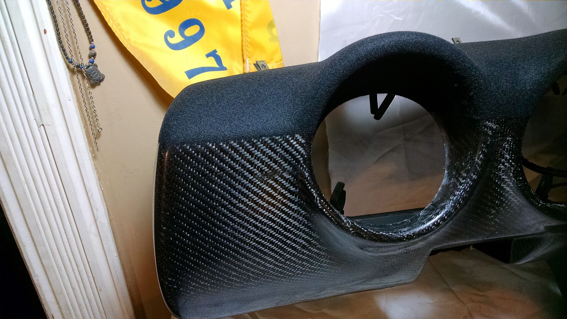

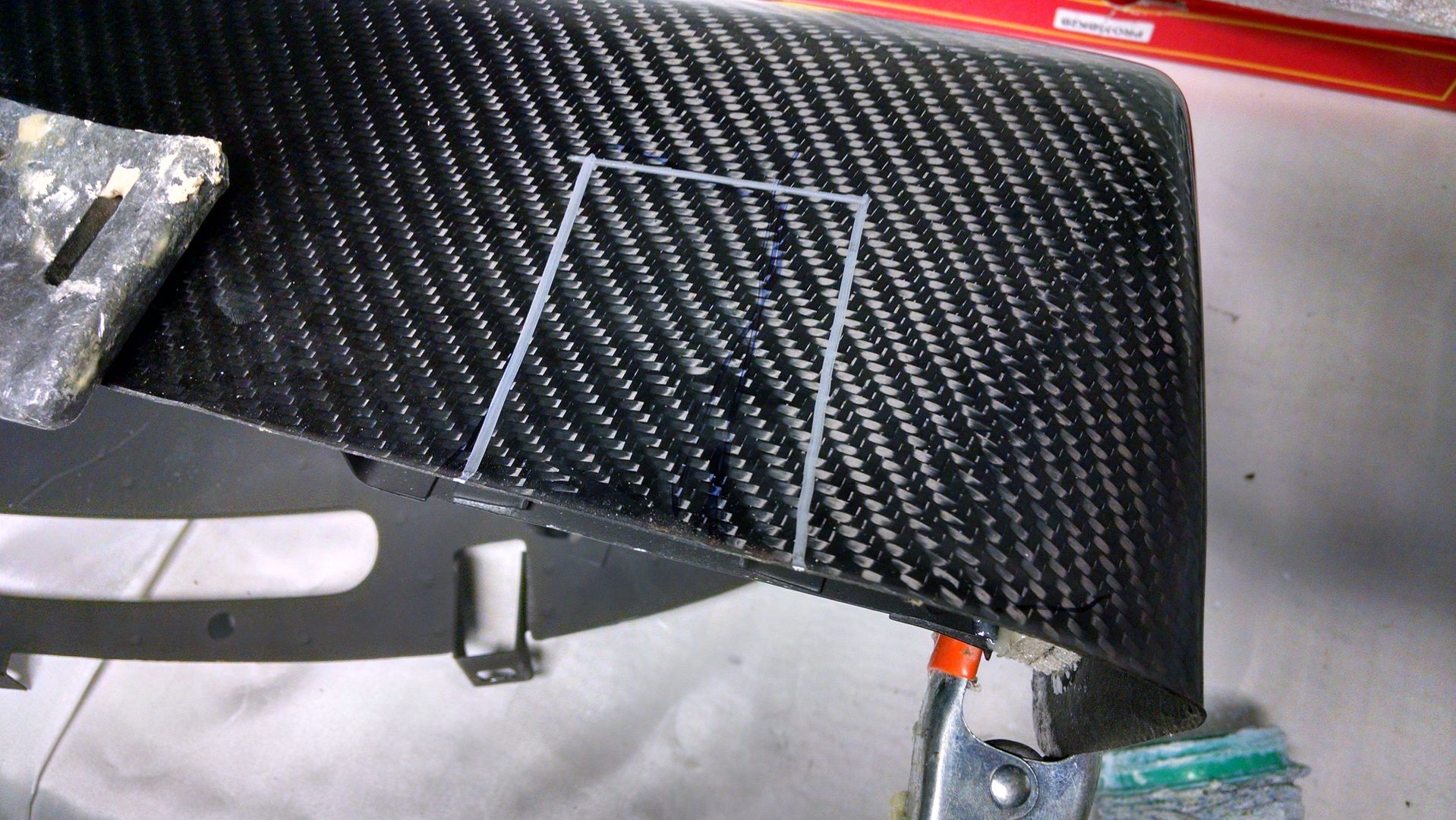

More progress....
 Drilling holes in virgin carbon.
Proportioning valve hole
I'm going to eventually make a little shift boot for the valve body.

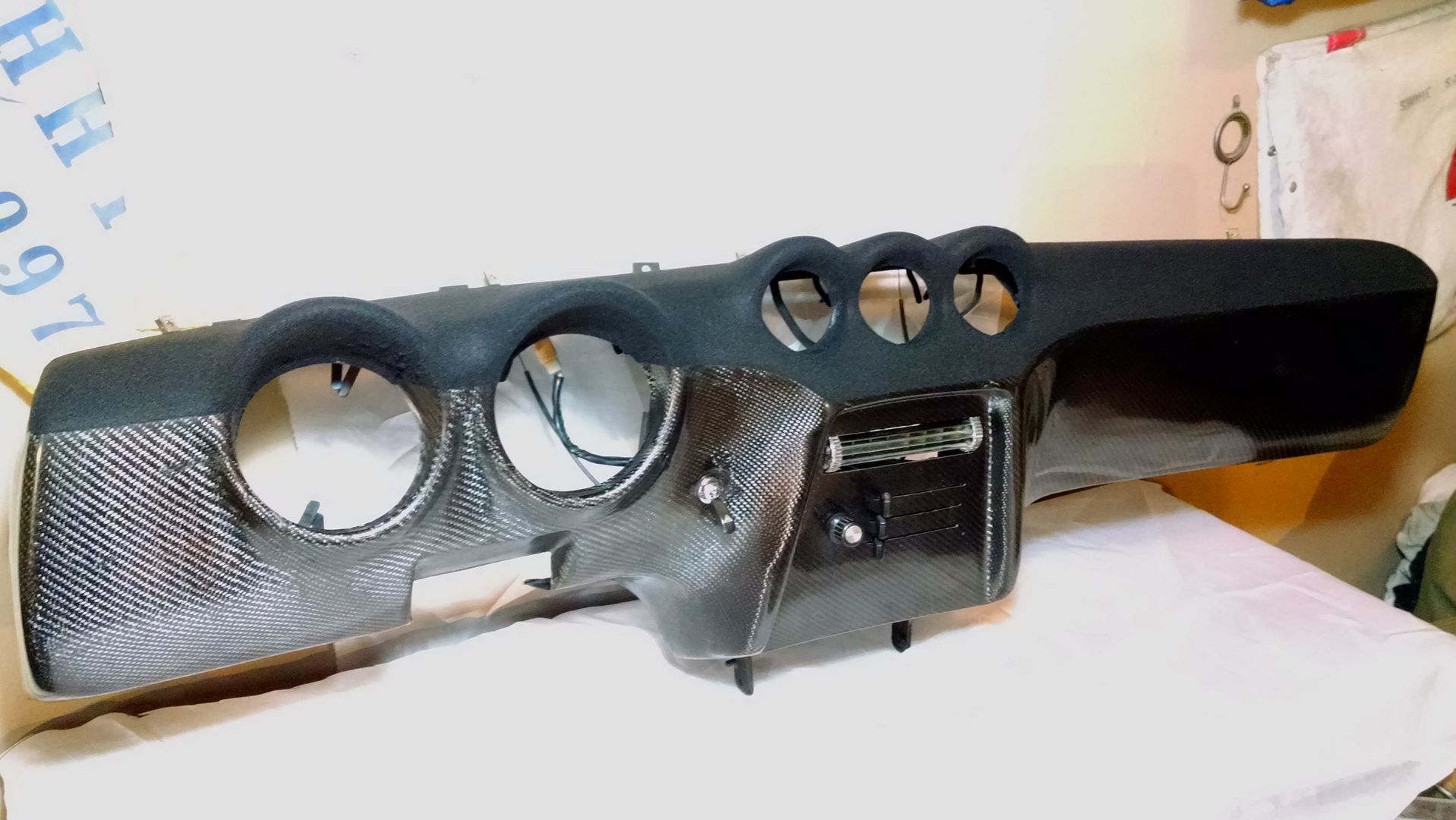

Blinker indicators relocated
-Working- Hazards
And where my GPS speedometer sensor is going to be mounted. I'm going to notch the vent piece where the wire exits, and with the fender welting I plan on using should make for a clean install.....hopefully. :D
Getting there. Making progress every day.

First picture is all the pieces I used. It was basically a prototype that ended up working well, so I kept it. You would only need the stuff on the right of the picture since you have a horn button to fill the space in the center of the wheel.
The springs and bearing balls go in the cylinders of the piece in the upper right. Balls make contact with the nubs in the quick release, and the wire ends are held to the square nuts in the other piece that is pressed on top. I think for you I would just integrate the nuts into the lower piece.
Second picture is everything pressed together. Third picture is how the bottom of the hub looks with the piece inserted. Fourth pic is the assembled wheel(minus two screws).
Do you know if your hub is the 2.0? If it is, I could just put one of the modified pieces together and mail it to you. I have extra pieces because the springs come in packs of 10 and the balls packs of 100. Actually, the hubs probably have all the same center bores, so it might work for any NRG quick release.
That's awesome, very clever work! Let me investigate my situation a little bit and, if needed, I would gladly throw you some money for one of those parts.
To add, I think if you have one of the nice, modern horn buttons you won't need any of this. They should be designed to work with a removable hub. If you're using an old school button I don't think that's the case.
That's what I need to confirm. Thanks so much for the input.

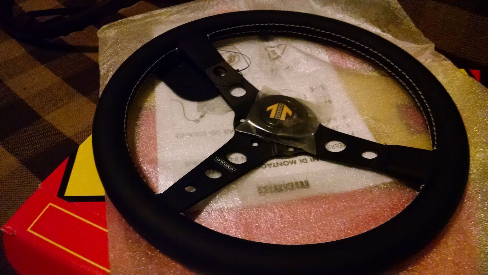

Waited three weeks for this to come from the United Kingdom.
Totally worth it. :)
Before
So much better.
I'll also be ordering a shift boot, and emergency brake boot to match.

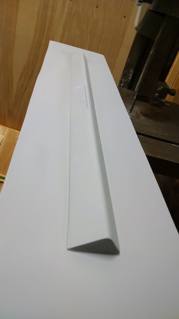

15' classic Dhow design, made out of advanced materials, like carbon, aramid, and high density closed cell foam. The rudder, daggerboard, mast - and lateen rig are all made out of carbon.
I have about 150 hours into the bottom of this. Priming, blocking, repriming, blocking....etc...not to mention building the thing from scratch. My business partner and I have a lot of time in this little lady...that's for sure.
Enter: The best PPG paint money can buy. DBC basecoat, DCU clear. Two grand in materials there.
Color is Ferrari "azzurro" blue.
You can almost make out my Steve Irwin shirt.
(blame flickr for the last three being smaller. Not sure why that is...)
Next is to flip it, and paint the deck and the interior.
