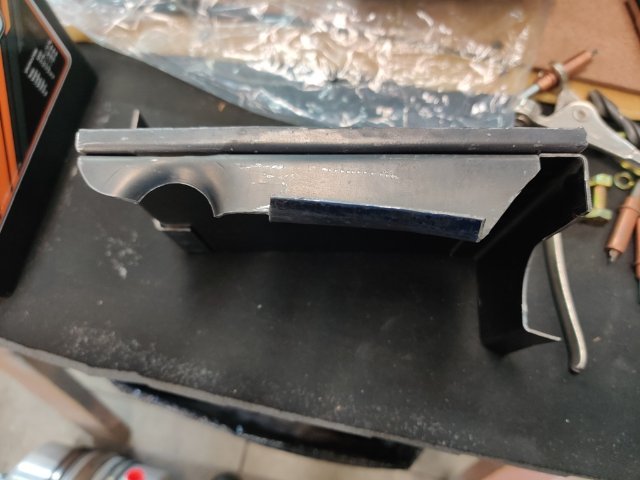

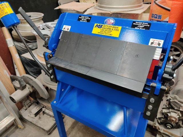

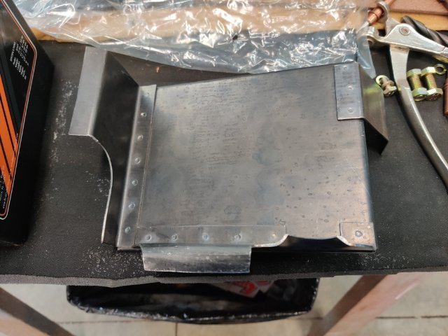

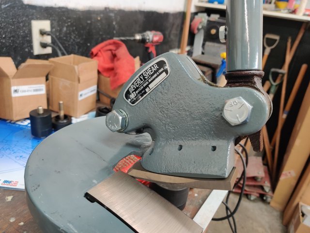

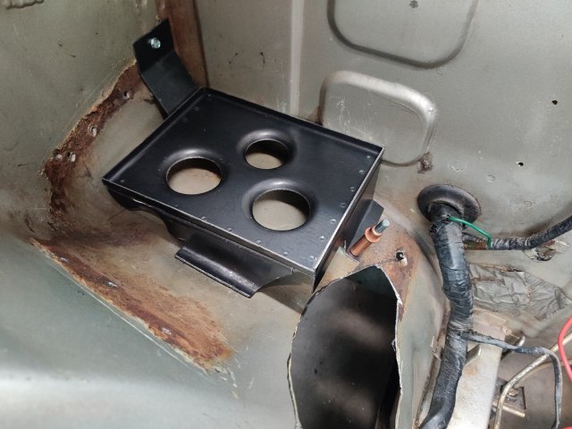

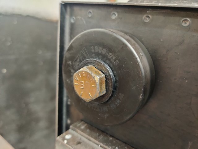

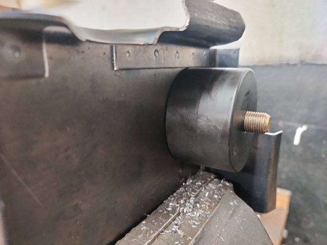

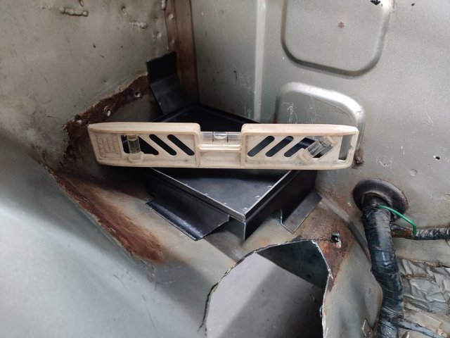

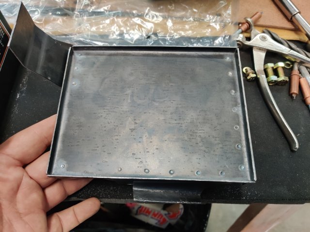

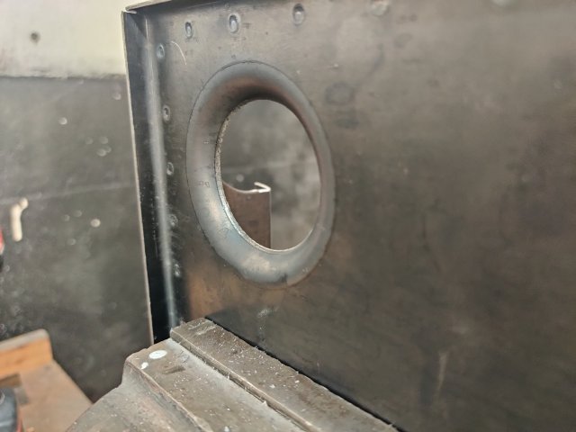

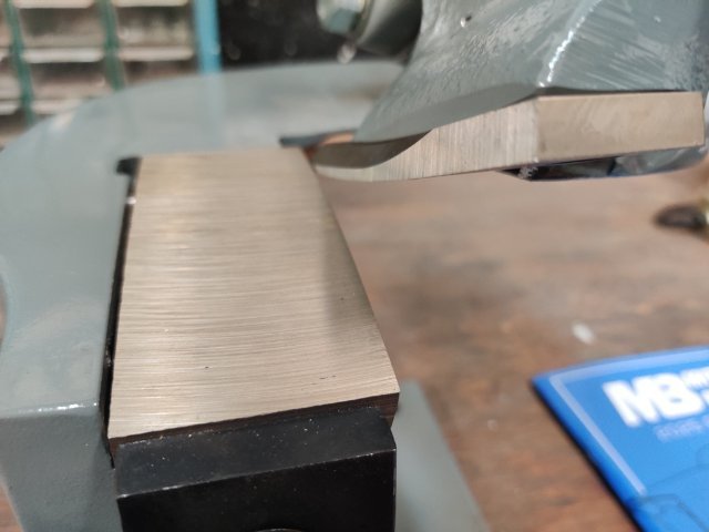

After several weeks of various distractions, I was able to commit a bunch of hours to working on the "track car" this weekend. I recently purchased some nice tools to make fabrication projects easier. Here are some pics of tools: And with those on hand, I was able to make a nice battery tray for the new Braille battery. The spot welder I bought several years ago was awesome to use as well. I, am very happy with how this part came out, even if it did take me about 9 hours to make it (!) I still have to design a battery clamp down mechanism to hold the battery to this new tray, so I will work on that soon. With the battery tray temporarily in place, I again mounted the dry sump tank, and started figuring out all the fittings I will need for the lines for the dry sump system. I plan to order those soon and then mock up some hoses.
