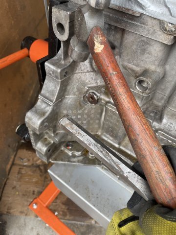

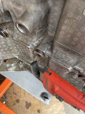

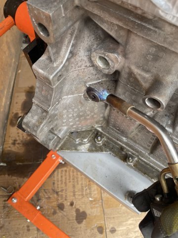

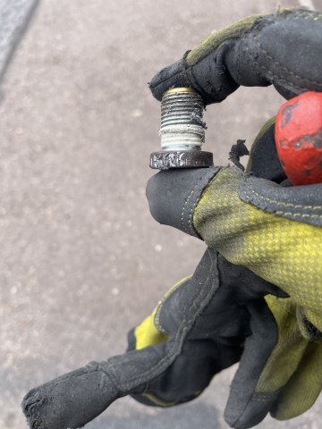

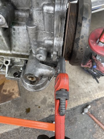

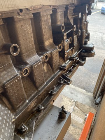

Today was a cold snap, but I managed to get a job done I have not been enthusiastic about doing..... removing the oil screw in plugs from the block. Metal plugs in an aluminum block and have been in there for 19 years. I had to use a pipe wrench, hammer, hex wrench, PB Blaster, a MAPP gas torch, and a cold chisel. I found that the cold chisel is the most effective at getting them loose and off, but it will take several cycles of PB blaster , spraying it where the bolt face touches the block and letting it seep in, and then MAPP gas (2000 degree F or close to it, maybe more) held around the bolt to heat up the aluminum and get it to expand, then hitting the head of the bolt a few times hard with the hammer, and then putting the chisel on an angle and beating on it with a hammer to shock it loose and turn it. These bolts are M16X1.5 thread, with the exception of the bolt facing the side at the oil filter. The bolt facing straight ahead is the same size, M16X1.5 but the one to the side where the sensor normally is..... is a coarse thread bolt, M16X2.0 thread. I have ordered brass plugs from Auto Meter to install into each port that are drilled and tapped with a 1/8 NPT center. I will put brass plugs in #1-3, #4 is for the oiling system re-route from the front facing port at the oil filter, number #5, the last port on the block at the very end is for Turbo oiling feed. The side port at the oil filter, the bolt will be drilled out in the center and tapped to 1/8 NPT so I can use it for an oil psi gauge. Sure feels good to have this done. In the pics you can see how the factory really gooped up the threads when they installed them. Pics follow. Cheers!
