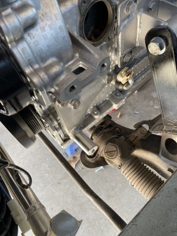

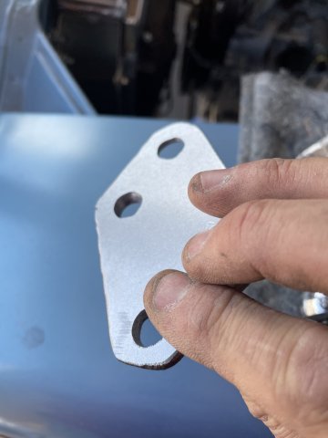

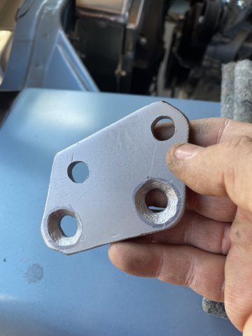

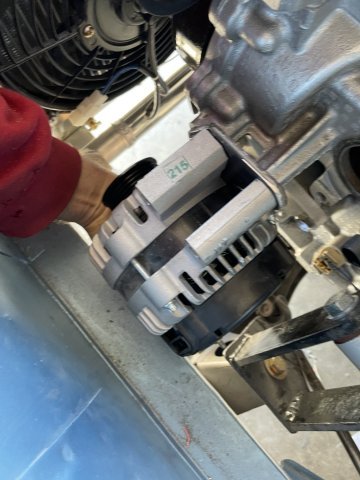

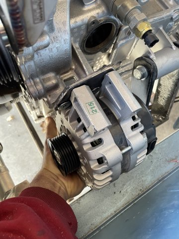

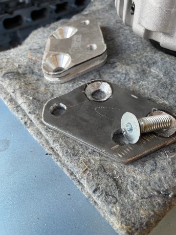

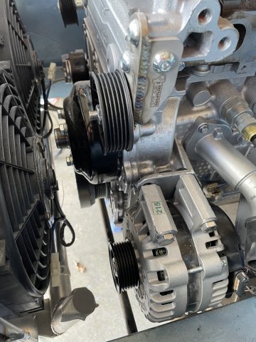

03-14-2026 ATLAS Z UPDATE: Since the intake was off, I went ahead and tackled the project I have been putting off. Modifying the Atlas Industries alternator bracket setup to work on my project. the mounting plate is 1/2" thick, and the alternator just wouldn't clear the frame rail, so after trying to cut the aluminum bracket down, I gave up and traced out the bracket on a piece of 1/4" thick steel and cut it out and drilled the holes out. I then used my Dremel to counter sink the holes so I could use the bolts and everything that came with the kit. I painted the steel bracket with silver engine block paint and the bottom bracket I had to trim 1/4" off of it. Then I was able to install he alternator (brand new AC Delco, nice unit), and then on to the fun part.....belt alignment. Using a straight edge, I had to keep working little by little shaving aluminum off the provided spacer and then lightly grinding the back of the nylon pulley and it turned out great! Then I went ahead and installed the fittings to use a 8AN line for the crankcase breather on the intake between cylinder runners 3 and 4, and I found that by leaving it black it is hidden and you cant see it, so that worked out better than I had planned. once the intake was tightened all down, it was time to finish the intercooler piping. The driver's side was VERY tight. I used two 90 degree sections and trial and error and cutting them down I was able to come up with a decent arrangement. so that piece, to be welded along with a frontal piece to weld a length on to eliminate some couplings were put together and I will take them to get them welded up then take all of the pipes to get powdercoated with the "polished aluminum" finish. I could get them polished.....but it would cost more......opinions? Lastly I put together the intake side, switching to a 4 inch coupling setup with the GM factory style MAF meter. it was 3.75 diameter, so I took some rubber strips that are adhesive on one side and ran a strip of it around the mating surface, and then I was able to tighten the hose perfect on it. I did have to use the 4 inch to 3 inch reducer on the end, as the engine has pieces sticking out that won't allow for 4" pe, etc. I have a 3" screen arriving soon which will be on the front and it should look pretty good. I will have to get inventive to add polished/chromed to it to get rid of too much black. maybe a very thin polished aluminum piece that wraps around it and can be fastened underneath? Anyway, here are some pics:

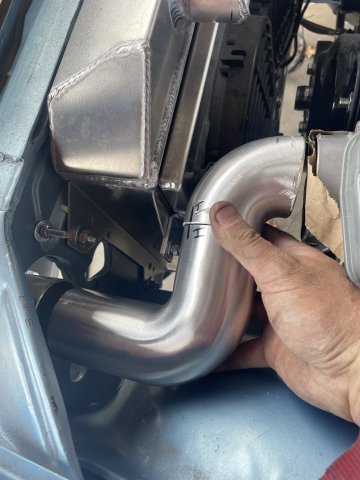

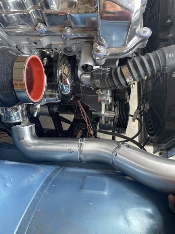

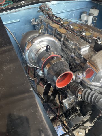

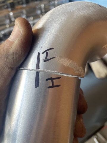

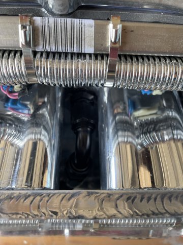

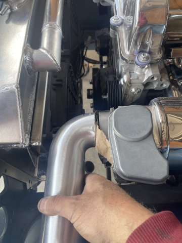

03-07-2026. ATLAS Z UPDATE: I started with the intercooler piping on the turbo side, and have it ready for welding, sanding and polishing. I got started on the intake side, but ran out of parts. Since I had to pull the intake, I enjoyed the easy access to that side of the engine, and installed my new AC Delco starter, and wired the solenoid and main batt power on it. I also was able to plug in the harness points on that side of the engine, install the crank position sensor and both knock sensors, all new GM stuff. Started on the alternator bracket modifying, much more on that to do. Feel got cold, called it a day. PICS
