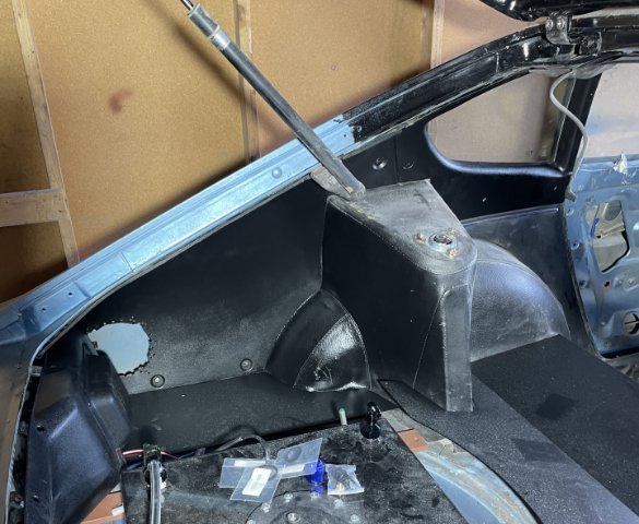

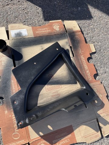

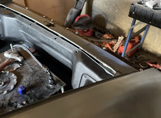

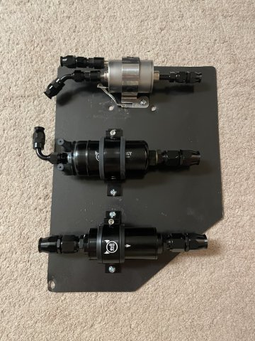

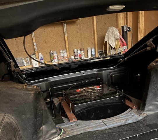

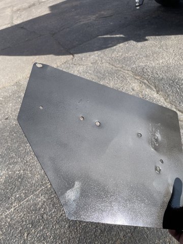

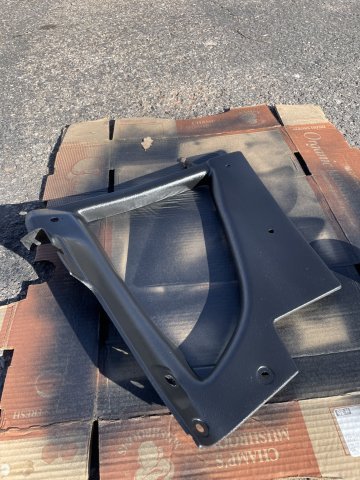

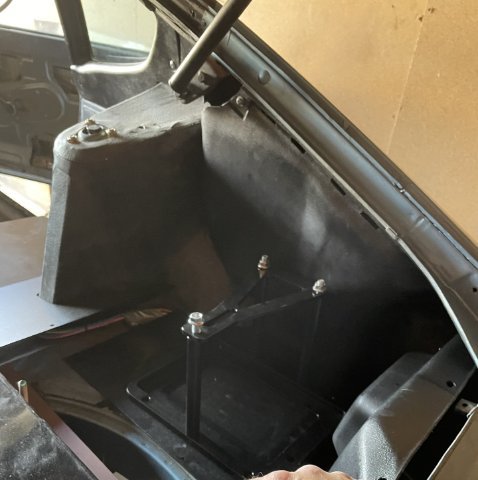

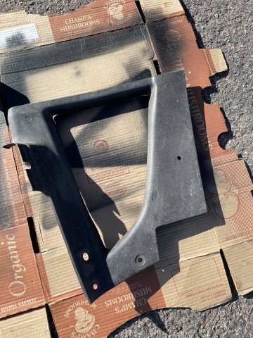

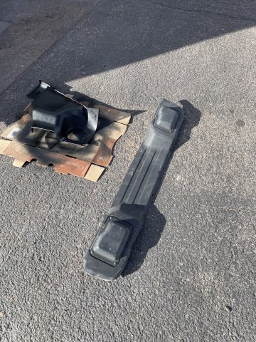

02-08-2026 UPDATE. Today I completed further work on the fuel system. It is on a sheet of metal that will be hung from the ceiling down on all thread to where the pumps are horizontal facing the floor and a tad bit lower that the fuel cell outlet so gravity flow will be good. I then took all of my interior panels I have out except he center console, and cleaned them up and painted them with SEM interior paint....Landau Black....which was referred to me years ago and really is a perfect shade and everything for these old Z cars. After they had dried, I quickly installed them a little bit, not fully, but enough for them to be in place, and then finished leveling up my fuel cell and bolted it all down. I am having some problems with the pilot bearing for the trans.....it appears I will need a sleeve or perhaps a bearing with a larger O.D. as the ATLAS, never came with a manual trans, and the well for the pilot bearing is roughly twice that of the bearing I have here that I strangely was told to use. So, I am working that problem out. I also went and installed the door handles and door locks, a bit more work in the doors, and they will be ready to be sealed up. Also got the lock mechanism into the hatch lid, but none of the rest of it. I painted the seat brackets on the floor in anticipation of a rather soon to come re-entry of the seats, which are fully reupholstered. PICS:

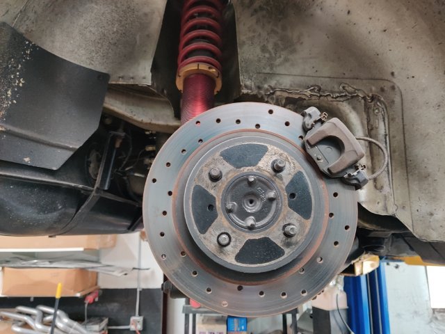

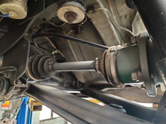

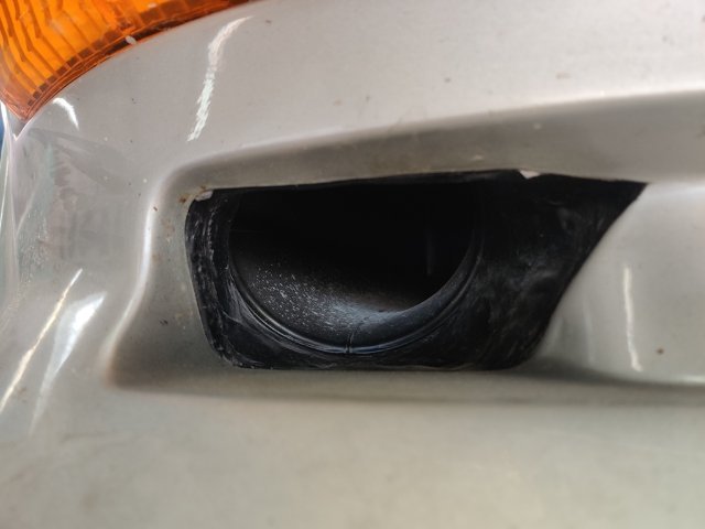

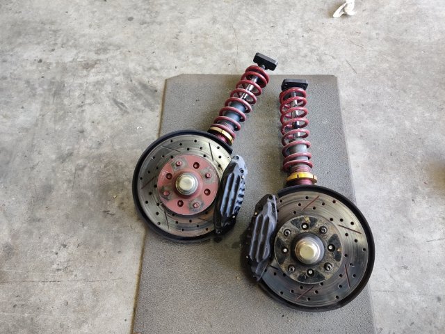

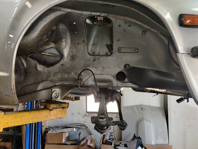

I started stripping the car today so I can put it on my rotisserie for few unibody sheet metal repairs... mostly the floor and the rear portion of the frame rails. I remove the heater core box, the engine and transmission, the front struts and the rear axles. I still need to remove the rear differential and the gas tank. I have a 2006 Chevrolet Corvette Z06, and one day I was looking at the brake vents and thought they would be good for the 240Z. And so they are! I installed these before I went to Road Atlanta in 2016 (I think)... this car has been off of the road for so dang long now! Anyway, they worked very nicely to cool my brakes. I made a custom fiberglass piece to adapt from the Xenon front spoiler to the round inlet of the Z06 vent, and used one screw and washer to secure the back of the vent to the inner wheel house sheet metal. The front brake rotors are Z31 vented units. I still have the unmodified backing plates on them, which is a mistake. It prevents air from getting to the back side of the rotors. Something else to address added to my list! Rear rotors are Z31 units. Calipers are 240SX. Axles are Z31 (with custom shafts). I bought parts from Ross back in the day (Modern Motorsports) for the brake and axle conversions. I bought the R200 differential from an eBay seller probably about 20 years ago. It was a NOS 200SX unit with a 4.11 ring and pinion. I removed the factory carrier and replaced it with a Nismo clutch type limited slip. I bought a high capacity finned differential rear cover and a billet transverse link from Protunerz.com during the recent Black Friday sale. So, I will be installing those when I put the differential back in the car. For now though, everything has to come off the car so I can make it light enough to put on the rotisserie for the floor repairs.

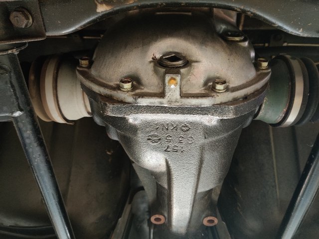

02-05-2026. ATLAS Z UPDATE. I got up early and got on the road. I went to Junkyard Jenny's in Ft. Lupton, about 110 miles one way and bought a R200 rear out of a 1978 280Z manual trans that she got in. Less than 100K original miles and she inspected it and said it is VERY nice inside. So, I got the diff, the mustache bar, and the front mounting parts. I ordered a new gasket rom Eric at Z Car Depot, and will paint it up and install later....after the trans is in. then teh driveshaft . It's an open diff with 3:54 gears! Exactly what I wanted. I ASSUMED my late 74 came with an R200, but when I looked under there, a greasy R180 stared back at me! . If you are in the Colorado springs area and want a free R180 let me know. I took my Wilwood clutch master.....I got from Godzilla Raceworks, and masked it off, wiped it down with alcohol and applied several thin coats of silver engine paint. Why? to match the brake master and the color palette in the engine bay. You will also notice I used stainless fittings to get the hookup for the clutch line that I brought in from the cabin to the master nice and clean. On the brake side, I got the Master mounted up to my adaptor plate I finished yesterday and mounted it up requiring me to remove the clutch and brake pedals, move the clevis point on the brakes up 1 inch for a better pedal ratio as I eliminated the brake booster (I did this on my 240Z, so it was quick and easy). Once I got everything bolted up, I was able to adjust my brake pedal height, but ran out of time and daylight for the clutch side. I need to get a replacement locknut for the clutch master rod as I cant find the one it had.....and then use the Speedway threaded clevis and pin, which is larger diameter, and that is why I pulled the pedal and drilled it out. In the pics, you can see I achieved the clean install I wanted. I loosened the clamps holding the master cylinders and moved them, etc. little things to make it look even cleaner. I will plug the remaining "slop" in the holes drilled and paint with a Q tip to finish it off, but I have kept the shaved firewall. Yeah, I am happy. Not too bad for a big bumper 260Z.

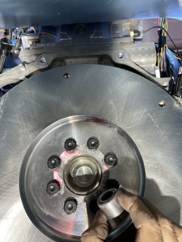

02-02-2026 UPDATE. Happy Groundhog Day! Well, it's time to get that transmission in! It is a completely remanufactured GM / Aisin AR5 for a 2003-2009 Chevy Colorado 2WD pickup. These are TOUGH and the bonus is, it bolts right up to the ATLAS engine without an adaptor plate. The 6 cylinders never came with a manual trans, and so I am doing this. I got my powder coated bellhousing on and torqued down, installed a new Hydraulic throw-out bearing with the spacer from Emtech, which is needed with their flywheel. Then I took the flywheel, which comes from Emtech, but are made for them by RAM and held it up and used a couple bolts to hold it on. 29.1 lbs., so pretty heavy, but the ridge in the center of the crank helped hold it up while I got the 2 bolts started. Thanks to RAM for putting a sticker on the flywheel that does NOT want to come off! next is install my Pilot bearing, torque the flywheel on at 70 lb/ft with the blue install fluid on the threads, which is considered necessary by ARP hardware for their fittings. I added 2 pics that show where I will have to make a new hole for my shifter, as this trans is 4-5 inches shorter, and a pic showing the factory trans mount ears in the trans tunnel I have to chop off and grind smooth. not bad for 2 hours work. BIG jump forward.

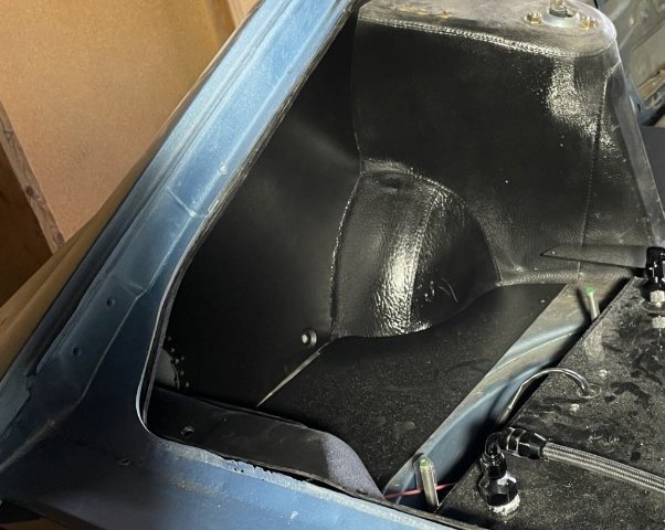

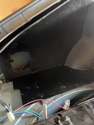

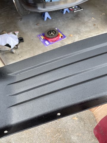

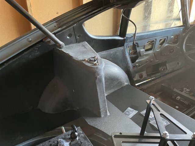

01-31-2026 UPDATE: I cut and modded the rear taillight panel and fitted some new reproduction euro style 240Z taillights and some factory covers I bought a while back that I had powdercoated gloss black. After that I attached the second hatch shock by drilling and tapping for it and then attached the MSA fiberglass rear spoiler. Then I cut the hole needed to access the fuel line hookups on the Evil Energy 10 gallon fuel cell. I turned it 90 degrees, as there wasn't enough rwork room underneath to have it facing back, and its much better as I now have a ton of room under there for setting up my whole fuel pump and filters setup. Then I wired the back half of the car, I will go back and make up the connections on the end later. I rustoleum primed the areas in the spare tire well and floors that needed it and then filed out the remaining holes on my dash center section so the gauges would sit in it the way I wanted them to. The rear taillight surround was the item that really fought me today. In particular the center section for the license plate. I ended up having to spend quite a bit of time modding it to make it look the way I wanted it to. The fuel cell isn't completely level yet as my 3/8" All Thread hasn't arrived yet. The all thread will attach at the feet on he bottom of the fuel cell and the bottom of the spare tire well. then at the top I have some 3/16" thick steel plates I will drill holes in for the all thread to level the tank up and drill holes to attach it through the floor on the ends. Pics follow.
