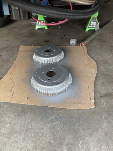

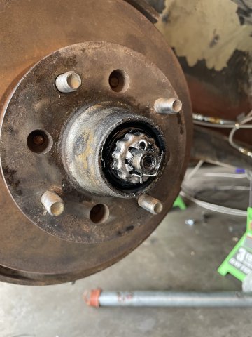

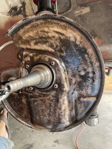

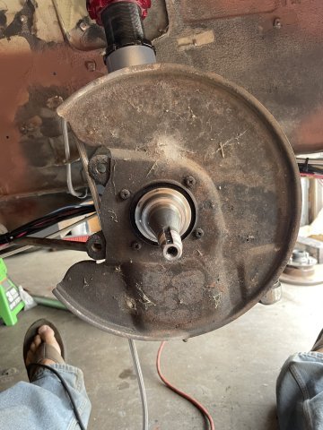

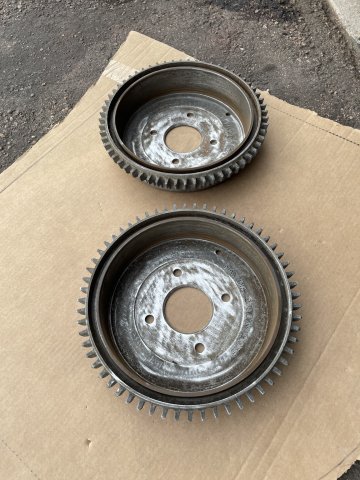

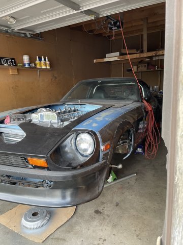

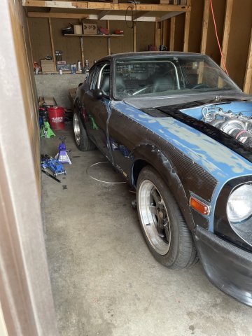

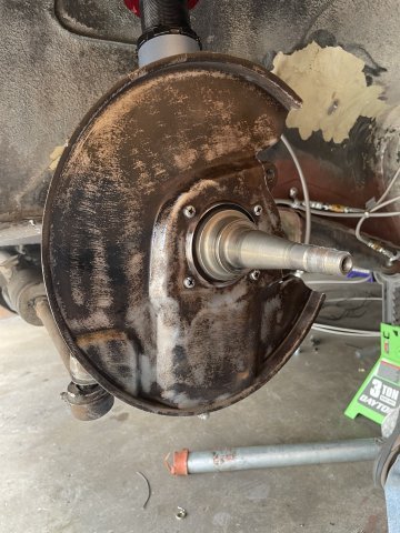

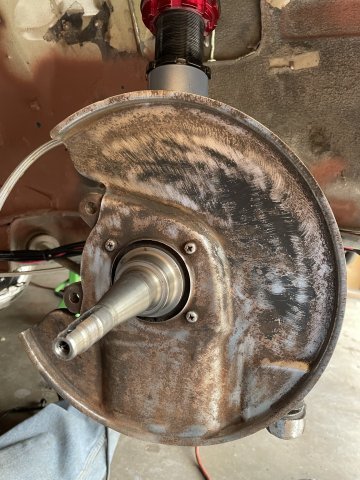

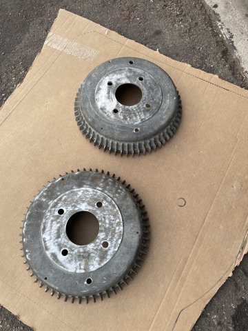

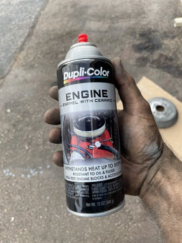

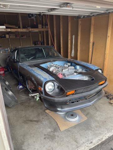

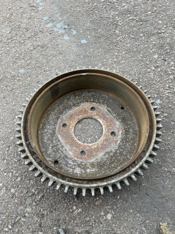

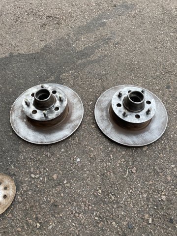

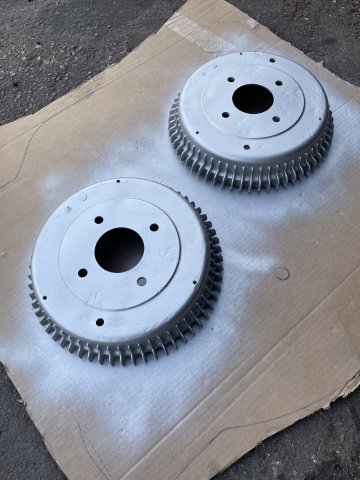

08-08-2026 ATLAS Z UPDATE. Brakes! I spent a couple hours setting my ride height. It is very tiring.... putting the car up and down..... over and over, and taking it apart, adjust, drop it, raise it back up ....over and over. I think it's pretty good. After that I jumped on the brakes. I ordered the parts I needed from Z Car Depot. New front calipers and pads, TC rod bushings, end link bushings. Rear drum pads, complete drum rebuild assy, new drum wheel cylinders, new front wheel bearings and races/seals.....So I pulled the rear drums, cleaned them all up with the wire wheel in the drill and then smoothed out the pad contact surface with some 40 grit sandpaper. they were smooth and no grooves, so just this roughing is sufficient. Afterwards I cleaned up the face on them and gave them a nice coat of Duplicolor Silver engine block paint.... and they are drying. Then the front rotors. The bolts for the calipers I wire wheeled them back to nice condition, then I used a long screwdriver and a hammer and knocked the old races out, and cleaned up the hubs and got all the old grease out. Messy! Because the front rotors have no grooves at all and just surface rust, I went over the contact surface with my DA sander and 40 grit sandpaper and got them to a nice surface that the new pads can break in on well. I dropped the new races in the freezer and cleaned up some of the rest of the rotors with the wire wheel attachment in the drill. While the rotors were off, I cleaned up the splash shield behind the rotos and gave them a layer of clear also. entire braking system is now new.....DOT 5 fluid maybe? Real progress. PICS.

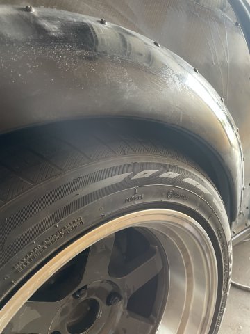

08-02-2026 ATLAS Z UPDATE. I went ahead and worked on the front end today. I dropped the struts and turned them all the way in, tightened up the cross member to shell bolts with the spacers, and did a bit of wire wheel cleaning. Then I dropped the car to get a preliminary look at where I am. It is LOW. LOW, LOW, LOW! The rear quarters are on the tires, so I will have to bring that up at least an inch and then fine tune from there. I will probably do that and then drop the axle shafts in at the same time. In the front, I have about 2 inches of clearance ground to K member, and my exhaust is less than an inch. So, now I know where I am at, and can make adjustments. I might space the front wheels out an inch. I also remade the electric panel....the old one I didn't like, so I did a layout and mounted it all up. Much better. Intake pipes go in for welding and sanding, then the polisher. Click on "MOV" for short video. PICS: IMG_4592.MOV
