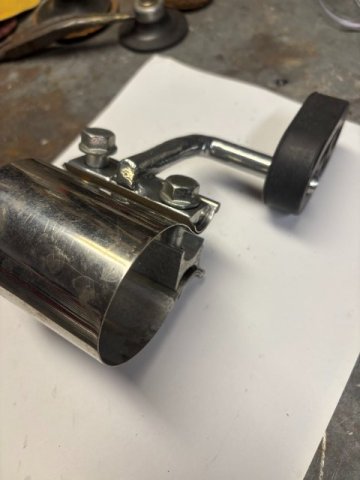

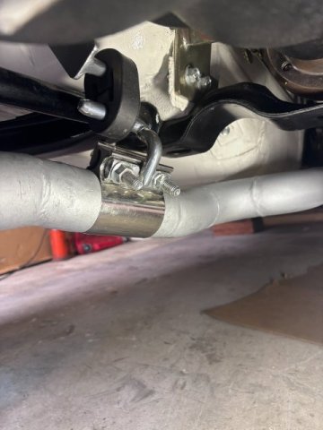

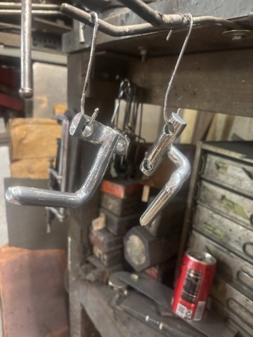

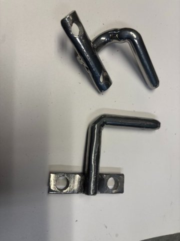

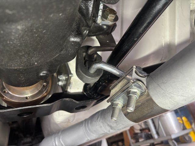

EXHAUST SYSTEM REPAIRS- My 240Z Exhaust Pipes were damaged from scrapping them on Speed Bumps. I found a cracked at one welded joint and a few exhaust leaks. Since repair required their removal, I decided to raise the pipes higher as the same time. I designed this exhaust system so that whole system consists of three major sections. First -Front Section goes from Hooker Exhaust Manifold to the X-Crossover pipe. Second Section runs from X-Pipe to the Rear Right Angle Exhaust Pipes. The Last Section finishes at the Two Turbo Mufflers. So this repair and raising the pipes only required the Intermediate Pipe. Also, since I used Evil Energy V-Band Clamps to connect the pipes, it was a simple job. The Intermediate Pipe Mount consist of 1/2" Steel Rods bent at 90 degrees and bolted to the Differential Housing. To Raise the exhaust pipes, only the Mating 1/2" Mounting 90 degree Rods had to be shorten. Pic of Mounting Rods cut off and rewelded Pic of Mounts Powder Coated and out of Oven Pic of Fully Assembled Exhaust Mount Evil Energy 2 1/4" Lap Joint Clamps( Amazon $20 a pair) Rubber Exhaust Pipe Hangers(Amazon-$6 a pair) and 1/2" Steel Rod-Bent to (90 Degrees-Home Depot) Right Side Pipe Mount Left Side Pipe Mount The Exhaust Pipes were raised about 1 1/2". The job can be accomplished in one days if materials were at hand. - Yesterday
