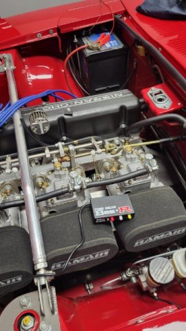

Reviving an ooooold thread but wanted to give it a try as this is the only case I found that somebody worked on getting a Bee-R rev limiter to work on a L-series. @GabeDiaZ27, have you managed to get it working? I got a Bee-R lying around but cannot find a way to wire it up to a L series running a ZX distributor...

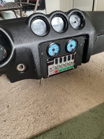

Dash cap is on! next is gauges and center section install. run the wires so once installed the wires are right there and can be easily wired. Speedo is GPS. Speedhut gauges. Made in USA, cost is like sending a kid to college
