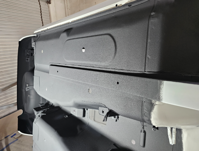

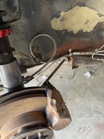

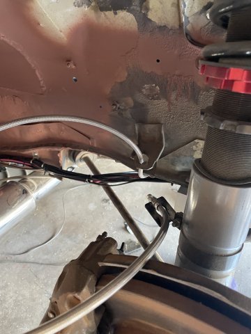

08-01-2026 ATLAS Z UPDATE: Today I dropped the rear struts, adjusted them and set the ride height. While there I wire wheeled the area to do more cleanup for the eventual clear coating of stuff. After that I finished the intake tubing project and got everything marked for welding, sanding smooth and polishing again. I laid out the PTFE braided brake hose and installed it, with jsut the rear remaining to be done. At the rear splitter the factory fittings just wouldn't budge, so I cut the old lines, took the splitter out and fixed it and reinstalled. It's made of brass....old school facotry stuff, very cool. I will have to order more from "Finishing Lines". I also got the right size serpentine belt from DAYCO and it is installed for my custom setup. And then I finished the day cleaning up the cutout on the hood. A bit of paint touchup and buffing and it will be great. PICS:

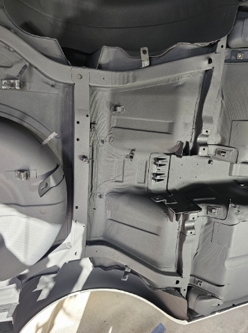

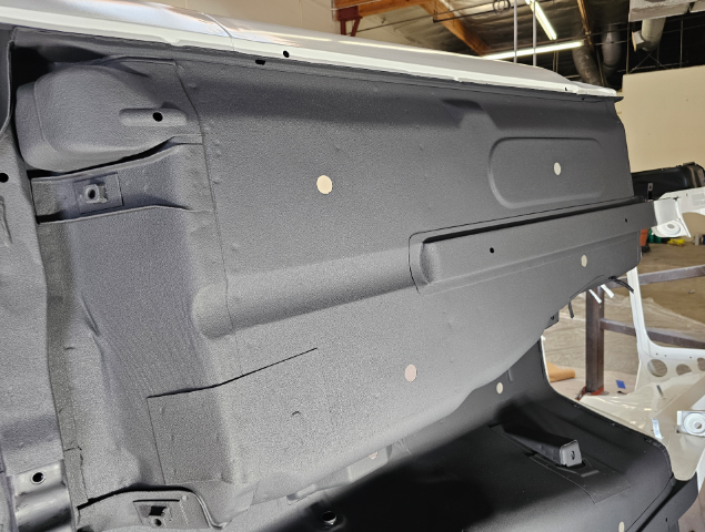

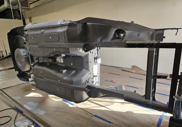

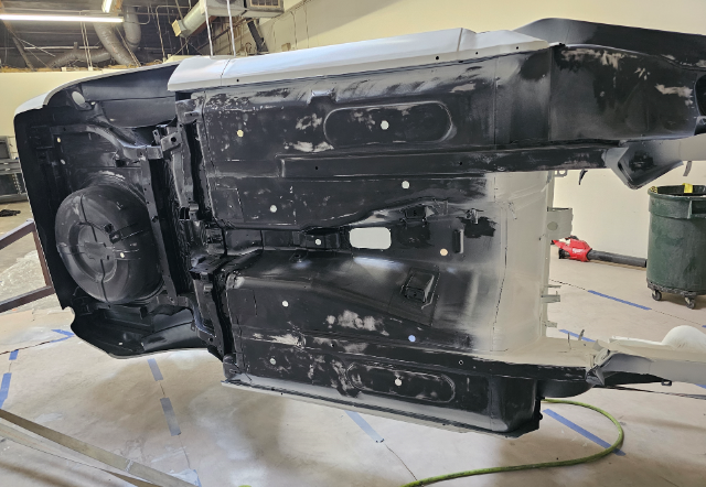

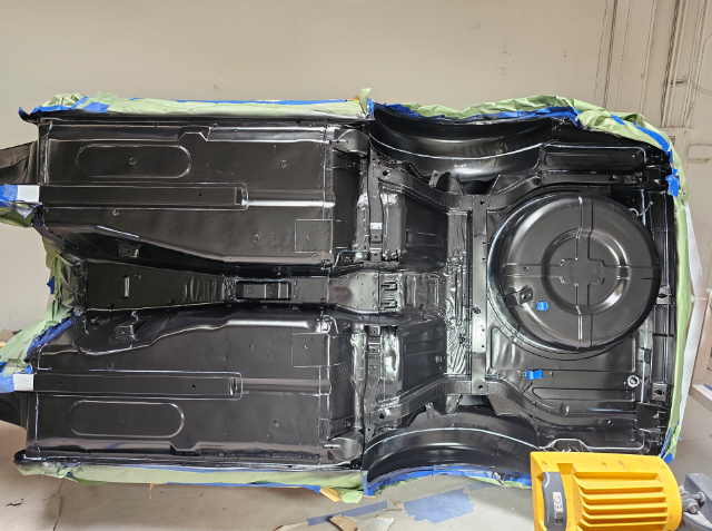

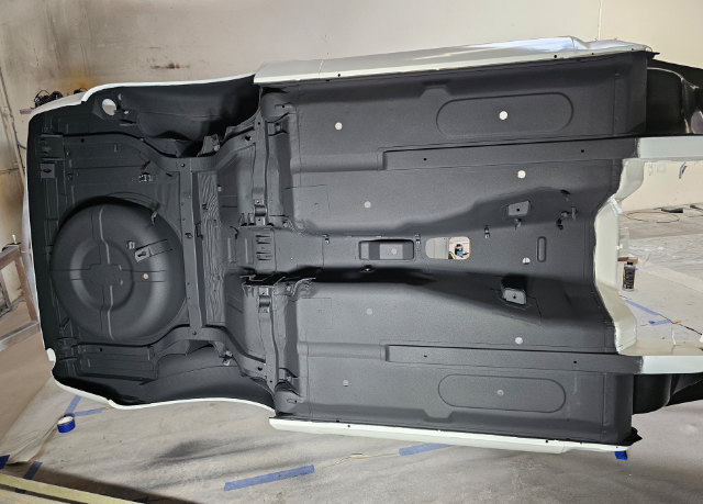

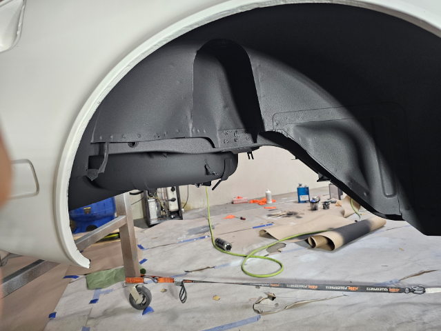

Before getting the top side and interior sealed up in 2 coats of white epoxy, I first hit the underside. I chose to do it in black Epoxy to more follow the original paint where you could see the black though white overspray. I first put down a full coat of the black again using my 360 degree extension paint gun to get in all the difficult location like between the spare tire well and rear valance, then a normal 1.4mm tip gun. After allowing the top to cure for two days I sanded out the bottom side and scuffed it well with Scotchbrite. I then applied 2k epoxy seam sealer in all the original OEM locations I then taped up the topside and put down a final coat of black I then let that cure for two days before applying the Gravitex. It is made by U-Pol the same company who makes Raptorliner, Gravitex is better in my opinion for the other side as it is intended as a sound insulting stone and chip guard. Its what you see on the rocker panels of German cars. Goes on the same with an undercoating style gun. Its a 1k product so I will need a sealer coat on top of it before finally paining the underside white in body color. I really happy how it came out. The weeks of metal work straitening and shrinking the original floor pans really looks good all finished.

Its been an exhausting month of hard work getting the chassis in Epoxy to move it back home before the end of the month. Here is the process. 1.) strip all factory sound deadening/undercoating with a scraper, heat gun, wire brush. 2.) clean any residue with paint stripper and after-wash solvent. 3.) strip original paint from body with Citri-Strip paint stripper - again clean with after-wash 4.) remove interior tar paper with dry ice and liquid nitrogen. 5.) wash and clean entire body with Mastercoat metal prep - phosphoric acid rust neutralizer https://nomorerust.com/collections/metal-prep-rust-remover-products 6.) sandblast all seams and overlop joints. 7.) brush Mastercoat rust sealer primer into all seams and nooks https://nomorerust.com/products/mastercoat-ultimate-permanent-rust-sealer-silver-primer-original-sprayable-slim-quart 8.) lightly blast the floor pans with white aluminum oxide until white metal 9) brush 3 coats of Mastercoat rust sealer primer on to floors 10) blast the internal frame chambers clean and blow out any sand 11) spray the internal cavities ( rocker panels, rear fenders, rear internal quarter, and front internal cowl area with Matercoat using a 18 inch long extended tip spray gun https://paascheairbrush.com/collections/extension-spray-guns?shop_consented_scopes=email%3Averified+openid+pay%3Asession_token+profile+shop%3Aaccount_uuid&shop_sign_in=true using a 360 degree spray tip to coat all surfaces 12) sand the entire body removing any Mastercoat not reaming in pits or detents 13) sand the entire external body shell and underside with 180 grit and clean with wax and grease remover 14) lightly blast entire body inside and out until perfectly clean and lightly textured to promote adheision - holding the blast nozzle 12 to 15 inches away at 60psi with white aluminum oxide 15) hours blowing out the remaining grit 16) again using 360 degree long extension spray gun, paint all internal cavities and under sides with DPLV Epoxy Primer 17) Spray entire body inside, outside, underside with 2 coats of Epoxy Ridiculous amount of hours https://www.youtube.com/watch?v=y-kogRrJYJU
