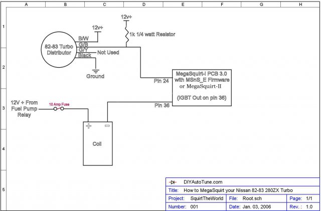

Thanks for the tip. I actually took it for a test drive last night. What I meant by wiring the shield and signal wire together is I made a junction box with terminal strips and I wired them how they were supposed to go according to the megamanual, shield at pin 2, signal at pin 24. I was just worried that having some of the signal wiring exposed inside where I soldered them up inside the headphone jacks. Its all built with the intentions of being able to remove it quickly without cutting anything or adding more stuff at a later time like wasted spark ignition or the like. My actual problem with the tach signal was the grounding spade connector on the side of turbo dizzy. Its important to ground it to chassis or block.

Hello, I had a silly question about the turbo dizzy. there are two sets of slits inside the dizzy. Does this mean that there are two laser beams in the dizzy? I was asking this because I was wondering what the unused wire on the dizzy was originally for? The one that is not used when using ms2. This one
