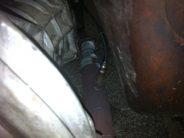

  5. here go! p.s. just ignore the reducer after the o2, its not required! lol
