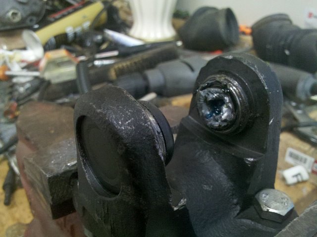

I wasn't able to talk to him until this morning, but he said that it the slip yoke on my 280zx driveshaft isn't machined with a place for the Circlips to sit, so I'm ordering a new slip yoke. It's part number 1203-26S from PTI. In the future I'm going to have a driveshaft made with 1310 U-Joints, I think I know where to get all the parts I need. I will start a thread detailing that when it starts to happen.

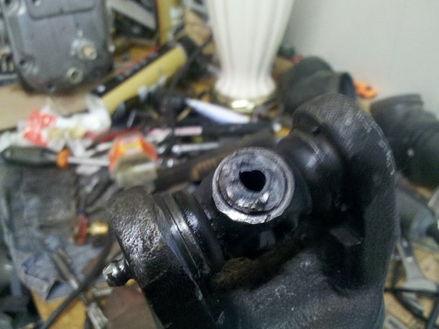

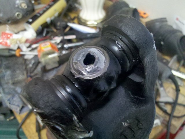

I got the Spicer U-Joints in the other day, so this morning I took them to my local transmission repair shop, which is a pretty neat, old fashioned machine shop. But anyways, it turns out that the slip yoke for the transmission got twisted as well so I need to replace that piece too Fortunately I have the driveshaft off of the 280zx that I sourced my engine and transmission from, so I'm hoping that we can remove the staked-in U-Joints from that shaft and take the slip yoke off of it to adapt to my driveshaft. As long as that slip yoke isn't worn inside the journals for the U-Joints, it should work. I'll find out tomorrow morning.

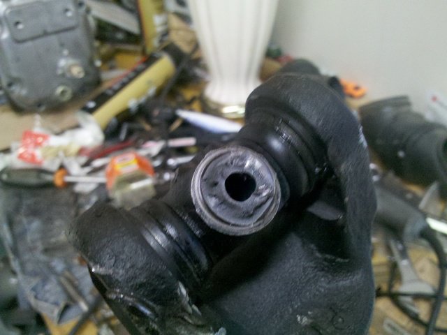

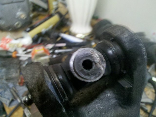

Ok, so after researching for several hours, I found out that the U-Joints that were put in my driveshaft were manufactured by a company called PTI. I can't really find out much information about them, but the part # is 1251-22. The two alternatives I am looking at are either a Spicer or a Neapco. Spicer # 5-1501X, a solid, non-greasable U-Joint EDIT: Most companies selling this advertise it as a non-greasable U-Joint, but it actually does have a grease fitting in the cross. Jmortenson confirmed that for me today and corrected M2 Differentials web page, but every other vendor I've seen still lists it as non-greasable. or Neapco # 1-0027, a greasable U-Joint For the record, the size to look for on the driveshaft U-Joints are: Bearing cap Diameter of 0.985"/0.984" (I give these two numbers because the Spicer part advertises it at 0.984" and the Neapco part is advertised at 0.985") Yoke Lock up of 1.736"/1.734" (again, Spicer is at 1.734" while Neapco is at 1.736", both listed as a Datsun application, and both cross reference to the PTI Joints I currently have) Unfortunately Neapco does not make the right size U-Joint for the driveshaft in the Bruteforce variety. You can get the U-Joints for the Halfshafts in Bruteforce, which is part # 1-0029BF, but they don't make a 1-0027BF. So I am leaning towards the Spicer right now, your thoughts? I like the non-greasable design of the Spicer, but am a little concerned about the bearing diameter being 1 thousands of an inch less than the Neapco.

Yes, I am using the T5 that came on the Turbo 280ZX's, and there is not really any way to adapt that transmission to an R180 without a custom shaft being made. As for the brand, all that I can find on the U-Joints are the stampings DN NP 2 and also a stamping of what looks like a crown. The U-Joints were provided by Powertrain Industries, who made the shaft for me. I will probably call them next week to ask them which brand they used, so that I know to avoid it. Here is the link to the part # for the U-Joints that Powertrain used in my shaft: https://www.powertrainindustries.com/catalogs_type.htm?type=UJoints&filter_string=&filter_key=part_number&filter_val=1251-22 Those of you putting a T5 in a 240z, Powertrain made me a good quality shaft as far as the workmanship is concerned, but the U-Joints are definitely suspect.
I experienced a complete failure of both U-Joints in my driveshaft today at the dragstrip. As soon as I pulled through the water, brought the revs up, and popped the clutch to start the burnout, I hear this awful racket and the whole car is shaking, and then suddenly it stops and I'm just bouncing off the rev limiter. I quickly found that the car wouldn't move, and when I got out, the driveshaft was laying on the ground. Great way to start out the year at the track right? Here are the conditions surrounding the failure: 1. I was using very sticky drag radials, Nitto 555R's 2. The burnout box was VERY sticky. They must have just sprayed VHT all over it, because when I got out of the car my sneakers were almost getting pulled off of my feet when I lifted them off the pavement. 3. My car is probably making well over 300 lb/ft of torque at the wheels. (dynoed at 280 lb/ft at 12PSI, currently running about 17PSI) Now I was really suprised that this happened. My driveshaft is almost brand new, custom made for my turbo swap about a year ago, and has only about 3000 miles on it, and only about 5 1/4 mile passes, although a lot of aggressive street driving. I really would have thought that the 40+ year old U-Joints in the half-shafts would have been the first to break, not the almost new ones in my driveshaft. I'm really kind of concerned because this happened with an open R180, and very soon I will have a Torsen LSD R180 from an STI in the car, which will probably stress the driveshaft even more. I don't really know a lot about U-Joints, so I'm hoping some of you can give your insight. I think that the primary reason for failure was because my driveshaft was made with greasable U-Joints, which have a very large (approximately 1/4" diameter) hole in them for the grease to go through. I am hoping that buying solid U-Joints will solve my problem. Here are some pictures of the failures. What do you guys think? Buy solid, non-greasable U-Joints, or do you think I am just making too much power for these small U-Joints?
