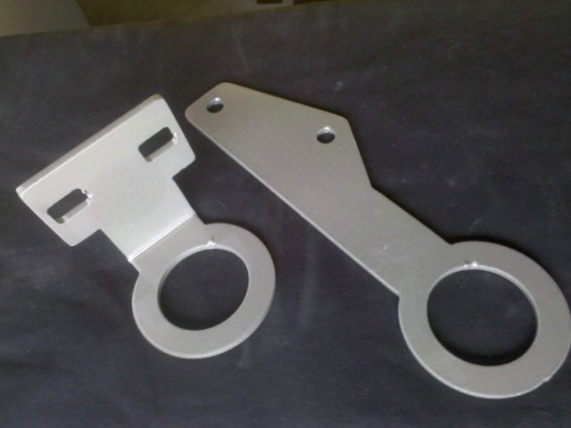

  8. The factory tow hook areas are blocked by my intercooler. So I'll either install one dead center in the bumper with a plug for the hole or at the top of the airdam opening just out of sight like the placement on the 350z. I'm also starting to make a front splitter/skid plate to protect the front edge of the airdam out of some aluminum diamond plate I scored at a scrapyard a while back. I can't find any examples of these kind of mods done to s130's so if anyones got any pics they'd like to share I'd appreciate it. Mark.

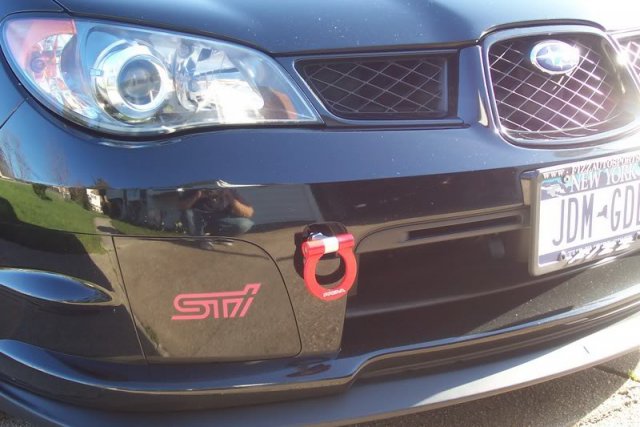

  10. Found something I like better for what I'm doing. I like that you can easily remove and stow these away when not needed, discrete and functional. They screw in like the oem 350/370z ones. Any ideas on install or placement of these?

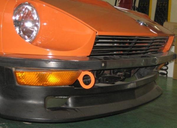

  11. I'm installing my MSA II body kit and looking for pics or ideas of tow hooks used with this kit on my 280zx. Something like these photos courtesy zccjdm.com

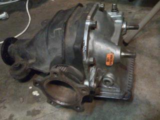

  20. This past summer I got a shortnose R200vlsd out of a 90 300zx na with plans to adapt it to my 82 280zx. After hours of searching I found the best way for me to acomplish this was to keep my longnose r200 housing with it's ring and pinion gears and install the vlsd into the longnose case. Here is a link to a great writ-up on different ways to acomplish what I'm talking about. link For me this seemed like a better solution than adapting the shortnose case to my crossmember keeping it a bolt on project except the axles which you'll have to figure out either way you go. My link Hope this helps. Mark.

  24. Here's a pic of the diff I've pulled from a 91'300zx non-turbo And a link to installing it in a Z31. http://www.88hybrid.com/forum/viewtopic.php?p=87755&sid=a4ea4180b8efd1370218379f5c2311a2
