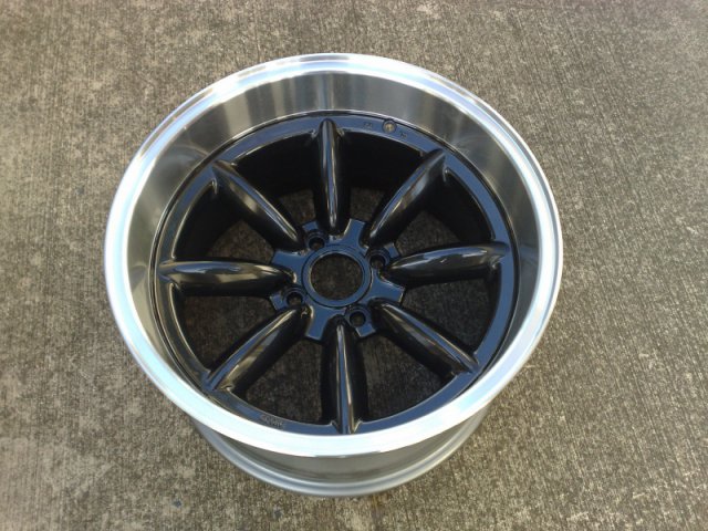

My Rb-r's came back from the painters yesterday. I got mine from Otomoto as Im in Australia. They only stock steel grey. I had them repainted in a deep metallic charcoal with white pearl. http://www.otomoto.com.au/showroom.htm

Do you know if they come in any other sizes, like 17x9?
