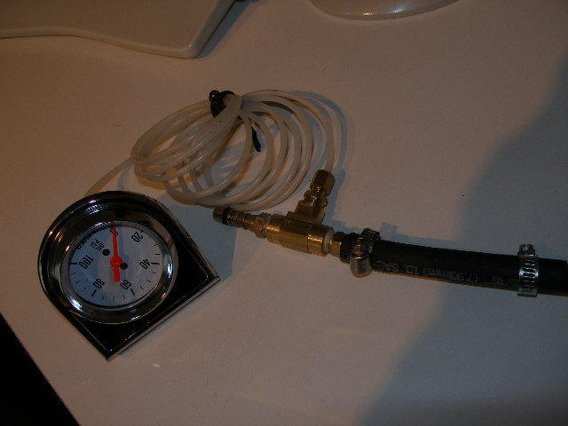

after rereading I take back the broke dizzy part. If you had no crank angle sensor input to the ecu you would never get a spark. (but still check the dizzy). have you done a timing light check on the ignition. it is quite likely the previous owner was a moron and put the oil pump in and then didn't check the timing. If pump is one tooth off she no run so good. Since you a newbie I might also suggest new plug wires, plugs, dizzy cap, dizzy rotor, fuel and air filter. Have the battery load tested and the charging circuit - FREE most places. If you have those one size fit all clamp on battery cable terminals scrap them NOW and get real cables. The ground strap should go first to a bolt in the body thence to the starter. Lazy PO just cut em off. Low battery voltage will cause a zx to do odd things. Bad battery cables and bad battery caused me a few days grief on an s130 and a z31. Wife still not happy about the trip we took and needed help getting off the ferry. Check your fuel pressure very important. It will tell you if fuel filter ok and fpr ok. If you are going to keep the car awhile the above money spent will not be in vain. picture is a rig you can use to check fuel pressure for under $15
