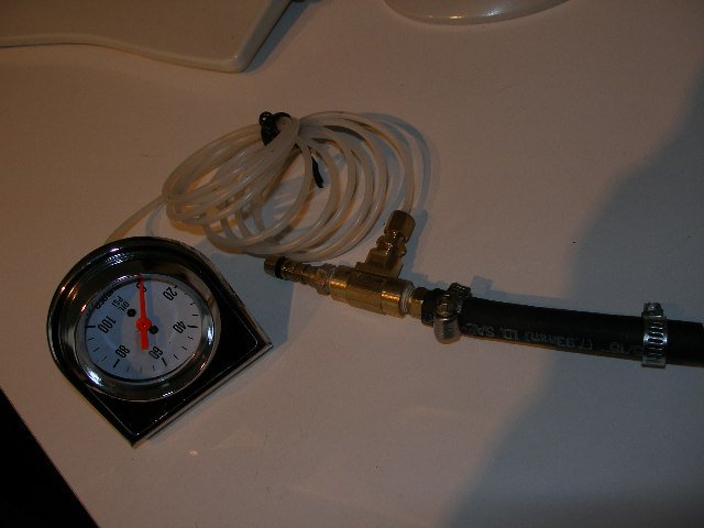

when you check the fuel pressure that will verify the FPR. Have you looked at the AFM? lots of posts on fiddling with it. If the ecu doesn't think the engine is getting air it won't give it any fuel. Here is a pic of the fuel pressure rig i made. When i talked about the battery cable I was thinking Z31 but the same thing. On the 280zx it went down from the negative terminal to a bolt that went into frame about a foot below the battery tray. Sounds like you did it right but wanted to correct myself. Been working on a z31 turbo for last two months and sometimes my mind wanders to that. I ask again have you checked for loose hoses that create huge vacuum leaks. The rubber boot from the afm to the manifold is a problem. Examine that closely many folks found it to be cracked. Also there is hose coming off the bottom that needs to be connected (at least I think that is s130 and not z31 I'm picturing).
You can buy a fancy fuel pressure checker from auto parts stores. All you need is a cheap oil pressure gage that is at least 0-50 psi, a tee, some hose, and some hose clamps. Pull the fuel line off the top of the fuel filter. insert short hose there. insert Tee. hose clamps on the new hose. Now connect the pressure gage to the part of the tee that is open. You may have to look around for some adapters to do that. Depends on how good a hardware store you have in your area. I made the whole rig up for less than $20. The reason you had a short negative cable is that someone cut off the original body ground parts and went direct to battery because the original strap clamps were prone to breaking after some usage. Originally the ground wire had a copper piece coming off the cable after the terminal clamp about 6 to 8 inches. This was then bolted to the firewall in the immediate vicinity of the battery. It then ran down and was held by a rubber block and clamp then to the starter. If you can find an original at the junkyard worth the trouble to get it and replace what you have (my opinion). FPR could have failed conincidentally with the rebuild.
what does the positive cable look like? Is the negative cable grounded close to the battery and then to the starter as it was originally designed or did some genius just cut it all off and go direct to the starter. It will work but not the best way to do it. on my first z31 not knowing how it was supposed to be I ran two 10 gage wires from the negative terminal to either side of the engine compartment. Lots of M6 bolts around that go into the body for grounding. Insufficient earthings were what gave early Limey cars and Lucas electric a bad name. not saying that is the problem but every little bit helps. If your fpr is shot the spray fuel everywhere test doesn't tell you much. If you don't have a constant (around 30-35 psi) fuel pressure on the ring your injectors are not performing properly. Too much pressure they shoot in too much fuel. Too little pressure they don't shoot in enough to keep it running. You could try the starting fluid trick if it runs that way then you know (maybe) that timing and spark are right therefore a fuel or air issue. How could you check the spark and not see that the engine is turning over? A huge vacuum leak could also exhibit the same problem you are having. Recheck all the hoses and stuff that could cause that.
