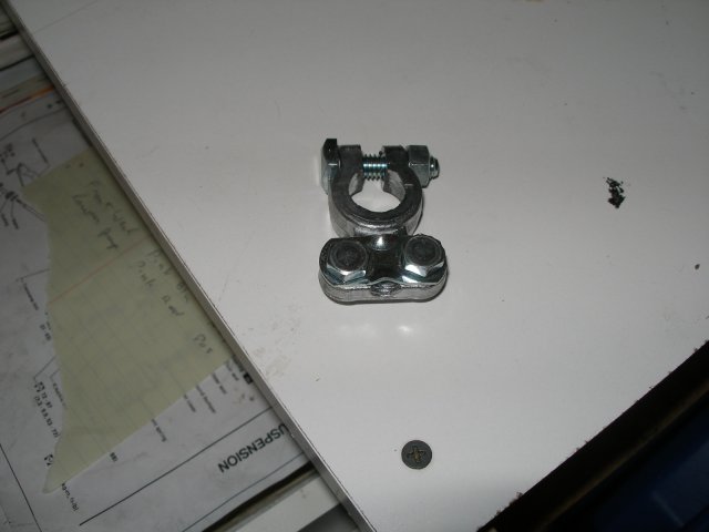

did you redo your battery cables? new battery won't help if cables are corroded, loose. if po put these clamp type on your cables get rid of them. Also the ground strap should go to the frame to a bolt about a foot below the battery box and then to the starter. grounding through the starter is not a reliable connection. plug unplug the afm connector and examine for corrosion. Deoxit by CAIG is the best for cleaning connectors. plug unplug the ecu same same. plug/unplug will often rub off corrosion to make contact but cleaning is the surest way. Don't understand your reference to finding tdc then moving it a mark on the pulley. Distributor position determined by the oil pump gear being in the correct position on its mate. this is what drives the distributor and determines rough timing. fine is by timing light. there are marks on the gears. another possible is ignition module but you said you are getting good spark. -
