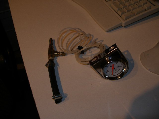

download the Factory Service Manual from xenon's site (try google search it is wondrous tool). do a search for the fuel injection bible another useful fount of information. put a fuel pressure gage in line between the filter and the rail. fuel pressure should be around 30 pse idle rise to 36 with some throttle. attached is a rig you can make for under $15 to check your fuel pressure. when you get the FSM try reading it putting it under your pillow at night does no good at all. jump a 12 volt hot line direct from battery to fuel pump. don't forget the ground if it runs you will hear it. you should hear it run for a few seconds when you turn the ignition key to on. if the pump is running and delivering pressure to the fuel rail then probably fuel pump relay is a goner ONCE AGAIN READ THE MANUAL
