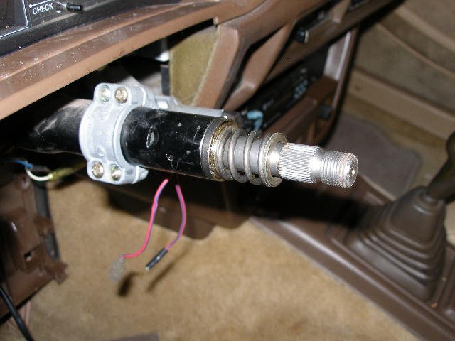

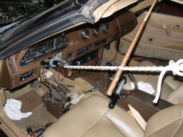

thanks for all the replies. and yes I did get the running lights repaired. loose connector fried the plastic and allowed the connector to get loose. squeezed everything down and now good. The moral is don't unclip the spring. I assumed (you know about that) that it had to come out to remove the combo switch thingy. WRONG just needt to loosen the screw some more. What it was is what hughdogz said. there is a flexible rubber piece inside the engine bay which pulls the steering column down. This is why i thought the spring needed to be compressed quite a bit. Not true. If I had a buddy to push up on the steering column no problem but I'm all alone in the dark. Luckily being an old guy I studied catapult technology in school so I did the trick shown in the photo. this then makes it a finger push to get the spring down and the clip back in. -
anyone else been stupid enough to undo the spring clip thus releasing this spring on the steering column under the steering wheel. If so how did you fix it.
While repairing the running lights on my 83 zx I made the error of removing the spring clip that holds the little (but very stout) spring that is mounted below the steering wheel as I thought it had to come off to get the multifunction stalk unit out where you can work on it. Any one else do this and know a way to get it back together.
