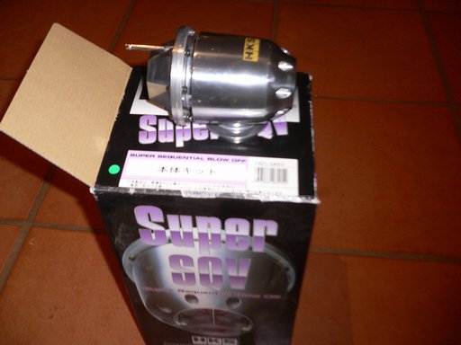

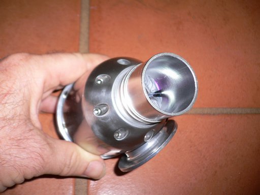

Hi thanks for the photos thats great. Did you say you would like to buy the racing BOV if I dont use it or the HKS? The photo of the HKS I am just holding a tube that came with the racing BOV, that happens to fit in the hole of the HKS perfectly -

I agree with you what a lot of nonsense over straight air. I am still tossing up whether to weld a fitting on the HKS and let that recirculate. I presume it should be a much better BOV than the other one, should be, it cost 7 times as much! What do you think about the photo below, just welding a small tube on the open outlet of the HKS - I assume that should work? -

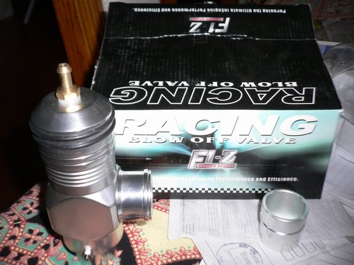

That would be great if you could take some photos of the final product. I had purchased a HKS BOV but then found out that the Licensing Authorities will not approve a BOV to atmosphere. I therefore have bought a cheap one with recirc to get it licensed (see photos below) Thanks for info on where all the pipes go. Regards unfiltered air into inlet - my HKS did come with a filter for that line so must be something in it? I got someone to do the polishing (cost $500!) so not sure what they used but yes the collectors are rough in standard trim. I like the polished look as it looks more like what the car would have come with regards -

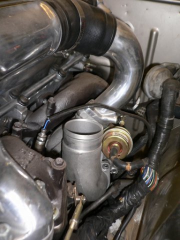

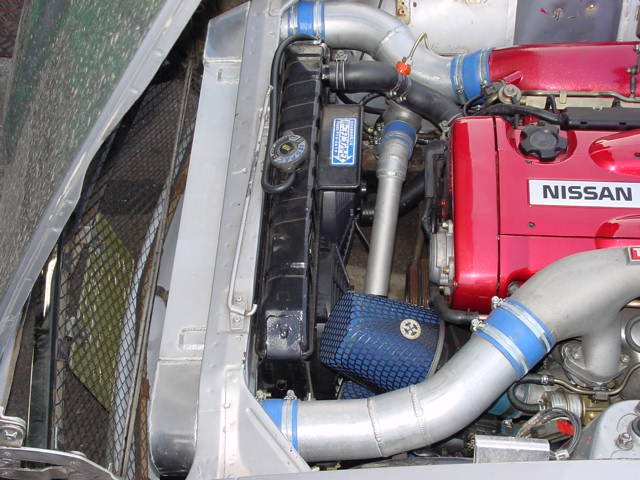

Thanks good explanation. What I meant was the rear alumium right angle original fitting that you have obviously retained. I have an Apexi Djetro so have done away with the MAF's which does decomplicate it somewhat. What I am thinking of doing is using another rear fitting on the front as well (see photos below). The first photo shows the rear fitting I am talking about, the second photo, the rear fitting on the front turbo, the third photo, one possibility for routing the aircleaner, the fourth photo, one possibility for routing the rear aircleaner, and the fifth, the same from the top. If you can though, I would love to see a picture of your setup (can you take off the front aircleaner & photograph down there?) as you describe it with the BOV fed back etc. Did you feed the BOV back to both turbos rather than just one? Also what width is your IC? I had a 600 wide but it was too tight so have just bought a 450mm wide one. Also where does the small black tube off the side of the BOV go to? regards -

Did you use the rear turbo inlet aircleaner fitting on the front turbo to route your aircleaner? regards -

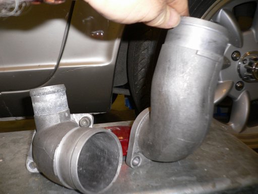

Well Stony was dead right. I tried the rear turbo aircleaner fitting on the front turbo and voila that should do the trick - now I just need to find one. Lots of people take off the twin turbos to use a single so ther must be some lying around - any HybridZ members in OZ have one? See below Compare front & rear turbo fittings, rear turbo fitting now fitted to front turbo

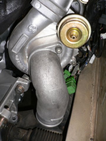

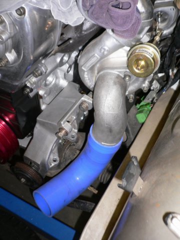

Can anyone tell me how to deal with re-routing the pipework for the original flange fitment on the front turbo? (see third picture below) I have the rear turbo aircleaner sorted very easily (see Pic 1 & 2) but the front one, the flange off the turbo is going to have to be completely refabricated (in original fitment faces straight to the side of the engine bay). I am going to see if I can get a generic flange and then weld on pipework coming straight out to the front whilst attempting to miss the aircond pump. Those who have stayed with the twin turbo setup - what have you done? Pictures would be great. thanks
