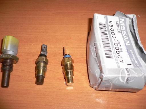

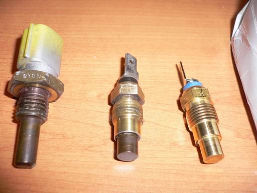

My brother just tested the sensors I had: Cold Hot (ohms) The 240Z water temp sensor 0.3840 0.059 The Bluebird water temp sensor 1.192 0.166 The RB26 water temp sensor 0.485 0.065 The other RB26 sensor (very left photo above) 2.23 0.55 So maybe I bought the wrong sensor as the Bluebird sensor which is the one I was told was the same as the 2.4 motor is miles different to the 240Z original sensor, yet the RB26 original sensor actually isnt that much different - see ohms numbers above. So question is - Is the 240Z sensor and gauge different to the 260Z sensor and gauge? Or alternately have I just been given the wrong sensor (Nissan Bluebird) compared to the one Careless has used? Any ideas Careless? Can you find out what the Nissan part number is of the models you mention - is it different or the same as the part number of the sensor I have bought? Anyone - I know the 240Z & the 260Z gauges are different in their look and body - are the sensors different - I have a 2.8 motor in my 240Z and the sensor is the 240Z one I think (has a blank sensor with a nut that slides over it and screws into the thermostat housing) In my 260Z I also had a 2.8 motor but the sensor which did run my 260Z gauge ok, screws into the thermostat housing but has a plastic like tube coming off the back of it? I will post some photos tomorrow. The plot thickens -

Nissan parts in Australia told me that the 2.4 came in the Nissan Pintara U12, the Nissan Navara Ute D21 and the Nissan Bluebird U13 in Australia I bought the sensor yesterday Nissan Part No 25080-89907, it has the number 7H stamped on it versus the RB26 one which has 9L stamped on it. The new sensor is the one on the right side (The middle one is the RB26 original) Hope I have the right one. I will check the impedance later and advise. See attached photos. The sensor on the very left is adjacent to the water temp sensor on the RB26 - does anyone know what this one is for? Is it some water temp sensor back to the ECU? -

Chris couldnt find a straight swap for the water temp sensor in order to use the original Z gauge. Below from another thread the answer is now available Quote: Originally Posted by getoffmyinternet I just realized today that Chris Rummel already discussed using the stock temp gauge for the rb swap. He confirms that the rb sensor will not work for the s30 gauge. Unfortunately he couldn't find the ohm specs on the l6 temp sensor, so he just used it and made an adapter hose to get it to work. My hope is to figure out the specs of my l6 sensor and find an alternate sensor with the same specs but also the same size as the rb sensor so I can screw it into the stock port. If all else fails I can go his route, which isn't really bad at all. Just got my RB25 in and running a couple of weeks ago. Ran into the same thing with the temp sensor, but wanted a more elegant solution than adding an aftermarket temp gauge or inline sensor. I usually have multiple projects going on at once, and for the first time it worked to to be a benefit. Knowing that Nissan crosses over many parts, I scoured the garage for a similar sensor. By pure luck, it didn't take long - I had a '91 240SX KA24DE on an eng stand, and sure enough the sensor matched size and style. Taking a multi-meter to it, it had the same resistance at ambient temp and the orig Z sensor. Lacking time, I went ahead and tried it out. Just as I hoped, it read just left of center on the stock Z gauge with the eng at operating temp. It even ran midway right of center one time when I forgot to hook up the electric radiator fan. The toyota one from Chris R's install article (LOTS of good info there) was too small in diameter and wrong thread pitch. Hope this helps. In the pic below starting from the left: Stock '77 280Z, '91 KA24DE, stock RB25DET, Toyota one Attached Thumbnails __________________ Steve -

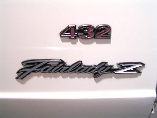

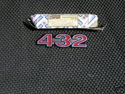

Hi RBS30 I live in Perth and am doing an RB26 Z (check out my website) The badges you have created are fantastic and something like I want to do but have not been able to obtain in WA. What I am after is a badge to designate the car as a 422T (see my explanation in Part 18 on my website). I have purchased the Fairlady badges for the back and sides of the car to replace the Datsun ones, but now need 3 badges with 432T on them to put under each of the Fairlady badges as on the original 432 (see attached 432 badge) I know this is a big ask but do you have access to some sort of engraver or something and do you think you could make such a badge for me (for money of course) Currently I hve just some individual stick on numbers form Bunnings but they arent really the go. Can you help? regards Mike Rowe
