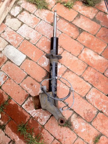

+1 on liking the build, and I'm glad I was able to help out getting the strut housing for you DAMN SPINDLE PINS!!

Here is what I have if you end up needing it. I'll take it to work today to get the strut out (fingers crossed for being easy).
