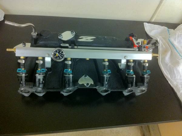

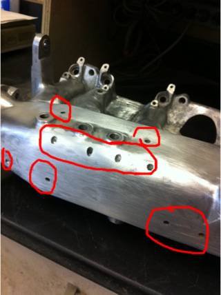

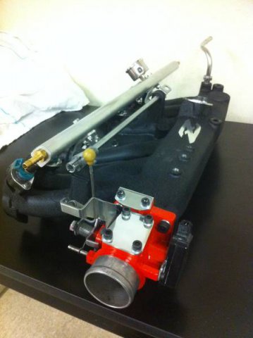

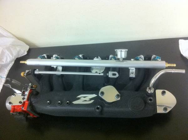

Well I didn't end up going the JB Weld route...just had my machinist bud hook me up with welding the holes shut. My manifold was pretty trashed so he said all the funk that had soaked into the porous cast aluminum was making welding a bit more difficult, but we got it done up nice and ground down all flush . I hope these pics are okay, they looked decent in the preview... You know what the manifold looks like already...here's what happened when I abandoned ship after trying to polish it "as is" These were some of the holes I needed filled. All kinds of sanding, smoothing, drilling, tapping some holes, and all kinds of I'm sure unecessary work went into this thing before coating it with some VHT Wrinkle Plus. A couple more shots for you with most everything mounted up and looking all purdy. Those blockoff plates for EGR, AAC, and other stuff I chose not to use (losing compatibilty of some stuff with JWT 450HP upgrade) are just some pretty frikkin' polished aluminum and turned out very nice. Allen head fasteners all around were totally unecessary, but I think they look SWEET! All in all, it's not show quality and it's not completly shaved, but it looks pretty nice and was fairly easy. I just REALLY hope the wrinkle coat holds up (I'm kinda scared cuz of how close it is to the exhaust manifold...) Hope to see a few pics when you're finished with yours Neveragain55.
