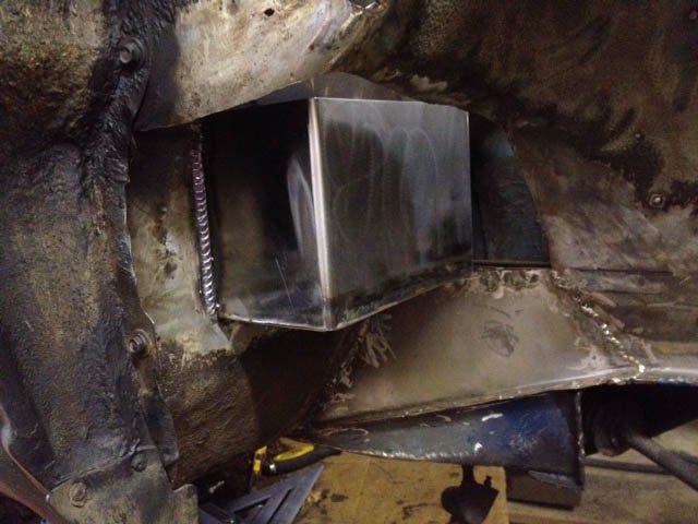

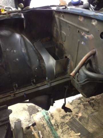

  12. I built my battery box to be a little more than an inch extra space on all sides than the battery, so it would of been too tight. So I'll be welding the wiring loom hole closed from the inside and relocating it the hole right above the frame rail. I could of just put the box lower, to avoid relocating it- but I wanted the wiring in line frame rail since thats the line it'll follow through the engine bay.
  13. Photo update attached. I've welded the box in, (excuse my welds, I burnt through a few spots), and have the surrounding metal about 90% mocked up (a bit extra long in the photo). I'll be using a Deka ETX20L battery, (its a Braille minus the name).

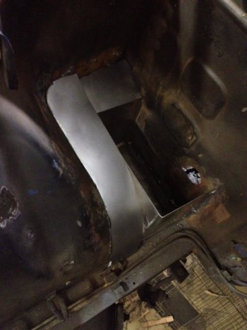

  18. Bought myself a small metal brake yesterday and made a 16gage 8.5 x 4.5 x 6 battery box. Did a rough mock up: Not sure if I'm going to locate it a closer or further from the frame, or leave it where it is, thats a very tight space between the box and frame - I may have a problem with rustproofing in there.
  19. I did some searching. Found only only one mention of a dropped/sunk battery, from RTz (ron?), but all I saw was a finished photo from the top, no sizes or in-process shots. So, since my car is shell with a cut out battery area at the moment I took some measurements at lunch. A full sized battery will probably not fit with wheels at full lock. I measured according to a Braille b2015 // Deka EXT20L battery (what I'll be running) which roughly 7x4x6ish. These are real rough numbers: At 7.5 inches in from the frame and 4 inches from the firewall, there is roughly 3 inches of clearance from the wheels. So you probably dont want a box bigger than 5 inches from the firewall. Took this shot while I was at it, appears a bit deceiving but its roughly 3 inches from the edge of the tape measure to the wheel.
