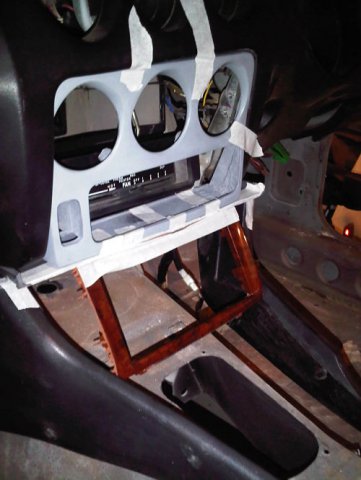

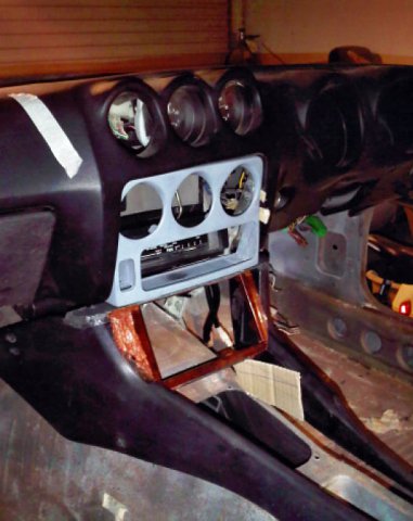

Ahhhhhhhhhhh the madness continues. Had to give some thought as to how to mount the new fascia and also how the console fascia and shifter garnish would be treated as far as trimming, then came to the realisation that it wouldn't work as I had it, so got the cutting disc and chopped the previously mounted and welded lower 2DIN surround out and mounted and welded it to the fascia, this will now help with the mounting and mean that I will now have a 1 piece fascia which curves down into the console where it will meet the shifter garnish, the idea now is to have the console and dash dressed in stitched suede and the new combined fascia and shifter garnish finished in a low bake gloss black, I'm thinking GM's Panther Mica black. Cheers John -

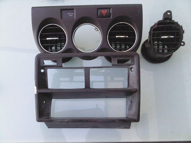

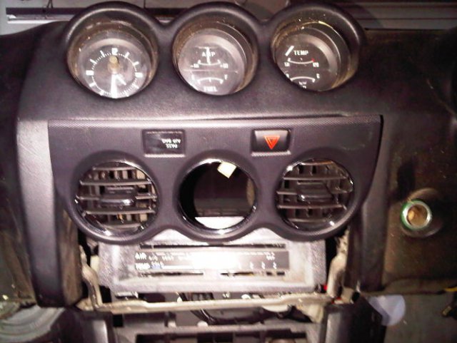

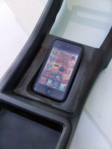

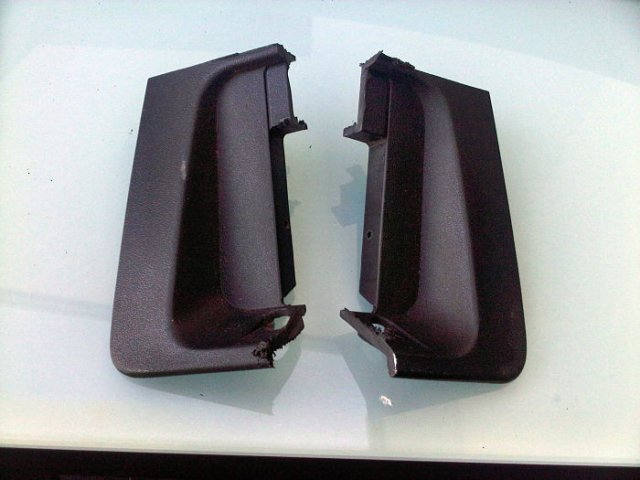

Well since you put it so nicely LOL Had some plastic trim pieces laying about from an Australian Ford Falcon.............. After some brainstorming and dissecting in my head they got the chop and weld treatment and now have an Ipod / Iphone dock cradle,I hope to find a set of SC400 Lexus power window switches to mount ahead of the dock and between them and the shifter will be the engine start button. Cheers John -

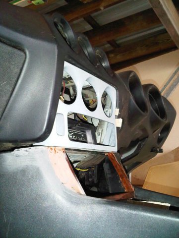

Just an update, prelimanary weld and alignment of the 2DIN fascia in its final position now set and sitting nicely, the center console is around (50mm) 2" wider now and positioned back about (25mm) 1" away from its normal forward position to create better alignment to the dash. Will finish welding and shaping then alter the lower dash points so as they meet flush with the console giving it a flow effect into the center console. Cheers John -

Thanks Buddy, As I have explained to the boy's in Australia, the idea is to create a Hybrid that would be an interpretation of what I would think an S30 factory retro might be if it was done today just like some of the crop of modern factory cars currently enjoying the retro treatment. The entire dash, and console will be done in stitched suede so I'm hoping for a nice tight flush finish to those area's. Cheers John -

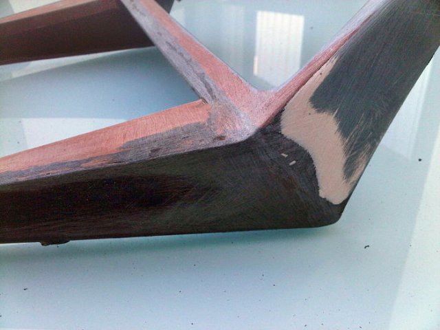

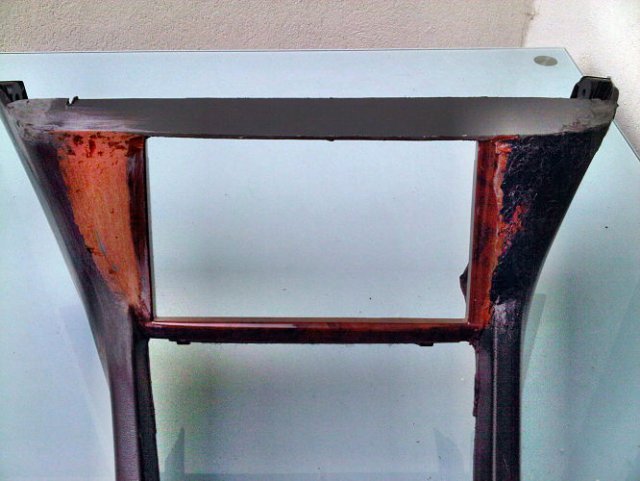

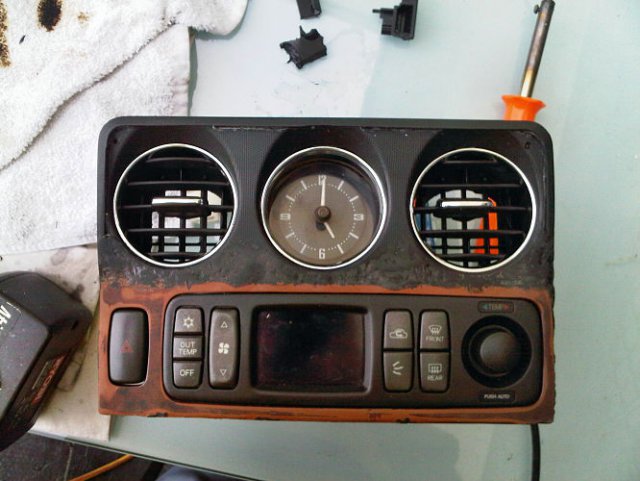

Second prime and rub back completed and now trial fitting and sectioning the center console to fit the 2DIN fascia. Idea will be to blend and extend the dash finishing points so they match the new center vent CC control fascia, then do the same with the center console meeting these surfaces so as to create a flush seam finish between the 3 surfaces. Cheers John -
Sirpents 260Z / C32 AMG Powered RS30 - Australia
Sirpent replied to Sirpent's topic in S30 Series - 240z, 260z, 280z

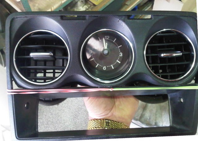

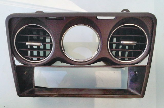

Fascia almost done now, Finished plastic welding, primed and sanded it back for the first time, another few coats of plastic primer surfacer wet and dry rub back and should be ready for assy. Next is modifying the floor console to match up to the bottom of this fascia and incorporate the 7" 2DIN unit. Cheers John -

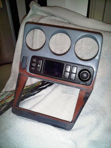

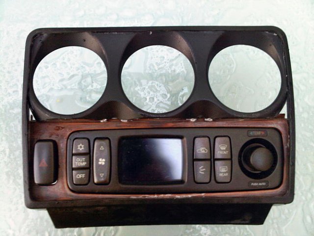

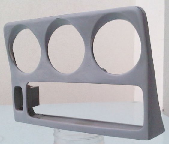

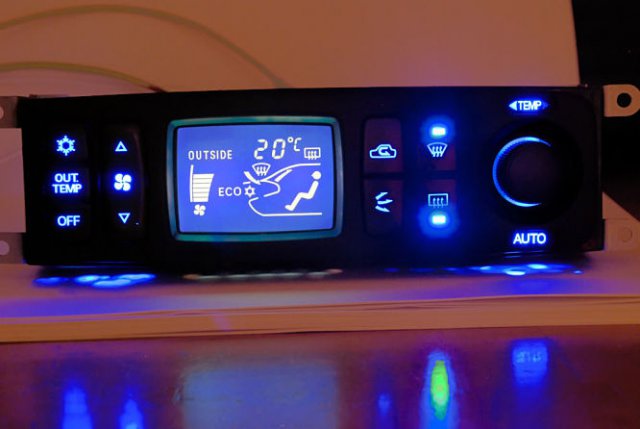

Climate control is proceeding really well, have completed the blending of the Ativa, Diamante and S30 fascia's into one sigle piece all plastic welded and no awaiting some surface filling before plastic priming. The wiring was like working with spahgetti, the step motors and CC only came with about 10cm's (5") of cut loom at each connector so this meant fabricating a new one almost from scratch, problem is that there are a number of shared impulse pathways and a total of 8 components to make the system automated, 3 step motors, a sun sensor, water Temp sensor, air intake temp sensor, outside air temp sensor and then the relays for the blower etc. Luckily I tracked down a copy of the wiring diagram but its like reading hieroglyphics so much of Saturday night was spent simplifying it and working out how to blend it all together, Sunday the soldering work started and was able to bench test it and post a vid of it operating, in case anyone else ever wants to do this I will post a PDF of a step by step wiring diagram I have been doing as I progress. Just to let everyone know also, if there is anyone out there who wants air con in their car, but cant track down all the bits, you don't need to if you decide to do this mod, simply put there are only 3 components you need to install air in a Zed as far as under the dash hardware and non of them need to be genuine. #1 The in dash evaporator (it a simple alloy unit pretty much available from a number of modern cars) #2 A controller such as the one I'm doing. #3 The in dash evaporator casing, this is just a plastic casing square in nature that bolts up to the generic Z system installed in all zeds, it can easily be fabricated from aluminium. I'm more than happy to do a drawing with measurement of it as I will be dropping mine out in the next few days to line up the ducts. In the engine bay it just the simple bolt on hardware, beats paying a $1500+ for an aftermarket unit or trying to reserect a 30+ year old original. Anyhow, a pic of the fascia and a vid of the bench test of the CC Cheers John -

Just an update on the fascia climate control mod. Roughed this up and am pleased with the overall layout, will now roll it over and start plastic welding it before staring to fill and contour the final fascia. Cheers John -

Hi Ron My research and what I have planned will make this a simple conversion, basically everything forward of the Air con condensor housing is trashed, and 3 acuators replace the vacumm and cable controls. The amount of space this affords is enormous as the unit is only around 125mm or 5"inches deep, this particular unit is plug and play stand alone and dosent require interaction with other systems, the hardest part is mounting the step motors correctly. I will be writing a tutorial for the Australian forum boys and will be happy to post an abridged version here along with the final hybrid wiring diagram if there is interest. Cheers John -

Been a few weeks and still waiting for the motor to arrive, so in the meanwhile been tinkering with components and decided to do a bit of an upgrade on the climate system as I didnt think the 30+ year old vacumm system in the aircon assy i had refurbished would stand the test of time. So did some investigation and came up with a few idea's, 1 to upgrade to a full climate control system incorporating stepper motors and also revise the blower ducting and vent facia's to something with a bit more guts and asphetically more pleasing. Did the blower upgrade using a local GM part out of a VT-VZ series Commodore, in US speak that would be a Lumina sedan, the increase in blower rating took it from the original 160W factory blower to 280W and the result is incredidable even though there was a fair amount of modification to the blower enclosure, all worth while though. Check out the links http://www.youtube.com/watch?v=8IvZP9s-x4Y http://www.youtube.com/watch?v=mPXOKIF3MH0&feature=channel_video_title After that I purchased a Mitsubishi Diamante / EVO5 climatre controller, along with a Nissan Activa vent fascia out of California, these arrived a day ago and I started the remodelling of the Zed fascia, see pics attached. Im looking at using the center vent pod as the location for the factory clock and using the center dash pod location for a speedhut Boost guage. Cheers John -

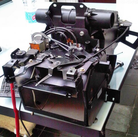

Thanks for the remark venomous, Think it will be a tough build and hopefully as tough a ride in the final outcome. While waiting for the motor to arrive, decided to start refurbishing other components of the "Z" first off the aircon unti which I salvaged from a 2+2 with factory air that was being paretd out. Most of the galved brackets and leavers were rusting so these along with the main chassis were taken back to bare metal and re-enamled -
