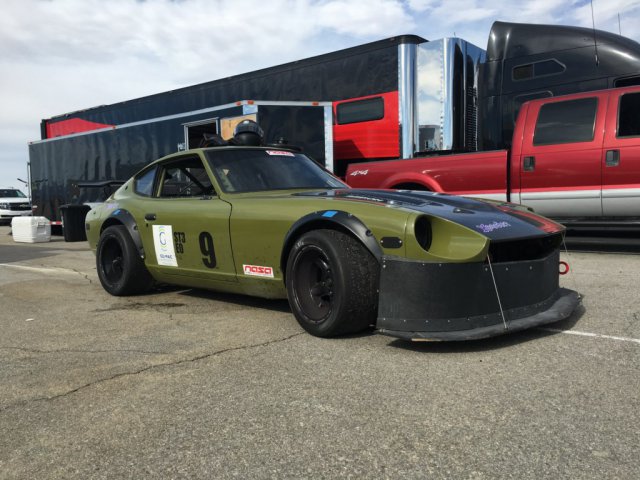

  1. Hah well see the dam thing makes my target 240whp at something like 4500rpm! In our racing class we are defined by a simple formula of Weight / Horsepower (average). I want to be in the class with 10lbs / hp and with a 2400lb car I need to average 240hp. NASA St3. Most cars have a relatively peaky power band, making lets say 200hp at 4500, 235 and 5500, 260hp at 6500 and 235 at 7500 (imagine for grins this averages to 240hp). But if you have another identical car that makes 240hp at 4500 and at 5500 and at 6500 and at 7500 you are maximizing the "Power under the curve" and all the guys that do this are just plain faster (not only for reasons just related to hp of course, but the idea stands). And so that is where the desire for a giant engine with a de-rated power band comes from. Just this year they made a new rule to address the advantages of this type of setup so therefore it must be a competitive advantage lol. Tj
  2. Steering is a little stiff in the paddock but not too bad. I've considered installing the electric assist rack... Maybe this summer. Yes stock engine with Osiris for tuning and intake / exhaust. All the accessories are removed as well of course. We topped out at 314whp and 276 Tq I think. Next goal is to get the e-throttle control to work so we can reduce power for classing reasons to 240whp. 17x9 have more tire choices and ground clearance

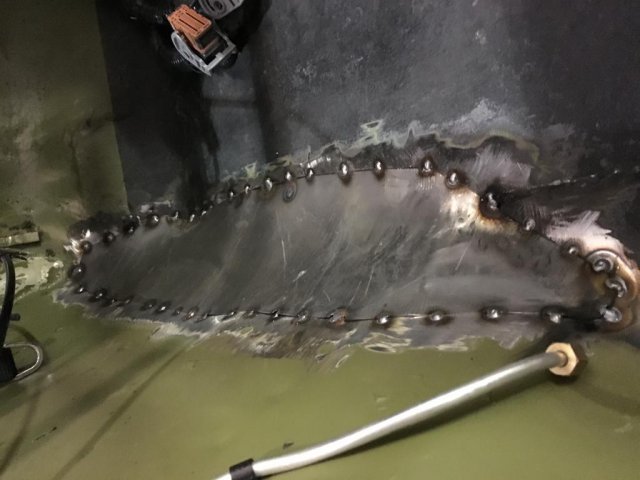

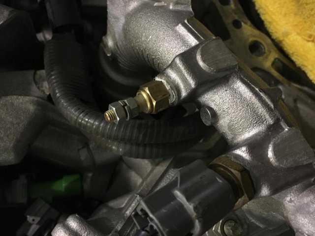

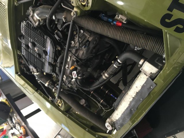

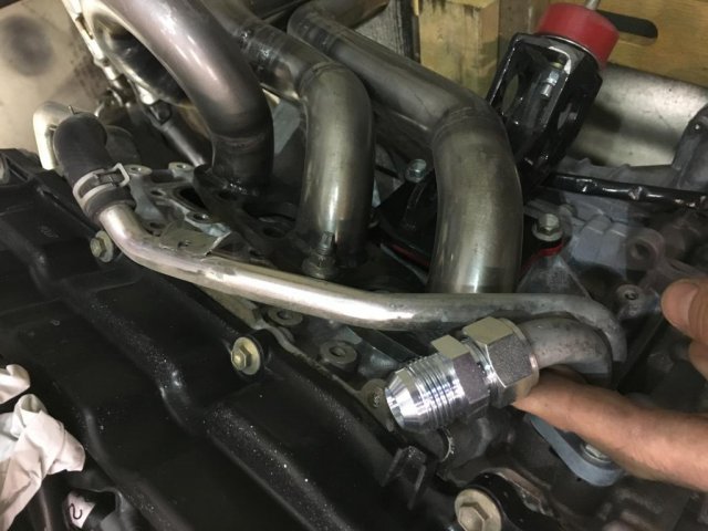

  13. Well let's see... Chassis welding done to give more room for headers and front cross member for oil pan. Some brake lines moved and heat wrapped to shield from the headers. Closed off the last of the water passages and mounted a 2nd H20 temp sensor. Should have motor back in this weekend and get to drive. Exhaust fab is Tuesday and Dyno tuning at UMSTuning is Wednesday. Then compliance Dyno Saturday. I will be on track at Chuckwalla exactly 2 weeks from today. Brought in a ringer for welding one fitting shut. Removed fitting, tapped and installed CTS-2

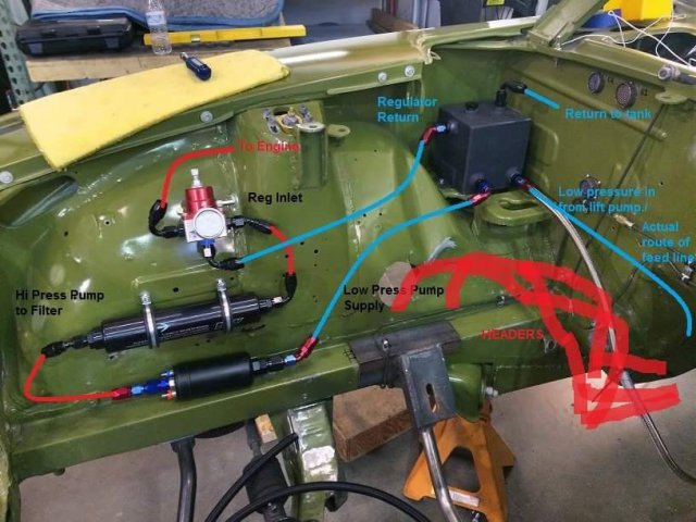

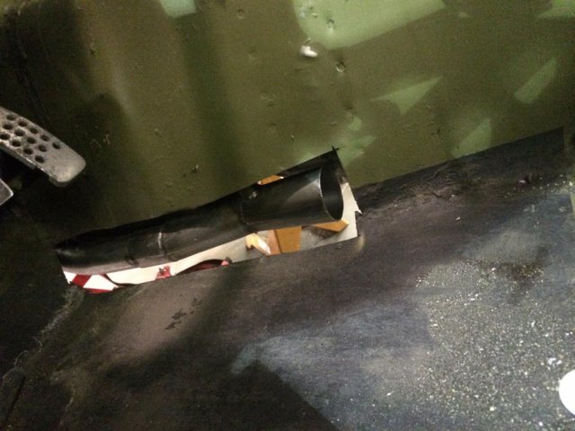

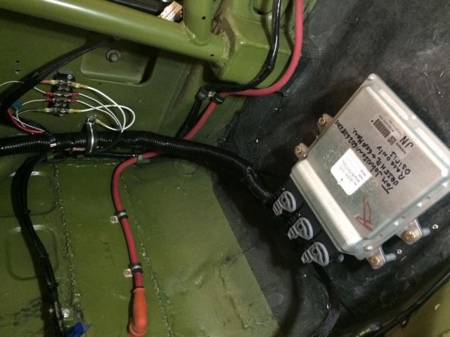

  16. Decided I just needed a bit more room for the McKinney long tube headers. Fuel system planned out. ECU mounted and its sub-harness installed Reconfigured panel to provide power to ECU and 2nd fuel pump Mmmmm

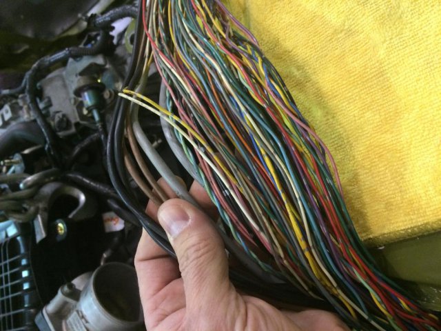

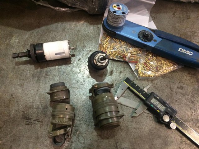

  17. 4 hour marathon game of "pins and sockets" and got the harness terminated and tested into the MS connectors. Still need to mount the bulkheads and pass a few more wires back and forth (cruise control switches retained for tune switch but need to be under the hood). Then will finish the remaining wiring for Powers and Grounds, new fuel pump relay for the AEM 380LPH, few other bits and then finish the fuel system. Waiting for header to come back from McKinney with and adjustment. Finalize engine position and get the welding and repainting done..

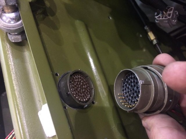

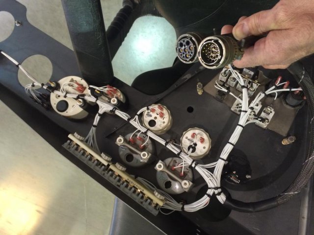

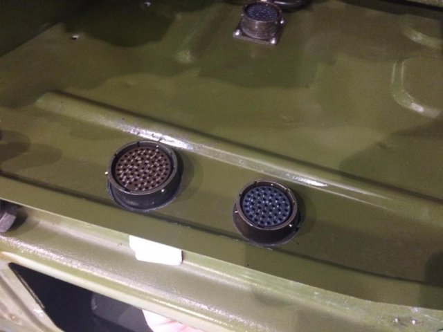

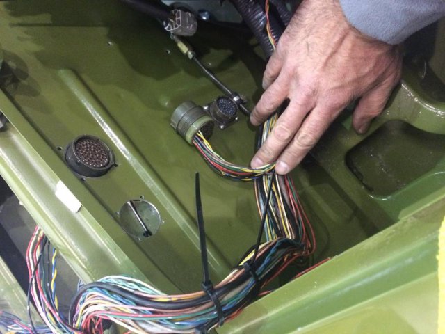

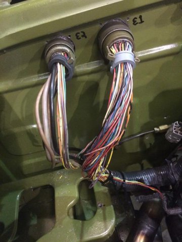

  18. Computer was fine (power was from a little charger), header adjustment almost done (Thanks McKinney Motorsports!) Decided to pass the harness (87-ish wires) through the firewall to the cockpit with 2 MilSpec disconnects. Using a 61 pin and a 41pin will give me plenty of spare holes.

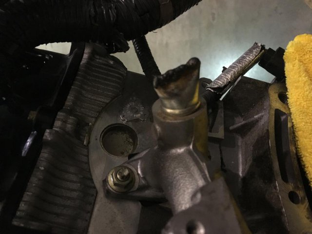

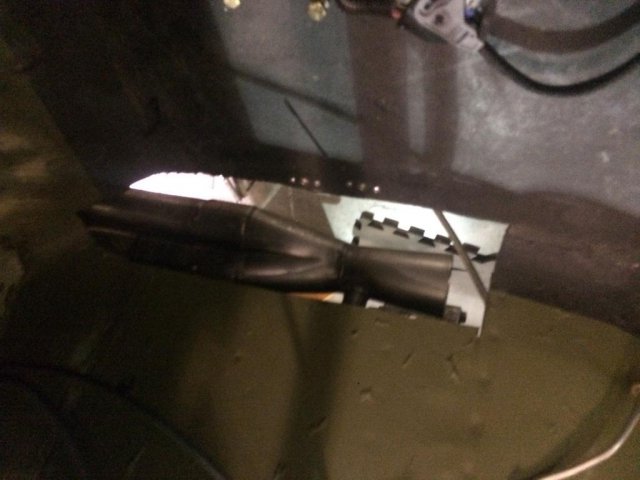

  20. Drivers side header shipped back to McKinney to tweak the #6 tube for better firewall clearance and to update the production jig. Impulsively I chose to power up the computer to check a few sensors and had wires crossed. Doh! Likely fried computer, shipped back for testing. Have a swirl pot enroute which will be fed via a lift pump in the rear and then filter, AEM 380lph and filter into the VQ. Slowly making progress

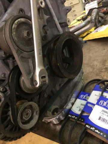

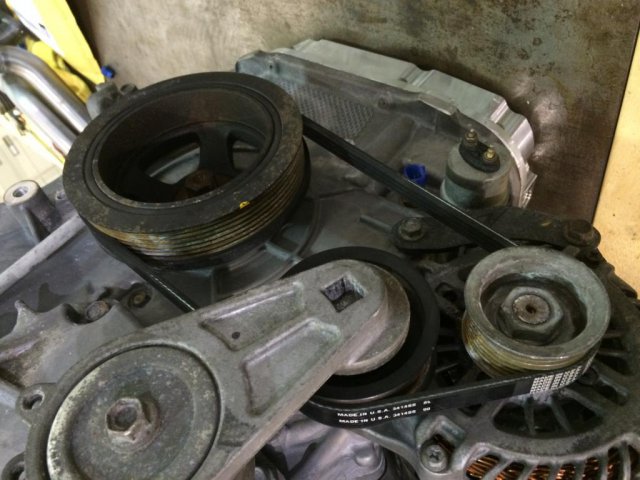

  21. 310 belt in K series does the trick Soon

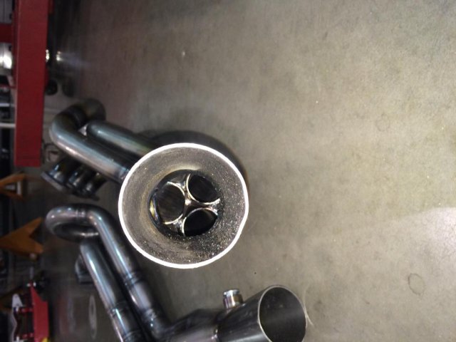

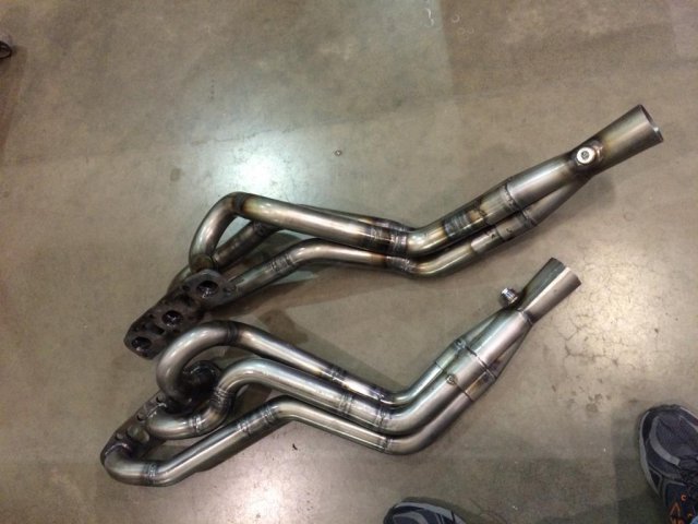

  22. Big thanks to Mack at McKinney Motorsports for getting the custom headers to me. They look WAY better than I anticipated. I pretty much now have all the physical parts to do the final mockup then weld down the mounts, close up the X-member and finish wiring and plumbing. But Christmas... So probably running some time in January and on track in Q1 of 2016. Headers.. Then an X pipe and single 3"? Not sure what to do yet. Since I will be taking a 300whp motor and detuning to 245whp the design of exhaust just needs to be light.
