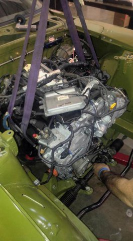

  3. Sounds like we are in a similar spot. I am doing a 35HR swap and just posted some pics this morning. I am shit-canning all those vacuum and extra water lines. Capping off for now, but I will build a spare engine and weld shut what I don't need. I think my harness may bave been done by same people. 4 wires with tape on them? I've done a lot of aircraft wiring before and down the road I will probably rebuild a spare harness also using this as a template. Did Mack send you spacers for the mounts? I have one on each side now.

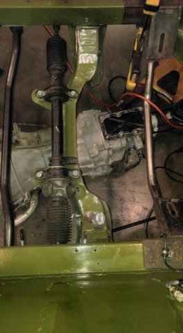

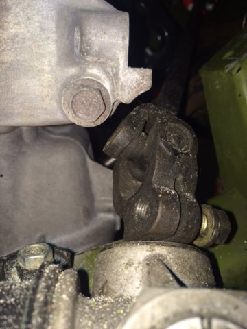

  4. Pretty deep into my VQ35HR swap into my 240Z track car. 1973 240Z, race only, VQ35HR with trimmed harness and Orisis already installed, so I just have the engine computer, FBW pedal and no other boxes. Using the McKinney mounts. Some questions / comments: I've trimmed the front cross member and original mount pedestals. I am using spacers provided by McKinney also. I have the motor about as far forward as I can get it to leave plenty of room at the firewall. There is really only about 1/2" forward or back it could possibly go? The spacers effectively move the motor mounts in and out from the engine and thereby tend to raise / lower the engine. I have one spacer on each side and only about 3/8' clearance from alternator to frame rail and 1/4" clearance from the steering rack u-joint to the lower pan. The steering shaft just touches the mount so I will trim that mount a bit. Guess that's about where it will end up? I have stand-alone gauges for oil and water temp and pressure, guessing I will need to add additional sensors to the motor and just let the stock sensors feed data to the ECU which I suppose it will want regardless? Answered below. Turbo-Toys supplied the trimmed harness from a vendor in Florida and it has 4 exposed wires: +12v, Ground, Fuel Pump and Starter. I guess I need to figure out what the "Starter" and "Fuel Pump" wires do? One is trigger to starter and the fuel pump is output for the pump? or a signal to the pump relay? Answered below I'll try to get some pics up today. Tj

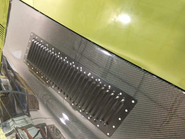

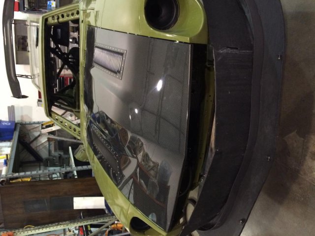

  9. Let's try this again. Leaving for NASA West Coast Nationals at Laguna Seca on about an hour. Day and night project. One of the bigger projects I've done.

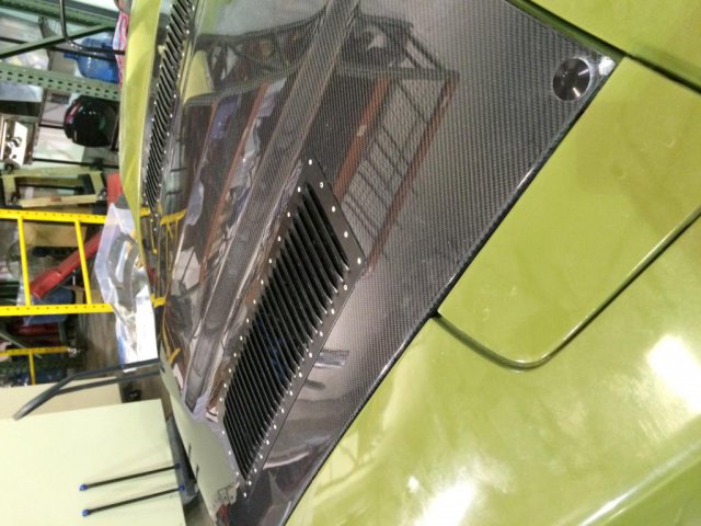

  10. Run Cool Louvees on a new Seibon CF hood (19lbs)

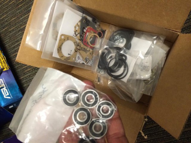

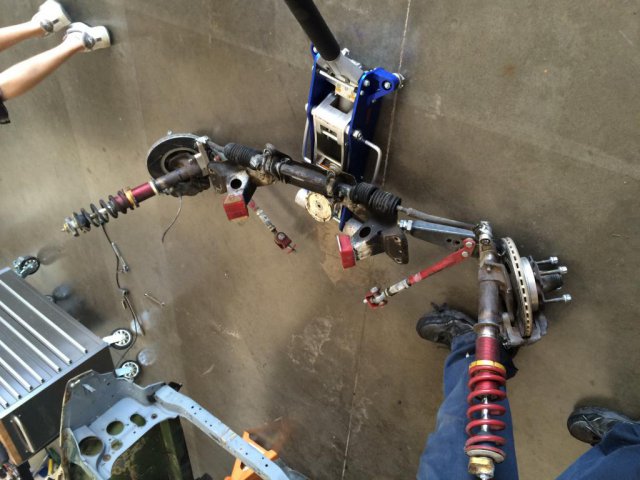

  14. Resurrecting:... I'm rebuilding my rack with new "Delrin" bushings from TTT. This is ok to delete? I suppose It isn't doing any harm but it does add that few extra grams of weight I am looking to delete...

  16. Finally get to rebuild my steering rack too. Weld cross member?

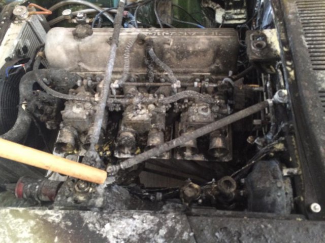

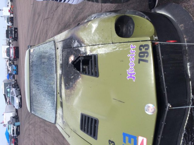

  17. Update: all fire systems did in fact work correctly but the fire was just too well developed being fed by the melting brake reservoirs. But the foam and Halon certainly slowed it down until the big bottle of ABC showed up. I hate that stuff but gee it really works. Truth is I was ready to refresh the motor and paint the front clip so this is all good stuff.
  18. The engine cuts out a little right as the video starts. There were no black flags although people saw the fire including my buddy on my ass in his M3. Then the motor cut out more and I saw flames. ~sigh~
  19. Helmet blower hose was the problem. In the confusion I started going for my HANS. 3 fire systems: 5 lb Halon did not seem to slow the fire at all (first bottle I pulled on right) 5 lb Aqueous Foam failed to trigger properly (I pulled on far left by door). Need to determine why. 1.3lb handheld Halon was also ineffective. But by this time I think we had brake fluid involved and damage was done.
  20. I don't know what started. Appears to me to be low, left and aft. Area of header collector. Gonna try to determine that prior to moving on. Everyone wants to blame fuel and carbs but I am not so sure. Brake reservoirs went at some point also Feeding fire. Started cutting out half-lap prior. https://youtu.be/JwXYZ2hMwIc
