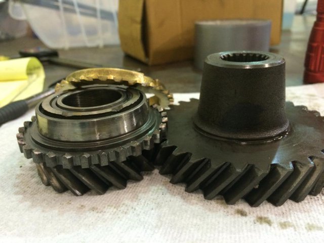

and done! A 19/31 overdrive for .78 in a 1983 FS5w71b with brass Warner synchro Like to think that this isn't too common, maybe I'm the first?
Back into my tranny for a few items: 2nd still grindeded a little Reverse got mangled in the heat of battle. Want a shorter 5th. On inspection also found the 4th gear brass ring cracked yet it shifted perfectly. No about that 5th... By installing the earlier tranny I can get a .78 OD instead of .745 which will help. But.... The earlier trannies use older style syncros. I found that I could press off the gear and I think I can adapt the Warner syncro to the older gears. So.. Wish me luck!
