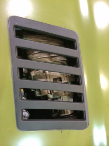

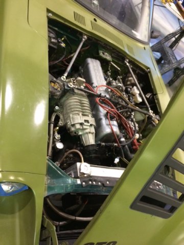

  8. Ahh I see it now. Been reading the various pros / cons about where to put the throttle plate. I mocked up my blower in the car with my old motor just for the heck of it. Looks SWEET...
  9. What did you do for the outlet? Did you adapt or make something?

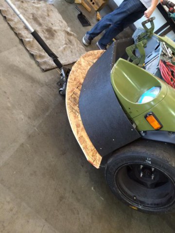

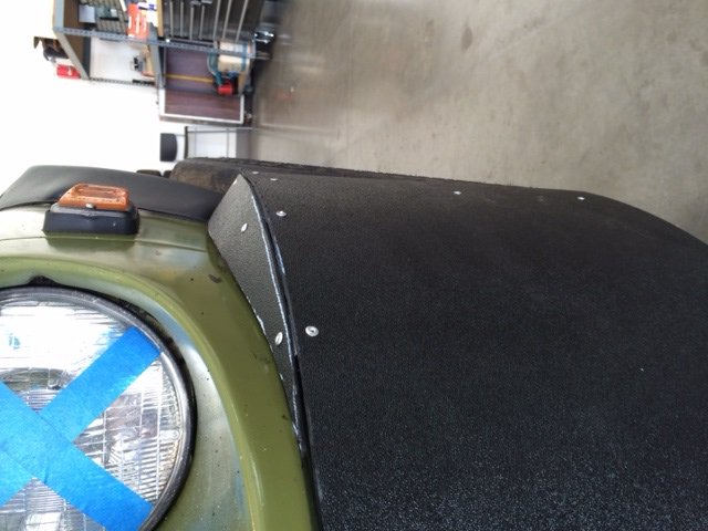

  14. Mostly finished the new Airdam this weekend and kicked it out wider to cover the tires and may look at some off the shelf "dive planes" also. For all the radiuses in the ABS you see here it requires no thermo forming. The inlet ducting did need heat and I just used a few heat guns to get it just pliable. Pretty amazing stuff. While I am serious about car and the progress and the modifications... we are also having fun. The Splitter is still under review, although I really like the idea of finishing closing up the inlet ducting. Splitter mounting scheme is looking good... 2 horizontal male / female pins in the back by the steering rack, the splitter just slides into those, then lift up and 2 more vertical m/f pins receive the front of the splitter and take cross pins or cotter pins to secure. Then the stay-rods in front which are still under review by the committee... (burp)
  15. The Airdam is that .125" ABS I think. Molds under heat, flexes nicely but ultimately cracks when abused. No intention of measuring the splitter in any scientific way. I may not even run it for a while. But mocking it up anyway. I break a lot of stuff and if I go off track and snowplow through gravel it would be ugly.
  16. Had to replace damaged air dam and we mocked up a splitter also. Looks mean....

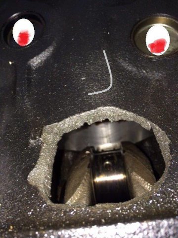

  19. /\ All the other bearings looked perfect, I suspect an assembly problem. But Rebello is going to inspect and render a verdict - no doubt I caused it somehow. Bearing failed, Bolts followed, Rod departed crank. Going back to my original green motor and maybe drop some weight and run true slicks to stay in the hunt.
  20. When the Rebello motor threw a rod on Sunday it cracked the oil pan in a few places. I have the Arizona Zcar oil pan and I reached out to Dave at Arizona Z Car (http://www.arizonazcar.com/) for a new baffle cover and he offered to replace it at no cost. I certainly didn't expect that. Dave is a good and fair businessman. The cast aluminum pan itself will be repaired and live on..
