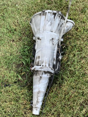

Well I just picked up a extra 3n71b , and found a local guy who had his converter built for it and I am going that route. Ya it’s hard to find that list I have been looking!

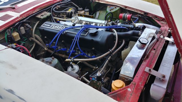

Wow it’s been a while, but here is a quick update on the 260. My my dad is currently in position and has been for a year now and loves the car. There is the current set up. Engine: L28et- stock oil pan to cam Ported 76 intake ceramic coated Custom heat shield intake/turbo Thermal Zero turbo blanket Thermal Zero aluminized heat wrap on all intercooler, and intake piping Weber throttle body Palnet fuel rail 440cc injectors EBay FMIC Turbosmart BOV Turbosmart internal wastegate AGP T3T4 H-Trim turbo @16.5 psi Inovate SG-1 boost control MSD box, & coil Ngk plugs Taylor 409 wires DW 250 fuel pump Aeromotive FRP 2.5 aero exhaust Champion 3 row radiator Dearell 16 row trans cooler Nistune ecu Great tune by simtecmotorsports Still rocking the Auto trans Interior: All carpet & sound deadening striped 350Z seats NRG steering wheel Boss hub NRG 4 point harness T3 C pillar brace Auto meter boost,water temp, oil pressure gauges Innovate SCG1 boost control MAX tow fuel pressure gauge Suspension: Enegery suspension poly bushing kit KYB 5 way shocked KYB lowering springs ST sway bars MSA strut bars Wheels & Tires Panasport 15x7 wheels with Zero offers Kumho 225/50/15 tires

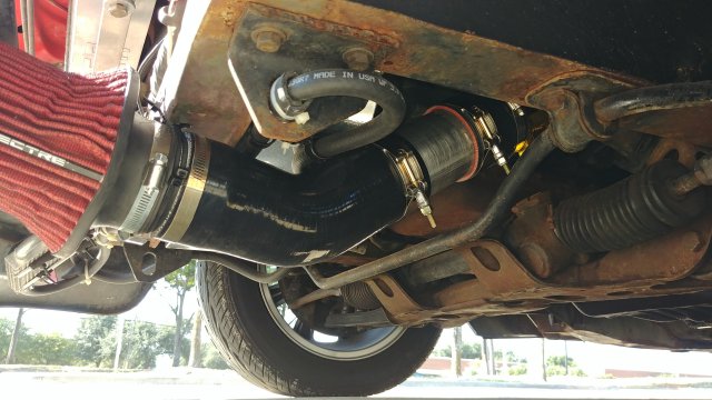

Update. Still not running great. Car has no curve to adjust stock 84ecu . Car has 2 o2 sensors. a stock narrow band for the ECU, And a wide band installed for tuning. The narrow narrow band os located i the stock L28et position 10ish inches post turbo. With the wbo2 mounted 26" post turbo. Pulled ecu codes nothing wrong there No exhaust leaks at all on the car. I gave it some more timing now set at 30° seams to like it more. Still having the same issue once the car is warmed up blip the throttle and it stumbles. Tested MAF per fsm passed Maf is located 12" per turbo inlet , And filter is 18" per MAF Car is still lean at idle even with fuel pressure bumped up to 30 psi at idle . No idea on that one. Pulled pre pump fliter not clogged doing its job catching all the lil junk out of the tank. Verfied injector to ecu compatibility. Could bad gas cause this to happen?

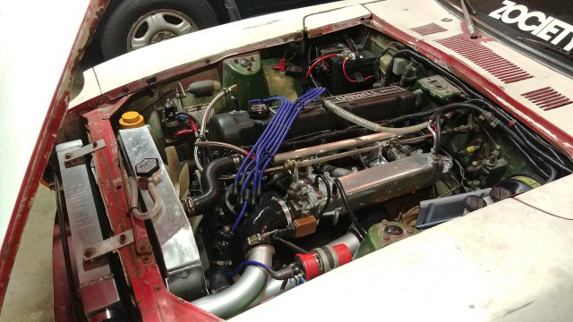

Hello my good Zfamily: My et swapped 260z has been running well up to this last weekend. I changed the radiator, thermostat, fan belt, and wrapped the downpip, and now it's running very lean under load. I did remove the fmic to install the radiator but have checked all the clamps and joints for leaks. It starts getting lean as soon as the vac starts to switch in to boost, and if you give it more throttle it goes very lean 19-21 on my gauge. Now when your just cruising it seams to be ok 14.3-15. Has any one had these issues. I have tested the afm,tps,and chts via the fsm. Thanks for any help.

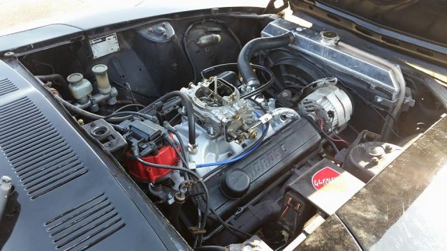

I will do that, this is my other Z SBC 280z but it is getting the motor pulled due to a knock and might be getting a LS.

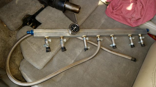

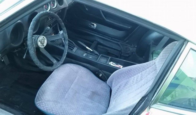

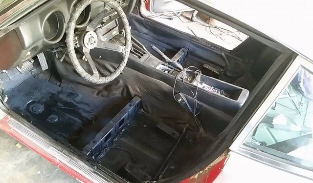

Had another great weekend with the car, had a OKZCC Z car show this weekend in Tulsa Oklahoma and I took home 1st place in 240/260Z. So many beautiful 280Z in the area they have there own category. Only bad thing from the weekend was my driver seat back broke as i was leaving the car show so after getting home I ripped out the seats found some more rust spots, laid down some rust kill paint and ten some flat black, and swapped the passenger seat to the driver side for now.. I also snagged this beautiful fuel rail from a friend who is selling off all his Z stuff. He also paid it forward big time to a young Zcar guy who loves his Z but it has some major rust issues so he gave him rust free 280z rollers. I love the Z car community a bunch of good guys.

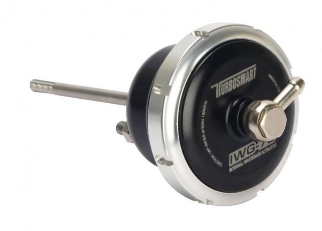

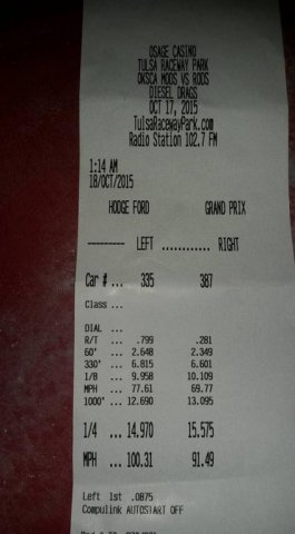

Got some of my parts on order, Have any of you run a aftermarket wastegate on you stock turbo? I also ordered a now BOV.. And here are a few vids from the drag strip on Saturday night I figured the car was running better then it ever has why not take it out and see how much it has improved scene I picked it up. Best Pass: Me vs my friends 350Z .. we had the same trap speed yet he was a sec faster. Cant wait to get my new parts in and see if I can break 100mph and that 10psi wastegate should help.

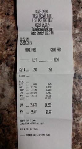

My 7th and final run of the night was my 260z vs my friends 350z //260z 15.678 @95.07// 350z 14.566 @95.98 And now the car is going to stay as is for a bit I am moving to Dallas Tx in a few weeks and am trying to find a place that to put and work on the car. I already have some new parts on order and some in hand, just need the time and space to do the work. will be much faster next track day.
